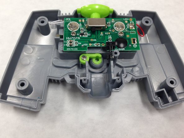

  6. Air Hog Smash Bots Controller Motherboard Replacement, Controller Motherboard: crwdns2935265:06crwdnd2935265:01crwdnd2935265:02crwdne2935265:0 Air Hog Smash Bots Controller Motherboard Replacement, Controller Motherboard: crwdns2935265:06crwdnd2935265:02crwdnd2935265:02crwdne2935265:0
    • Using the PH #0 bit, remove two 8 mm screws on the main board.
    • De-solder the LED wires from the motherboard.
    • Lift the motherboard with a spudger to remove it from the case.
