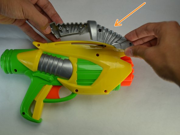

    • Using a Phillips #00 screwdriver, remove the two 11.6 mm screws that hold the grey slider together
    • Remove grey slider from the main body of the blaster.

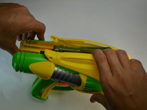

  2. Air Blasters Tek Six Reload Slider Spring Replacement, Remove screws in main body: crwdns2935265:02crwdnd2935265:01crwdnd2935265:03crwdne2935265:0 Air Blasters Tek Six Reload Slider Spring Replacement, Remove screws in main body: crwdns2935265:02crwdnd2935265:02crwdnd2935265:03crwdne2935265:0 Air Blasters Tek Six Reload Slider Spring Replacement, Remove screws in main body: crwdns2935265:02crwdnd2935265:03crwdnd2935265:03crwdne2935265:0
    • Using a Phillips #00 screwdriver, remove the six 9 mm screws that secure the main body.

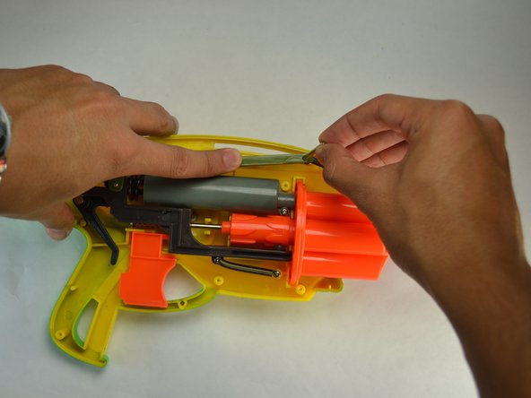

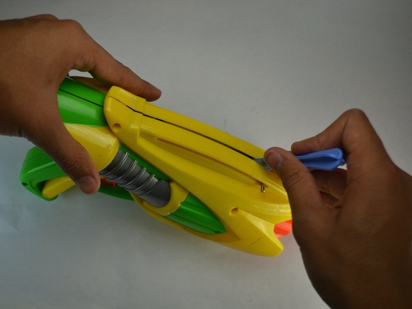

  3. Air Blasters Tek Six Reload Slider Spring Replacement, Take the main body apart: crwdns2935265:03crwdnd2935265:01crwdnd2935265:03crwdne2935265:0 Air Blasters Tek Six Reload Slider Spring Replacement, Take the main body apart: crwdns2935265:03crwdnd2935265:02crwdnd2935265:03crwdne2935265:0 Air Blasters Tek Six Reload Slider Spring Replacement, Take the main body apart: crwdns2935265:03crwdnd2935265:03crwdnd2935265:03crwdne2935265:0
    • Using the plastic opening tools, carefully separate the main case of the blaster to expose the inside.

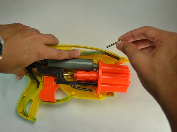

  4. Air Blasters Tek Six Reload Slider Spring Replacement, Remove metal pin: crwdns2935265:04crwdnd2935265:01crwdnd2935265:03crwdne2935265:0 Air Blasters Tek Six Reload Slider Spring Replacement, Remove metal pin: crwdns2935265:04crwdnd2935265:02crwdnd2935265:03crwdne2935265:0 Air Blasters Tek Six Reload Slider Spring Replacement, Remove metal pin: crwdns2935265:04crwdnd2935265:03crwdnd2935265:03crwdne2935265:0
    • Carefully grab the metal pin keeping the air system and top spring, and slide it outwards. This will release the air system with the plunger completely.

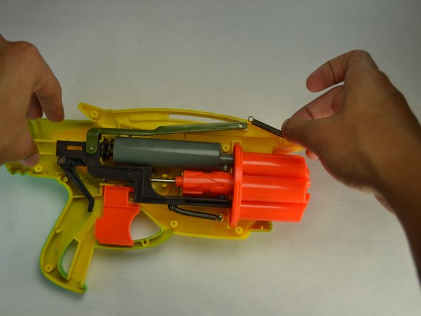

  5. Air Blasters Tek Six Reload Slider Spring Replacement, Remove screw holding the top spring to reload slider: crwdns2935265:05crwdnd2935265:01crwdnd2935265:02crwdne2935265:0 Air Blasters Tek Six Reload Slider Spring Replacement, Remove screw holding the top spring to reload slider: crwdns2935265:05crwdnd2935265:02crwdnd2935265:02crwdne2935265:0
    • Using a Phillips #00 screwdriver, remove the 7.5 mm Phillips #00 screw holding the top spring to the reload slider.
