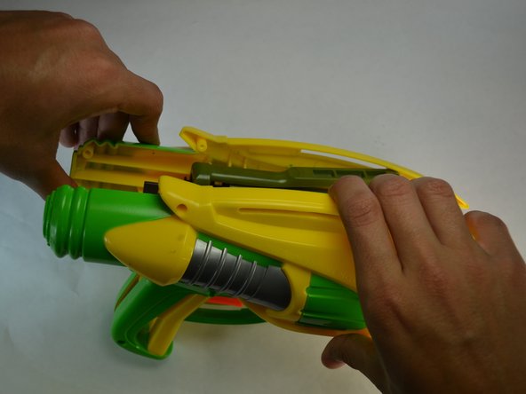

    • Using a screwdriver, remove the two 11.6 mm phillips 00 screws holding the grey slider together.
    • Remove grey slider from the main body of the blaster.
  2. Air Blasters Tek Six Plunger Replacement, Remove screws in main  body: crwdns2935265:02crwdnd2935265:01crwdnd2935265:03crwdne2935265:0 Air Blasters Tek Six Plunger Replacement, Remove screws in main  body: crwdns2935265:02crwdnd2935265:02crwdnd2935265:03crwdne2935265:0 Air Blasters Tek Six Plunger Replacement, Remove screws in main  body: crwdns2935265:02crwdnd2935265:03crwdnd2935265:03crwdne2935265:0
    • Using a screwdriver, remove the six 9 mm phillips 00 screws holding the main body together.

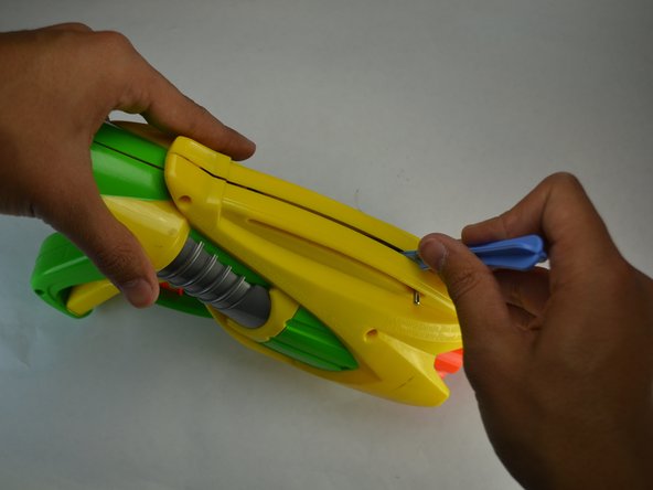

  3. Air Blasters Tek Six Plunger Replacement, Take the main body apart: crwdns2935265:03crwdnd2935265:01crwdnd2935265:03crwdne2935265:0 Air Blasters Tek Six Plunger Replacement, Take the main body apart: crwdns2935265:03crwdnd2935265:02crwdnd2935265:03crwdne2935265:0 Air Blasters Tek Six Plunger Replacement, Take the main body apart: crwdns2935265:03crwdnd2935265:03crwdnd2935265:03crwdne2935265:0
    • Using the plastic opening tools, carefully take apart the main case of the blaster to leave the inside exposed.

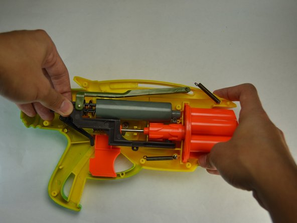

  4. Air Blasters Tek Six Plunger Replacement, Remove screw holding the bottom spring to the air system: crwdns2935265:04crwdnd2935265:01crwdnd2935265:01crwdne2935265:0
    • Using a screwdriver, remove the 7.5 mm phillips 00 screw holding the bottom spring to the air system.

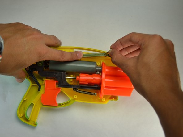

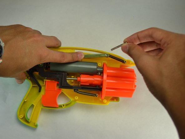

  5. Air Blasters Tek Six Plunger Replacement, Remove metal pin: crwdns2935265:05crwdnd2935265:01crwdnd2935265:03crwdne2935265:0 Air Blasters Tek Six Plunger Replacement, Remove metal pin: crwdns2935265:05crwdnd2935265:02crwdnd2935265:03crwdne2935265:0 Air Blasters Tek Six Plunger Replacement, Remove metal pin: crwdns2935265:05crwdnd2935265:03crwdnd2935265:03crwdne2935265:0
    • Carefully grab the metal pin keeping the air system and top spring stationary, and slide it outwards. This will release the air system with the plunger completely.

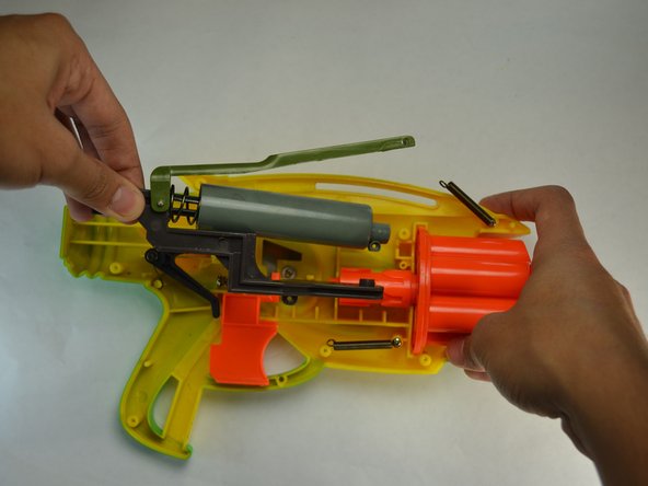

  6. Air Blasters Tek Six Plunger Replacement, Remove air system screw: crwdns2935265:06crwdnd2935265:01crwdnd2935265:01crwdne2935265:0
    • Using a screwdriver, remove the 5.2 mm phillips 00 screw holding the air system to the body of the blaster.
  7. Air Blasters Tek Six Plunger Replacement, Take the air system out: crwdns2935265:07crwdnd2935265:01crwdnd2935265:03crwdne2935265:0 Air Blasters Tek Six Plunger Replacement, Take the air system out: crwdns2935265:07crwdnd2935265:02crwdnd2935265:03crwdne2935265:0 Air Blasters Tek Six Plunger Replacement, Take the air system out: crwdns2935265:07crwdnd2935265:03crwdnd2935265:03crwdne2935265:0
    • Grab the whole air system and carefully take it out of the main body of the blaster.

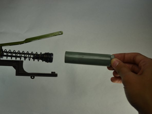

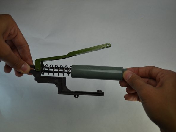

  8. Air Blasters Tek Six Plunger Replacement, Remove plunger: crwdns2935265:08crwdnd2935265:01crwdnd2935265:03crwdne2935265:0 Air Blasters Tek Six Plunger Replacement, Remove plunger: crwdns2935265:08crwdnd2935265:02crwdnd2935265:03crwdne2935265:0 Air Blasters Tek Six Plunger Replacement, Remove plunger: crwdns2935265:08crwdnd2935265:03crwdnd2935265:03crwdne2935265:0
    • Now, grab the gray plunger with your hand and slide it outwards to remove it.
