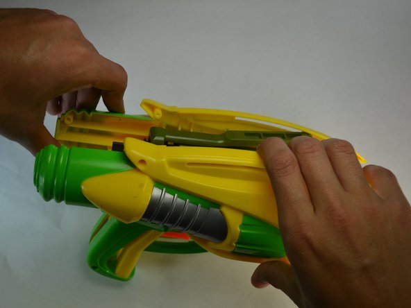

  1. Air Blasters Tek Six Barrel Replacement, Remove screws of the grey slider: crwdns2935265:01crwdnd2935265:01crwdnd2935265:03crwdne2935265:0 Air Blasters Tek Six Barrel Replacement, Remove screws of the grey slider: crwdns2935265:01crwdnd2935265:02crwdnd2935265:03crwdne2935265:0 Air Blasters Tek Six Barrel Replacement, Remove screws of the grey slider: crwdns2935265:01crwdnd2935265:03crwdnd2935265:03crwdne2935265:0
    • Using a screwdriver, remove the two 11.6 mm phillips 00 screws holding the grey slider together.
    • Remove grey slider from the main body of the blaster.

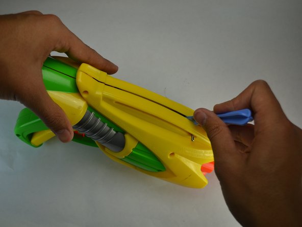

  3. Air Blasters Tek Six Barrel Replacement, Take the main body apart: crwdns2935265:03crwdnd2935265:01crwdnd2935265:03crwdne2935265:0 Air Blasters Tek Six Barrel Replacement, Take the main body apart: crwdns2935265:03crwdnd2935265:02crwdnd2935265:03crwdne2935265:0 Air Blasters Tek Six Barrel Replacement, Take the main body apart: crwdns2935265:03crwdnd2935265:03crwdnd2935265:03crwdne2935265:0
    • Using the plastic opening tools, carefully take apart the main case of the blaster to leave the inside exposed.

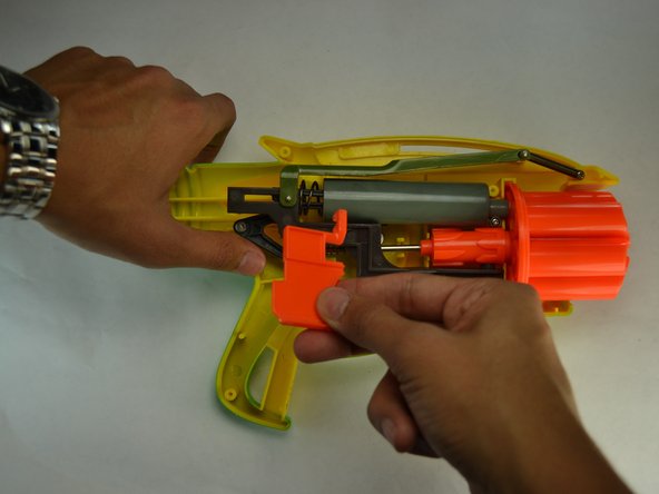

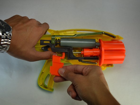

  4. Air Blasters Tek Six Barrel Replacement, Remove the trigger: crwdns2935265:04crwdnd2935265:01crwdnd2935265:03crwdne2935265:0 Air Blasters Tek Six Barrel Replacement, Remove the trigger: crwdns2935265:04crwdnd2935265:02crwdnd2935265:03crwdne2935265:0 Air Blasters Tek Six Barrel Replacement, Remove the trigger: crwdns2935265:04crwdnd2935265:03crwdnd2935265:03crwdne2935265:0
    • Remove the trigger, lifting from the bottom and pulling it out from under the metal pin.

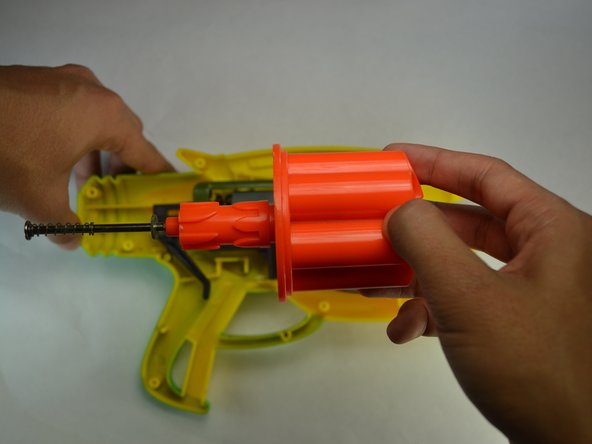

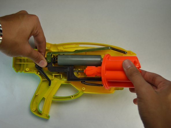

  5. Air Blasters Tek Six Barrel Replacement, Removing the barrel: crwdns2935265:05crwdnd2935265:01crwdnd2935265:03crwdne2935265:0 Air Blasters Tek Six Barrel Replacement, Removing the barrel: crwdns2935265:05crwdnd2935265:02crwdnd2935265:03crwdne2935265:0 Air Blasters Tek Six Barrel Replacement, Removing the barrel: crwdns2935265:05crwdnd2935265:03crwdnd2935265:03crwdne2935265:0
    • Lift the barrel, pulling it out from under the black trigger catch

I don't remember this blaster's shell as being held closed by solvent weld or catches - why is the "iFixit" pry-tool necessary?
Arasin Staubly - crwdns2934203:0crwdne2934203:0
