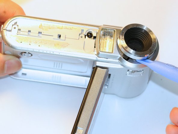

    • Pull the body apart from the bottom of device just enough to make space to remove the silver plastic strap holder.
    • Use tweezers to remove the silver plastic strap holder.
    • Use a plastic opening tool to pry off the lens protector.

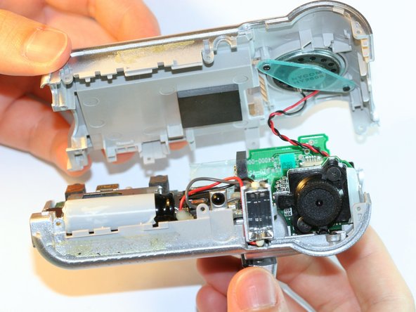

  11. Aiptek DZO-V58N Speaker Replacement, Speaker: crwdns2935265:011crwdnd2935265:01crwdnd2935265:03crwdne2935265:0 Aiptek DZO-V58N Speaker Replacement, Speaker: crwdns2935265:011crwdnd2935265:02crwdnd2935265:03crwdne2935265:0 Aiptek DZO-V58N Speaker Replacement, Speaker: crwdns2935265:011crwdnd2935265:03crwdnd2935265:03crwdne2935265:0
    • Unscrew the two silver 0.5cm machine screws with the #00 Phillips screwdriver.
    • Lift off the lens protector housing.
    • Pull apart the two halves of the camera body.
    • Do not pull the two halves apart too far because the wires may detach.
  12. Aiptek DZO-V58N Speaker Replacement: crwdns2935265:012crwdnd2935265:01crwdnd2935265:01crwdne2935265:0
    • Use the #00 Phillips screwdriver to unscrew the two black speaker screws.
    • Lift off plastic cover.
  13. Aiptek DZO-V58N Speaker Replacement: crwdns2935265:013crwdnd2935265:01crwdnd2935265:01crwdne2935265:0
    • Unplug the speaker from the circuit board by pulling out the white plastic connector.
    • Make sure to pull plastic connector and not wires because the wires could be damaged.
    • Lift out the speaker.
