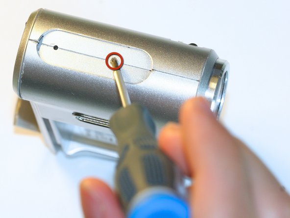

    • Open the USB cover to expose the small machine screw.
    • Use the Phillips #00 screwdriver to unscrew the six 0.5cm machine case screws (distributed around the camera body).
    • These small screws are easy to lose. Place the removed screws in an organized container to avoid losing them.

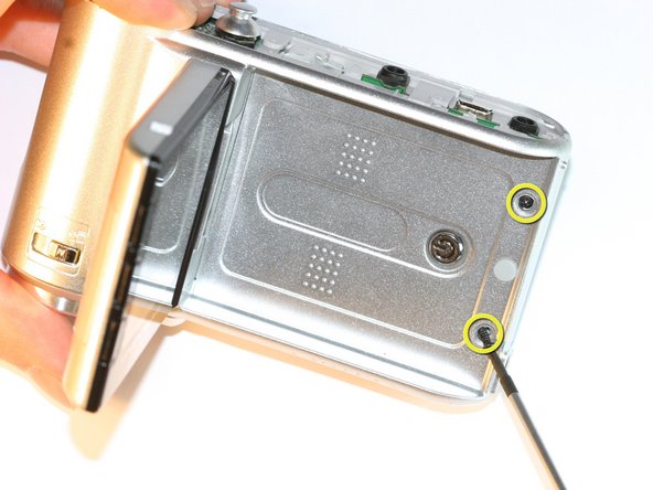

    • Flip open the screen by pulling the loose end of the screen away from the case.
    • Use tweezers to remove the two outside rubber dots to reveal the two 0.5cm machine screws.
    • Use the #00 Phillips Screwdriver to remove both screws.

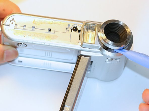

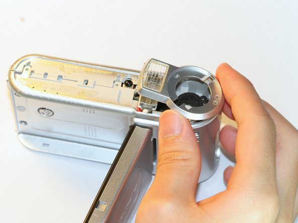

    • Use a plastic opening tool to pry off the lens protector.

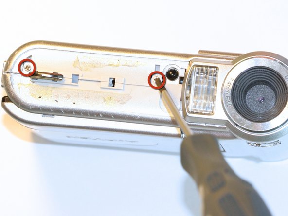

  11. Aiptek DZO-V58N Image Sensor Replacement, Lens: crwdns2935265:011crwdnd2935265:01crwdnd2935265:03crwdne2935265:0 Aiptek DZO-V58N Image Sensor Replacement, Lens: crwdns2935265:011crwdnd2935265:02crwdnd2935265:03crwdne2935265:0 Aiptek DZO-V58N Image Sensor Replacement, Lens: crwdns2935265:011crwdnd2935265:03crwdnd2935265:03crwdne2935265:0
    • Unscrew the two silver 0.5cm machine screws with the #00 Phillips screwdriver.
    • Lift off the lens protector housing.

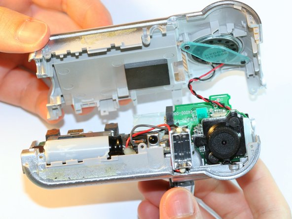

    • Pull apart the two halves of the camera body.
    • Do not pull the two halves apart too far because the wires may detach.

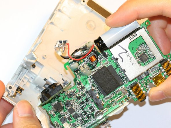

    • Use the #00 Phillips Screwdriver to unscrew the 3 circuit board screws.
    • Slightly separate circuit board from plastic case by lifting the circuit board straight out.

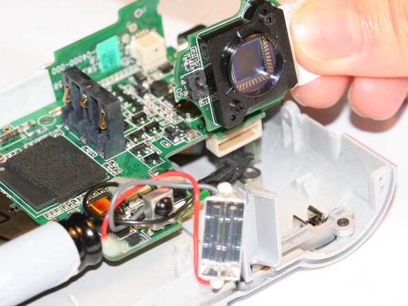

  16. Aiptek DZO-V58N Image Sensor Replacement: crwdns2935265:016crwdnd2935265:01crwdnd2935265:02crwdne2935265:0 Aiptek DZO-V58N Image Sensor Replacement: crwdns2935265:016crwdnd2935265:02crwdnd2935265:02crwdne2935265:0
    • Unplug the image sensor from the circuit board.
    • Pull the image sensor straight out to avoid damage to the pin connectors.
