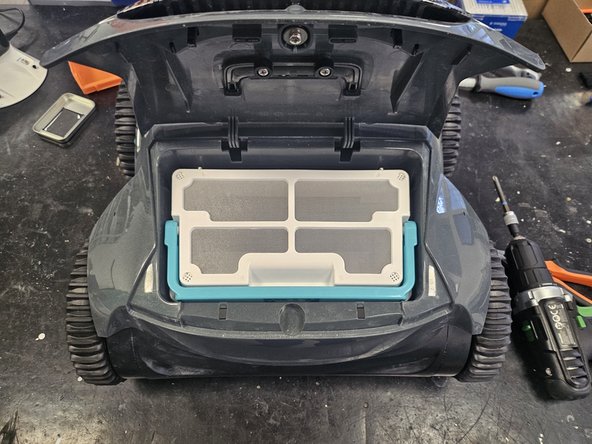

  1. Aiper Seagull Pro: Teardown, Remove the trash bin: crwdns2935265:01crwdnd2935265:01crwdnd2935265:02crwdne2935265:0 Aiper Seagull Pro: Teardown, Remove the trash bin: crwdns2935265:01crwdnd2935265:02crwdnd2935265:02crwdne2935265:0
    • Start by removing the trash bin from the robot.

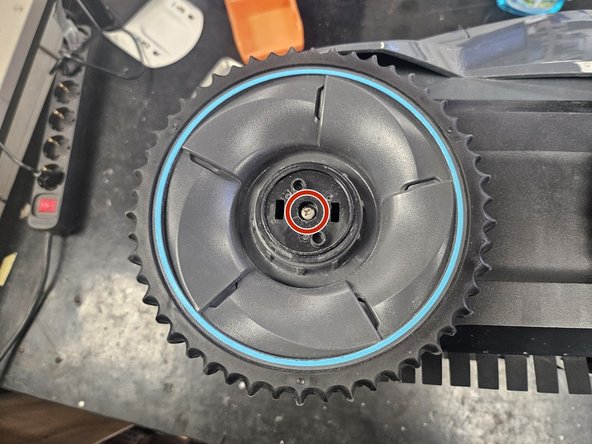

  2. Aiper Seagull Pro: Teardown, Wheels: crwdns2935265:02crwdnd2935265:01crwdnd2935265:03crwdne2935265:0 Aiper Seagull Pro: Teardown, Wheels: crwdns2935265:02crwdnd2935265:02crwdnd2935265:03crwdne2935265:0 Aiper Seagull Pro: Teardown, Wheels: crwdns2935265:02crwdnd2935265:03crwdnd2935265:03crwdne2935265:0
    • Put it on its side, then pry off the black plastic cap from the wheels.
    • Should be able to do this with your hand, but you could use a flathead screwdriver for some extra leverage.
    • Once the cap is removed, remove the screw.
    • Then remove the wheels.

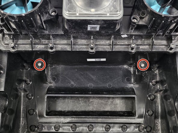

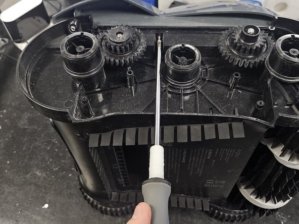

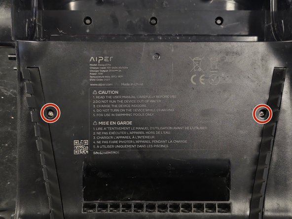

  4. Aiper Seagull Pro: Teardown, Chassis screws: crwdns2935265:04crwdnd2935265:01crwdnd2935265:02crwdne2935265:0 Aiper Seagull Pro: Teardown, Chassis screws: crwdns2935265:04crwdnd2935265:02crwdnd2935265:02crwdne2935265:0
    • Remove the screws holding the chassis together.
    • I recommend a looong PH2 screwdriver for this task.

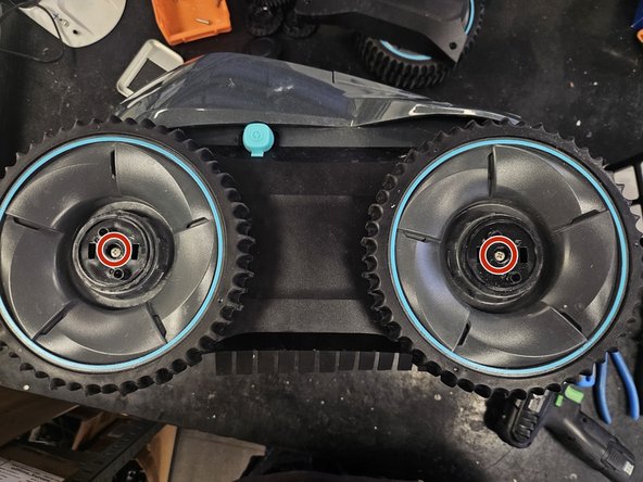

  5. Aiper Seagull Pro: Teardown, Other side's wheels: crwdns2935265:05crwdnd2935265:01crwdnd2935265:03crwdne2935265:0 Aiper Seagull Pro: Teardown, Other side's wheels: crwdns2935265:05crwdnd2935265:02crwdnd2935265:03crwdne2935265:0 Aiper Seagull Pro: Teardown, Other side's wheels: crwdns2935265:05crwdnd2935265:03crwdnd2935265:03crwdne2935265:0
    • Flip it over and remove the wheels.
    • Then remove the side cover screws.

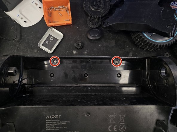

  6. Aiper Seagull Pro: Teardown, Other side's side cover and chassis screws: crwdns2935265:06crwdnd2935265:01crwdnd2935265:03crwdne2935265:0 Aiper Seagull Pro: Teardown, Other side's side cover and chassis screws: crwdns2935265:06crwdnd2935265:02crwdnd2935265:03crwdne2935265:0 Aiper Seagull Pro: Teardown, Other side's side cover and chassis screws: crwdns2935265:06crwdnd2935265:03crwdnd2935265:03crwdne2935265:0
    • Make sure to open the charging port cover, so that it doesn't stop you from remove the side cover.
    • Remove the side cover and the middle cog.
    • Remove the 2 screws holding the chassis together.

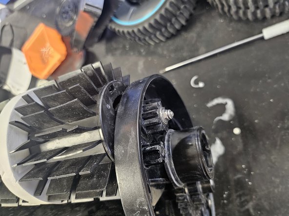

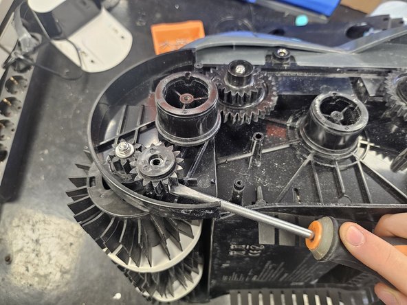

  7. Aiper Seagull Pro: Teardown, Brush assembly driver cog: crwdns2935265:07crwdnd2935265:01crwdnd2935265:03crwdne2935265:0 Aiper Seagull Pro: Teardown, Brush assembly driver cog: crwdns2935265:07crwdnd2935265:02crwdnd2935265:03crwdne2935265:0 Aiper Seagull Pro: Teardown, Brush assembly driver cog: crwdns2935265:07crwdnd2935265:03crwdnd2935265:03crwdne2935265:0
    • Remove the screw holding the side cog in place.
    • Use some leverage to remove the cog. It usually gets stuck in place due to limescale buildup.
    • Flip it on its back.

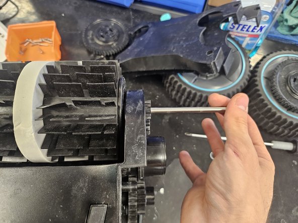

  8. Aiper Seagull Pro: Teardown, Brushes: crwdns2935265:08crwdnd2935265:01crwdnd2935265:03crwdne2935265:0 Aiper Seagull Pro: Teardown, Brushes: crwdns2935265:08crwdnd2935265:02crwdnd2935265:03crwdne2935265:0 Aiper Seagull Pro: Teardown, Brushes: crwdns2935265:08crwdnd2935265:03crwdnd2935265:03crwdne2935265:0
    • Use 2x 7mm wrenches to loosen the bolts on the rod going through the front brushes.
    • Remove the rod.
    • Do not lose the washers. One is on each side.
    • On the side that you removed the other cog, remove the now removable cog.

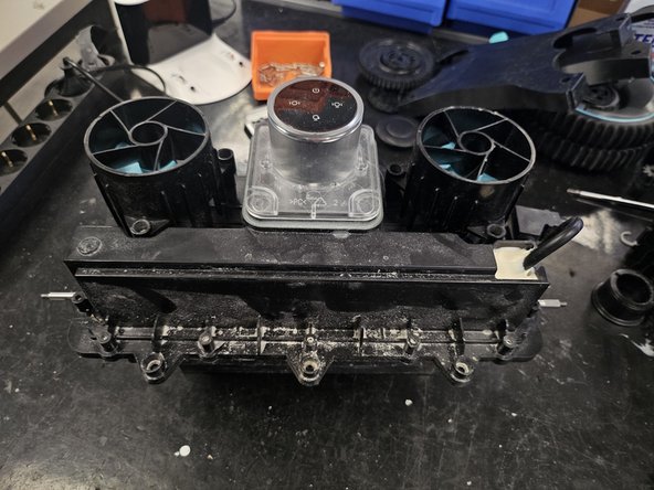

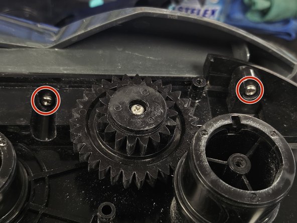

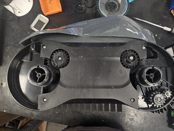

  9. Aiper Seagull Pro: Teardown, Chassis: crwdns2935265:09crwdnd2935265:01crwdnd2935265:03crwdne2935265:0 Aiper Seagull Pro: Teardown, Chassis: crwdns2935265:09crwdnd2935265:02crwdnd2935265:03crwdne2935265:0 Aiper Seagull Pro: Teardown, Chassis: crwdns2935265:09crwdnd2935265:03crwdnd2935265:03crwdne2935265:0
    • Remove the brushes by tilting them up on one side, then pulling them off.
    • If this is too difficult or the brushes are too tight due to wear, remove the 2 cogs on the other side and the brushes should just fall off.
    • Remove the 2 screws that were covered by the brushes.
    • Remove the top half of the chassis.

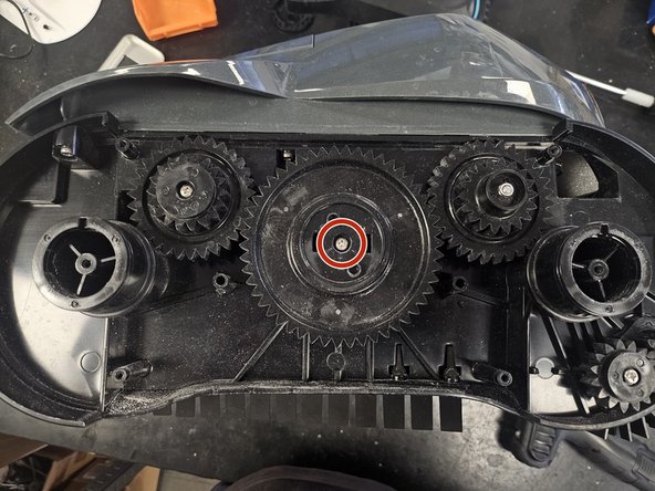

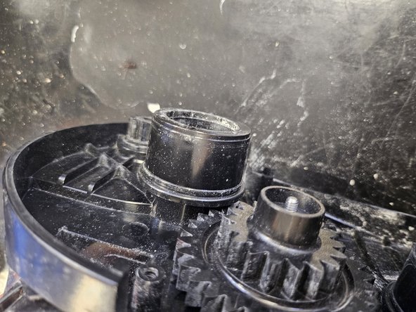

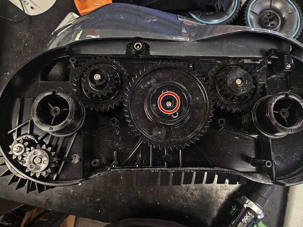

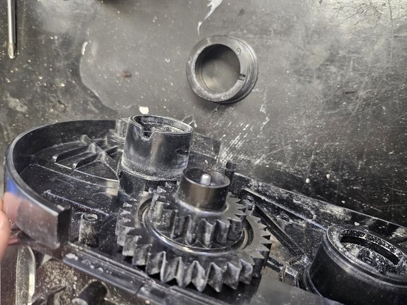

  11. Aiper Seagull Pro: Teardown, Main motor cogs: crwdns2935265:011crwdnd2935265:01crwdnd2935265:03crwdne2935265:0 Aiper Seagull Pro: Teardown, Main motor cogs: crwdns2935265:011crwdnd2935265:02crwdnd2935265:03crwdne2935265:0 Aiper Seagull Pro: Teardown, Main motor cogs: crwdns2935265:011crwdnd2935265:03crwdnd2935265:03crwdne2935265:0
    • Use a 7mm wrench (or other tool) to remove this nut from the cog.
    • Then remove the plastic circle thing, as it covers it and prevents you from removing the cog.
    • Then remove the cog.

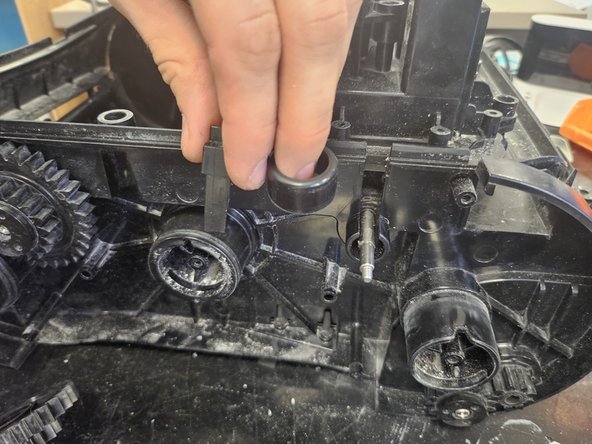

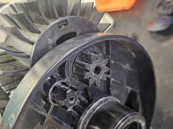

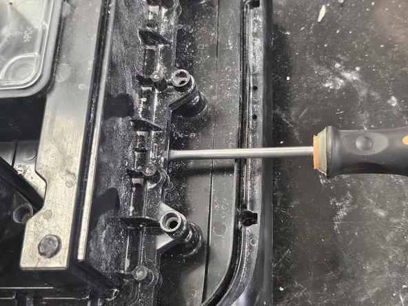

  12. Aiper Seagull Pro: Teardown, Plastic covers: crwdns2935265:012crwdnd2935265:01crwdnd2935265:02crwdne2935265:0 Aiper Seagull Pro: Teardown, Plastic covers: crwdns2935265:012crwdnd2935265:02crwdnd2935265:02crwdne2935265:0
    • Remove the plastic circle and tab.
    • The tab may be a bit stuck. I usually help myself with some pliers.
    • Repeat this and the previous step on the other side as well.

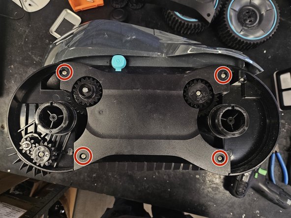

  13. Aiper Seagull Pro: Teardown, Final chassis screws: crwdns2935265:013crwdnd2935265:01crwdnd2935265:03crwdne2935265:0 Aiper Seagull Pro: Teardown, Final chassis screws: crwdns2935265:013crwdnd2935265:02crwdnd2935265:03crwdne2935265:0 Aiper Seagull Pro: Teardown, Final chassis screws: crwdns2935265:013crwdnd2935265:03crwdnd2935265:03crwdne2935265:0
    • Remove all of the marked screws.

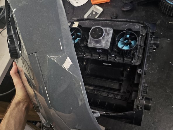

  14. Aiper Seagull Pro: Teardown, Remove the assembly: crwdns2935265:014crwdnd2935265:01crwdnd2935265:03crwdne2935265:0 Aiper Seagull Pro: Teardown, Remove the assembly: crwdns2935265:014crwdnd2935265:02crwdnd2935265:03crwdne2935265:0 Aiper Seagull Pro: Teardown, Remove the assembly: crwdns2935265:014crwdnd2935265:03crwdnd2935265:03crwdne2935265:0
    • Pull on the 2 rods to remove the assembly from the chassis.
    • If the assembly is stuck to the chassis, use some frontal or side leverage to get it free.
    • It can get stuck due to limescale, dirt, sand buildup. And it can stick like glue.

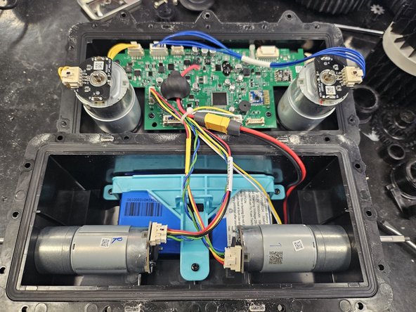

  15. Aiper Seagull Pro: Teardown, Voila!: crwdns2935265:015crwdnd2935265:01crwdnd2935265:02crwdne2935265:0 Aiper Seagull Pro: Teardown, Voila!: crwdns2935265:015crwdnd2935265:02crwdnd2935265:02crwdne2935265:0
    • Unscrew all of the screws in the assembly, and voila!
    • It's open.
