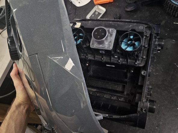

    • Start by removing the trash bin from the robot.

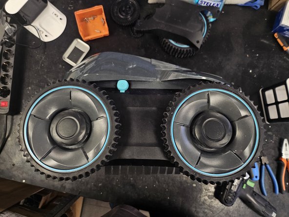

  2. Aiper Seagull Pro: Button bearing replacement, Wheels: crwdns2935265:02crwdnd2935265:01crwdnd2935265:03crwdne2935265:0 Aiper Seagull Pro: Button bearing replacement, Wheels: crwdns2935265:02crwdnd2935265:02crwdnd2935265:03crwdne2935265:0 Aiper Seagull Pro: Button bearing replacement, Wheels: crwdns2935265:02crwdnd2935265:03crwdnd2935265:03crwdne2935265:0
    • Put it on its side, then pry off the black plastic cap from the wheels.
    • Should be able to do this with your hand, but you could use a flathead screwdriver for some extra leverage.

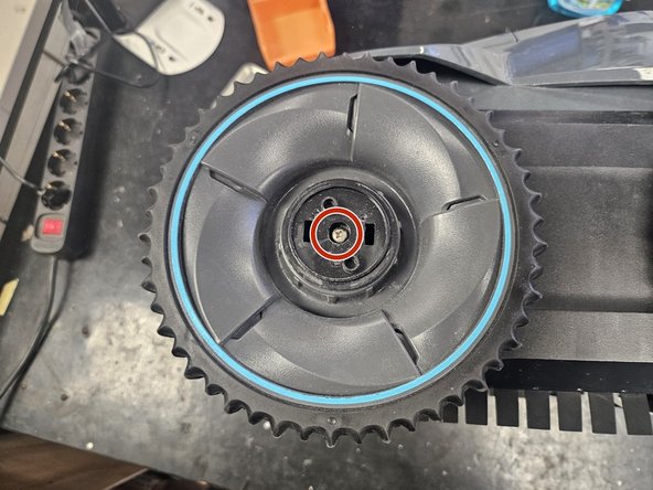

    • Once the cap is removed, remove the screw.
    • Then remove the wheels.

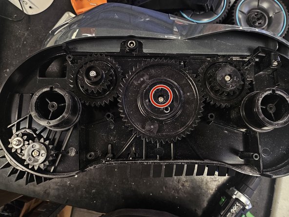

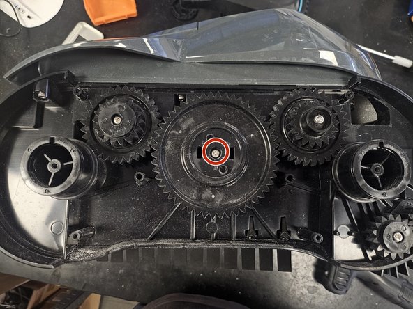

  3. Aiper Seagull Pro: Button bearing replacement, Cover and middle cog: crwdns2935265:03crwdnd2935265:01crwdnd2935265:02crwdne2935265:0 Aiper Seagull Pro: Button bearing replacement, Cover and middle cog: crwdns2935265:03crwdnd2935265:02crwdnd2935265:02crwdne2935265:0
    • Remove the screws, then remove the plastic cover.
    • Remove the screw from the middle cog, then remove the cog.

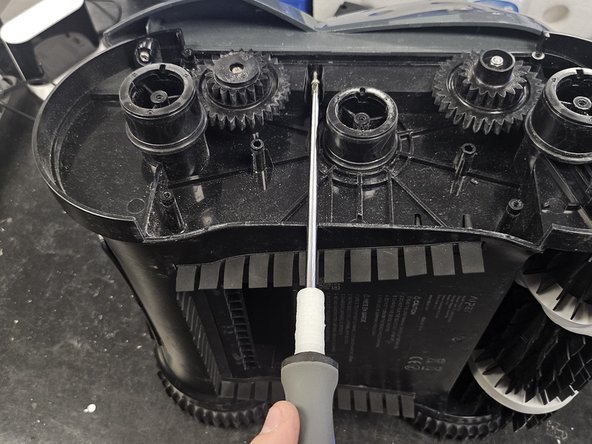

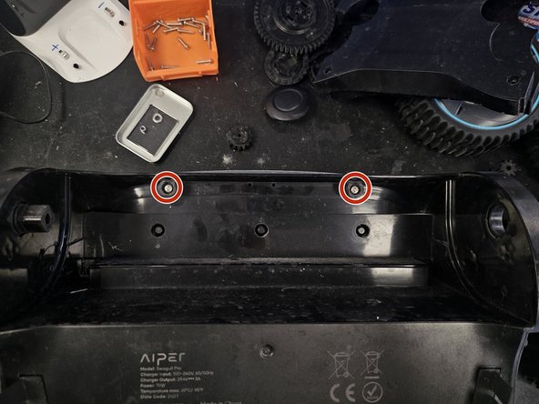

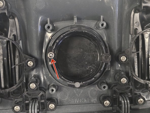

  4. Aiper Seagull Pro: Button bearing replacement, Chassis screws: crwdns2935265:04crwdnd2935265:01crwdnd2935265:02crwdne2935265:0 Aiper Seagull Pro: Button bearing replacement, Chassis screws: crwdns2935265:04crwdnd2935265:02crwdnd2935265:02crwdne2935265:0
    • Remove the screws holding the chassis together.
    • I recommend a looong PH2 screwdriver for this task.

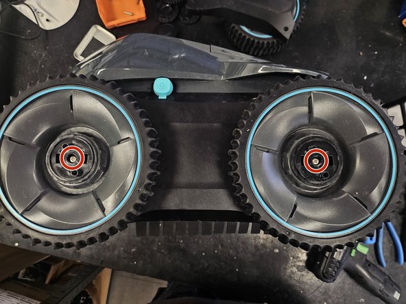

  5. Aiper Seagull Pro: Button bearing replacement, Other side's wheels: crwdns2935265:05crwdnd2935265:01crwdnd2935265:03crwdne2935265:0 Aiper Seagull Pro: Button bearing replacement, Other side's wheels: crwdns2935265:05crwdnd2935265:02crwdnd2935265:03crwdne2935265:0 Aiper Seagull Pro: Button bearing replacement, Other side's wheels: crwdns2935265:05crwdnd2935265:03crwdnd2935265:03crwdne2935265:0
    • Flip it over and remove the wheels.
    • Then remove the side cover screws.

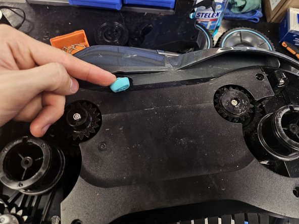

  6. Aiper Seagull Pro: Button bearing replacement, Other side's side cover and chassis screws: crwdns2935265:06crwdnd2935265:01crwdnd2935265:03crwdne2935265:0 Aiper Seagull Pro: Button bearing replacement, Other side's side cover and chassis screws: crwdns2935265:06crwdnd2935265:02crwdnd2935265:03crwdne2935265:0 Aiper Seagull Pro: Button bearing replacement, Other side's side cover and chassis screws: crwdns2935265:06crwdnd2935265:03crwdnd2935265:03crwdne2935265:0
    • Make sure to open the charging port cover, so that it doesn't stop you from remove the side cover.
    • Remove the side cover and the middle cog.
    • Remove the 2 screws holding the chassis together.

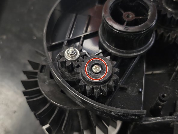

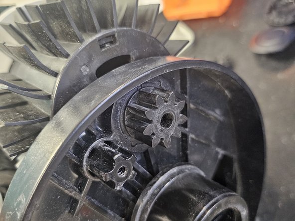

  7. Aiper Seagull Pro: Button bearing replacement, Brush assembly driver cog: crwdns2935265:07crwdnd2935265:01crwdnd2935265:03crwdne2935265:0 Aiper Seagull Pro: Button bearing replacement, Brush assembly driver cog: crwdns2935265:07crwdnd2935265:02crwdnd2935265:03crwdne2935265:0 Aiper Seagull Pro: Button bearing replacement, Brush assembly driver cog: crwdns2935265:07crwdnd2935265:03crwdnd2935265:03crwdne2935265:0

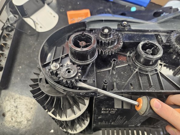

    • Remove the screw holding the side cog in place.
    • Use some leverage to remove the cog. It usually gets stuck in place due to limescale buildup.
    • Flip it on its back.

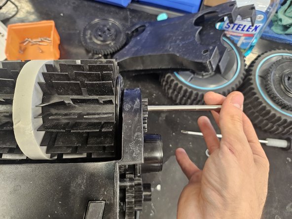

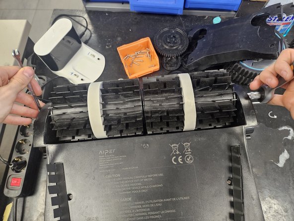

  8. Aiper Seagull Pro: Button bearing replacement, Brushes: crwdns2935265:08crwdnd2935265:01crwdnd2935265:03crwdne2935265:0 Aiper Seagull Pro: Button bearing replacement, Brushes: crwdns2935265:08crwdnd2935265:02crwdnd2935265:03crwdne2935265:0 Aiper Seagull Pro: Button bearing replacement, Brushes: crwdns2935265:08crwdnd2935265:03crwdnd2935265:03crwdne2935265:0

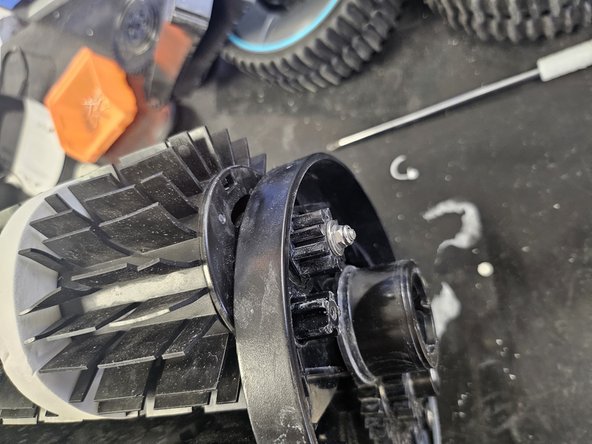

    • Use 2x 7mm wrenches to loosen the bolts on the rod going through the front brushes.
    • Remove the rod.
    • Do not lose the washers. One is on each side.
    • On the side that you removed the other cog, remove the now removable cog.

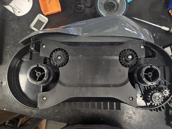

  9. Aiper Seagull Pro: Button bearing replacement, Chassis: crwdns2935265:09crwdnd2935265:01crwdnd2935265:03crwdne2935265:0 Aiper Seagull Pro: Button bearing replacement, Chassis: crwdns2935265:09crwdnd2935265:02crwdnd2935265:03crwdne2935265:0 Aiper Seagull Pro: Button bearing replacement, Chassis: crwdns2935265:09crwdnd2935265:03crwdnd2935265:03crwdne2935265:0
    • Remove the brushes by tilting them up on one side, then pulling them off.
    • If this is too difficult or the brushes are too tight due to wear, remove the 2 cogs on the other side and the brushes should just fall off.

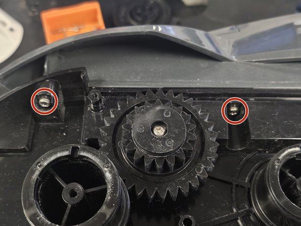

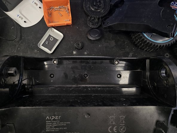

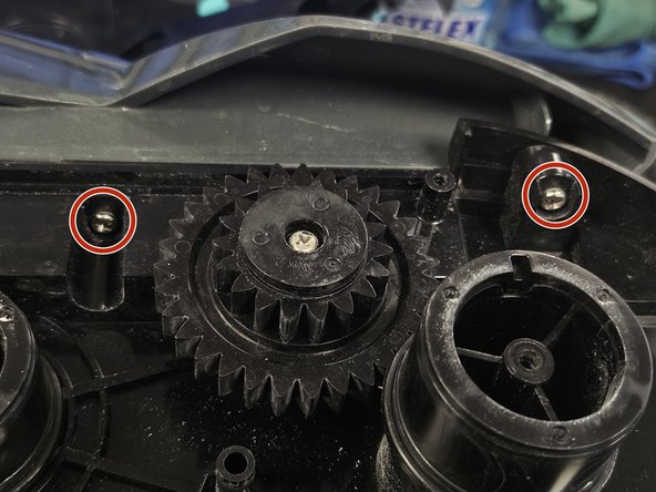

    • Remove the 2 screws that were covered by the brushes.
    • Remove the top half of the chassis.

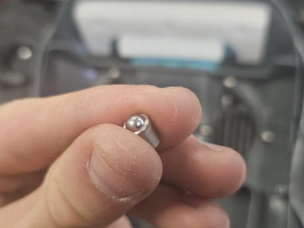

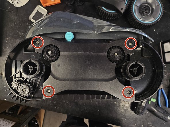

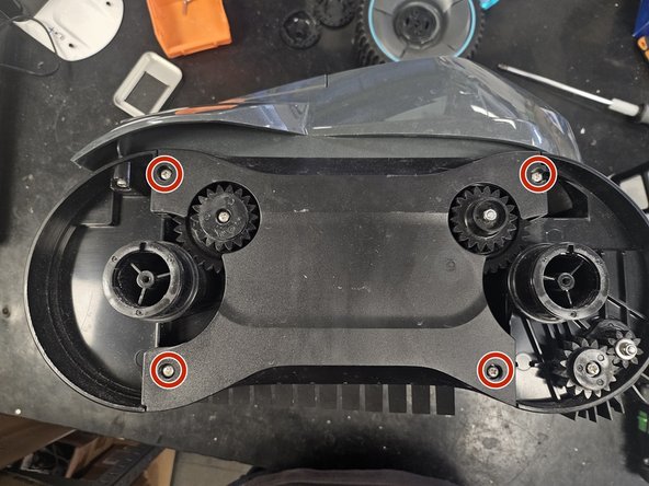

  10. Aiper Seagull Pro: Button bearing replacement, Ball bearing: crwdns2935265:010crwdnd2935265:01crwdnd2935265:03crwdne2935265:0 Aiper Seagull Pro: Button bearing replacement, Ball bearing: crwdns2935265:010crwdnd2935265:02crwdnd2935265:03crwdne2935265:0 Aiper Seagull Pro: Button bearing replacement, Ball bearing: crwdns2935265:010crwdnd2935265:03crwdnd2935265:03crwdne2935265:0

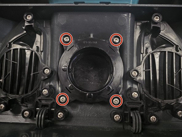

    • Remove the 4 screws, then remove the button assembly.
    • Remove the ball bearing.
    • Either thoroughly clean it or replace it.

By myself, i havn't seen the 2 screws hidden by the main large cog to remove the chassis top. Thanks for your clear explanations.
