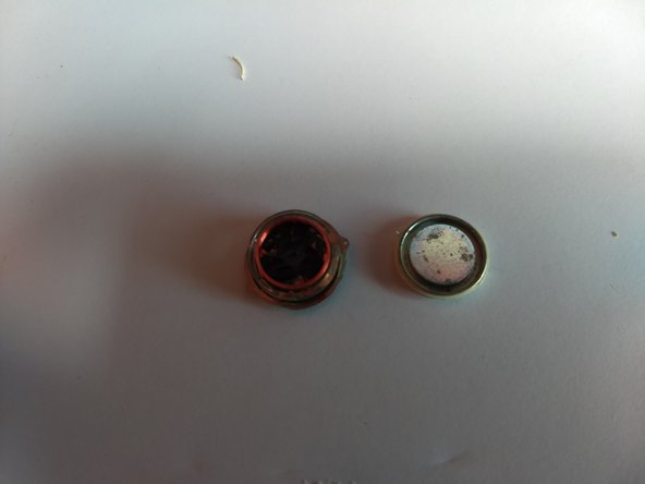

  3. Aftershokz Trekz Titanium Teardown, Right speaker: crwdns2935265:03crwdnd2935265:01crwdnd2935265:03crwdne2935265:0 Aftershokz Trekz Titanium Teardown, Right speaker: crwdns2935265:03crwdnd2935265:02crwdnd2935265:03crwdne2935265:0 Aftershokz Trekz Titanium Teardown, Right speaker: crwdns2935265:03crwdnd2935265:03crwdnd2935265:03crwdne2935265:0
    • The rubber does peel away from the rest of the driver quite easily. It should be possible to do this without detaching the driver from its wires - we'll test that with the left in a bit.
    • This is a surprisingly strong magnet given there is no discernible force felt outside the headphones when assembled.
    • It reads 2018-12-03
    • The magnet can be separated from the rest of the speaker with some assitance from a penknife. Only the white sealant around the outside holds it in place, otherwise it simply slots between the red coil and outer plastic case.
    • Further disassembly does not appear possible without causing serious damage.

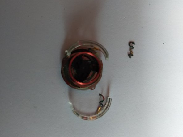

  4. Aftershokz Trekz Titanium Teardown, Causing serious damage: crwdns2935265:04crwdnd2935265:01crwdnd2935265:02crwdne2935265:0 Aftershokz Trekz Titanium Teardown, Causing serious damage: crwdns2935265:04crwdnd2935265:02crwdnd2935265:02crwdne2935265:0
    • Turns out the plastic outer ring is not just for support, it appears to form part of the circuit between the incoming wires and the driver.
    • If there is a correct way to dismantle the speaker, this was not it.
    • There don't appear to be any servicable parts in here.

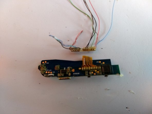

  12. Aftershokz Trekz Titanium Teardown, Chips: crwdns2935265:012crwdnd2935265:01crwdnd2935265:02crwdne2935265:0 Aftershokz Trekz Titanium Teardown, Chips: crwdns2935265:012crwdnd2935265:02crwdnd2935265:02crwdne2935265:0
    • The wires connect to a ribbon cable connected to the top of the plastic top, which then runs through a slot to the board. This could likely be dismantled non-destructively if you know what's there (but not without destroying the plastic body to get here).
    • Back side contains AXS T1 868 A50P next to the ribbon cable connection. There is also BTR0018, presumably the bluetooth controller. Another smaller chip would require a magnifying glass to read. Others are just labeled Uxx, where xx is some number.
    • Front side main chip is CSF 8640 B04G 8334P5. The large copper foil attaches by the back side of the bluetooth chip, and is presumably the antenna.
