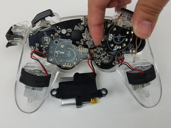

  3. Afterglow Wireless PS3 Controller Vibration Motor Replacement: crwdns2935265:03crwdnd2935265:01crwdnd2935265:01crwdne2935265:0
    • Unscrew the four 9mm Phillips #0 screws that are attached to both joy stick control mini-motherboards. There are two screws for each mini-motherboard.
  4. Afterglow Wireless PS3 Controller Vibration Motor Replacement: crwdns2935265:04crwdnd2935265:01crwdnd2935265:03crwdne2935265:0 Afterglow Wireless PS3 Controller Vibration Motor Replacement: crwdns2935265:04crwdnd2935265:02crwdnd2935265:03crwdne2935265:0 Afterglow Wireless PS3 Controller Vibration Motor Replacement: crwdns2935265:04crwdnd2935265:03crwdnd2935265:03crwdne2935265:0
    • Jiggle both joy stick control mini-motherboards out of their holding place.
    • Set aside the mini-motherboards so that the vibration motor wire connections are accessible.

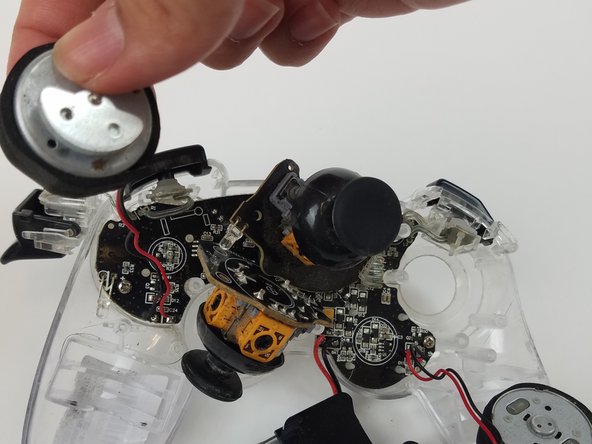

  5. Afterglow Wireless PS3 Controller Vibration Motor Replacement: crwdns2935265:05crwdnd2935265:01crwdnd2935265:02crwdne2935265:0 Afterglow Wireless PS3 Controller Vibration Motor Replacement: crwdns2935265:05crwdnd2935265:02crwdnd2935265:02crwdne2935265:0
    • Pull both vibration motors straight up from their holding place.

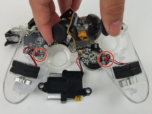

  6. Afterglow Wireless PS3 Controller Vibration Motor Replacement: crwdns2935265:06crwdnd2935265:01crwdnd2935265:01crwdne2935265:0
    • Use the soldering tool to heat the solder connecting the red and black vibration motor wires to the motherboard to detach the vibration motors.
    • Use this guide for further details on how to solder.
