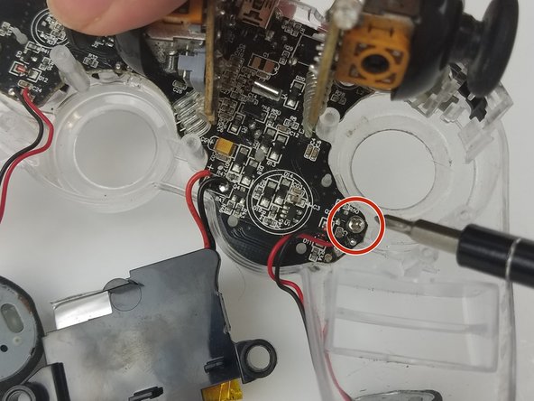

    • Unscrew the two 9mm Phillips #0 screws holding the motherboard to the controller front plate.
