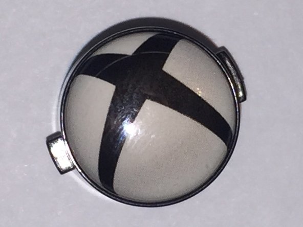

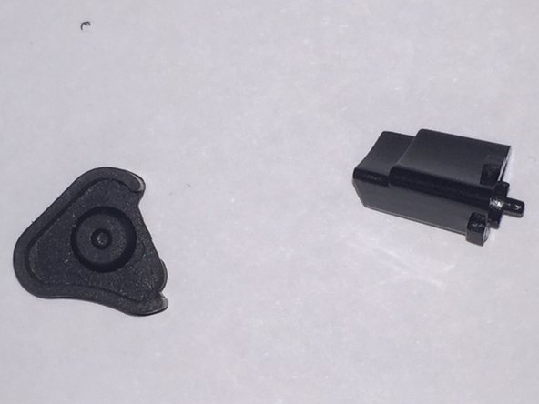

  4. Afterglow Prismatic Wired Controller for Xbox One Teardown, Remove power and mute buttons: crwdns2935265:04crwdnd2935265:01crwdnd2935265:03crwdne2935265:0 Afterglow Prismatic Wired Controller for Xbox One Teardown, Remove power and mute buttons: crwdns2935265:04crwdnd2935265:02crwdnd2935265:03crwdne2935265:0 Afterglow Prismatic Wired Controller for Xbox One Teardown, Remove power and mute buttons: crwdns2935265:04crwdnd2935265:03crwdnd2935265:03crwdne2935265:0
    • Remove the power and mute button by pulling them out. They will be loose at this point and may fall out by themselves.
