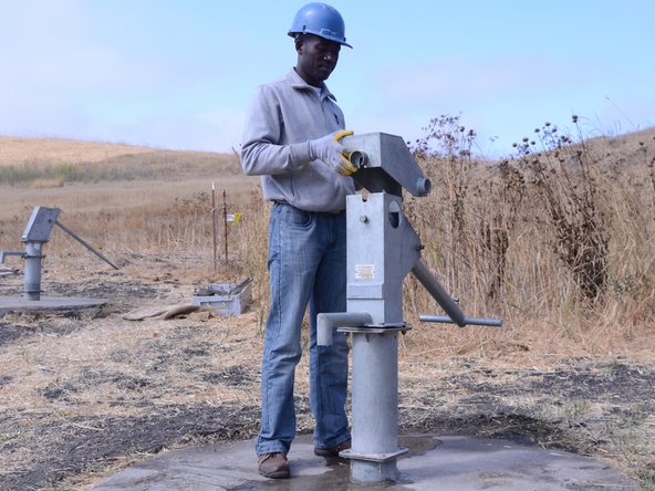

Afridev Head Replacement
  1. Afridev Head Replacement, Head: crwdns2935265:01crwdnd2935265:01crwdnd2935265:02crwdne2935265:0 Afridev Head Replacement, Head: crwdns2935265:01crwdnd2935265:02crwdnd2935265:02crwdne2935265:0
    • Assemble the required tools, including the Afridev tool and crescent wrenches.
  2. Afridev Head Replacement: crwdns2935265:02crwdnd2935265:01crwdnd2935265:03crwdne2935265:0 Afridev Head Replacement: crwdns2935265:02crwdnd2935265:02crwdnd2935265:03crwdne2935265:0 Afridev Head Replacement: crwdns2935265:02crwdnd2935265:03crwdnd2935265:03crwdne2935265:0
    • Perform a water test on the pump, by raising and lowering the handle a full 40 strokes. A properly performing pump will yield greater than 10 liters.
  3. Afridev Head Replacement: crwdns2935265:03crwdnd2935265:01crwdnd2935265:02crwdne2935265:0 Afridev Head Replacement: crwdns2935265:03crwdnd2935265:02crwdnd2935265:02crwdne2935265:0
    • Loosen the bolt on front of the face plate with the Afridev tool.
    • Remove the plate from the pump by lifting it straight up.
