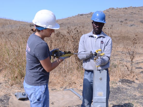

    • Loosen the bolt on front of the face plate with the Afridev tool.
    • Remove the plate from the pump by lifting it straight up.

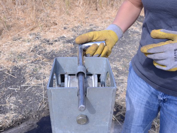

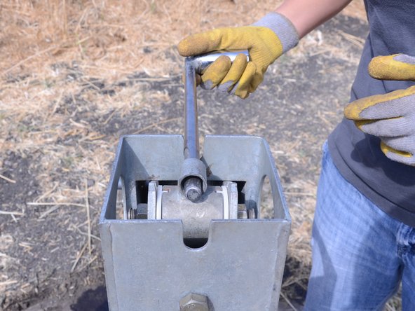

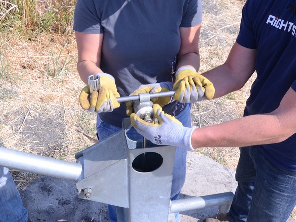

  4. Afridev Casing Pipe Disassembly, Axle and Handle: crwdns2935265:04crwdnd2935265:01crwdnd2935265:03crwdne2935265:0 Afridev Casing Pipe Disassembly, Axle and Handle: crwdns2935265:04crwdnd2935265:02crwdnd2935265:03crwdne2935265:0 Afridev Casing Pipe Disassembly, Axle and Handle: crwdns2935265:04crwdnd2935265:03crwdnd2935265:03crwdne2935265:0

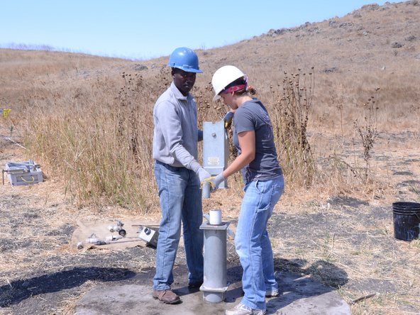

    • Insert the T-handle into the top cylinder of the exposed pump rod.
  5. Afridev Casing Pipe Disassembly: crwdns2935265:05crwdnd2935265:01crwdnd2935265:02crwdne2935265:0 Afridev Casing Pipe Disassembly: crwdns2935265:05crwdnd2935265:02crwdnd2935265:02crwdne2935265:0
    • Loosen the 2 bolts on either side of handle.
    • It is not necessary to remove the bolt at this time; however, take caution to not let the bolt fall out of the handle.
  6. Afridev Casing Pipe Disassembly: crwdns2935265:06crwdnd2935265:01crwdnd2935265:03crwdne2935265:0 Afridev Casing Pipe Disassembly: crwdns2935265:06crwdnd2935265:02crwdnd2935265:03crwdne2935265:0 Afridev Casing Pipe Disassembly: crwdns2935265:06crwdnd2935265:03crwdnd2935265:03crwdne2935265:0
    • Loosen the 2 bolts on either side of the head to remove the handle from the pump rod.

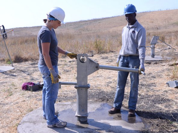

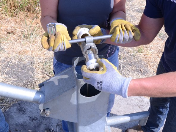

  7. Afridev Casing Pipe Disassembly: crwdns2935265:07crwdnd2935265:01crwdnd2935265:02crwdne2935265:0 Afridev Casing Pipe Disassembly: crwdns2935265:07crwdnd2935265:02crwdnd2935265:02crwdne2935265:0
    • Lift the handle to a horizontal position.
  8. Afridev Casing Pipe Disassembly: crwdns2935265:08crwdnd2935265:01crwdnd2935265:03crwdne2935265:0 Afridev Casing Pipe Disassembly: crwdns2935265:08crwdnd2935265:02crwdnd2935265:03crwdne2935265:0 Afridev Casing Pipe Disassembly: crwdns2935265:08crwdnd2935265:03crwdnd2935265:03crwdne2935265:0
    • While one person lifts up on the T-handle, remove the bolt and connection pieces.
  9. Afridev Casing Pipe Disassembly: crwdns2935265:09crwdnd2935265:01crwdnd2935265:03crwdne2935265:0 Afridev Casing Pipe Disassembly: crwdns2935265:09crwdnd2935265:02crwdnd2935265:03crwdne2935265:0 Afridev Casing Pipe Disassembly: crwdns2935265:09crwdnd2935265:03crwdnd2935265:03crwdne2935265:0
    • Remove the bolt and connection pieces from the handle.
    • Set the bolt pieces in a sanitary place, such as a bucket, to prevent contamination.
  10. Afridev Casing Pipe Disassembly: crwdns2935265:010crwdnd2935265:01crwdnd2935265:02crwdne2935265:0 Afridev Casing Pipe Disassembly: crwdns2935265:010crwdnd2935265:02crwdnd2935265:02crwdne2935265:0
    • Remove the handle from the pump.
    • Be sure to set the handle in a sanitary place to prevent contamination.

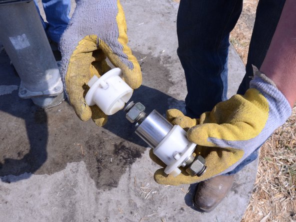

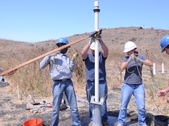

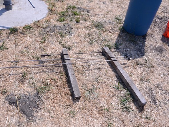

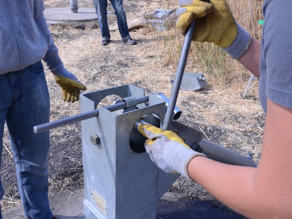

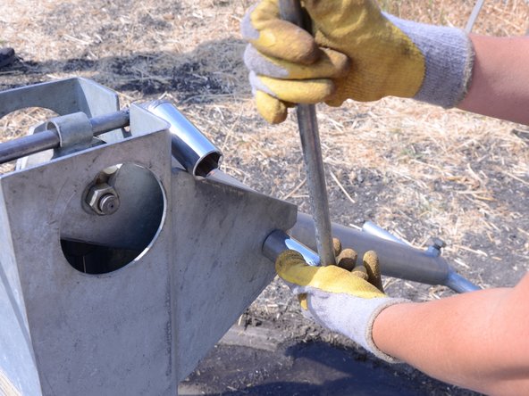

  11. Afridev Casing Pipe Disassembly, Pump Rod: crwdns2935265:011crwdnd2935265:01crwdnd2935265:02crwdne2935265:0 Afridev Casing Pipe Disassembly, Pump Rod: crwdns2935265:011crwdnd2935265:02crwdnd2935265:02crwdne2935265:0

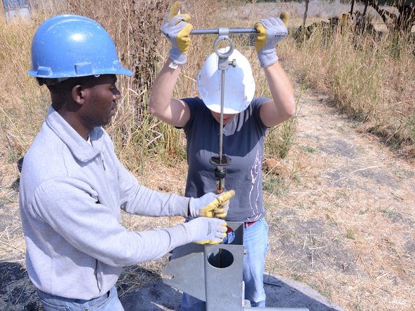

    • Grab firmly on the T-handle and lift the pump rod straight up.
    • Expose the first connection of the pump rod, and support the portion below the connection.
  12. Afridev Casing Pipe Disassembly: crwdns2935265:012crwdnd2935265:01crwdnd2935265:02crwdne2935265:0 Afridev Casing Pipe Disassembly: crwdns2935265:012crwdnd2935265:02crwdnd2935265:02crwdne2935265:0
    • While holding the pump rod below the first connection tightly, lower the first portion of the rod to a horizontal position.

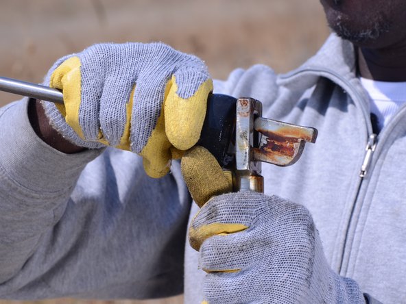

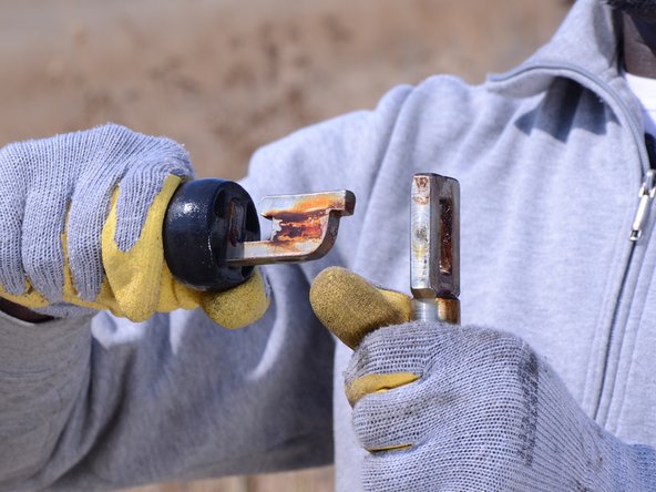

  13. Afridev Casing Pipe Disassembly: crwdns2935265:013crwdnd2935265:01crwdnd2935265:03crwdne2935265:0 Afridev Casing Pipe Disassembly: crwdns2935265:013crwdnd2935265:02crwdnd2935265:03crwdne2935265:0 Afridev Casing Pipe Disassembly: crwdns2935265:013crwdnd2935265:03crwdnd2935265:03crwdne2935265:0

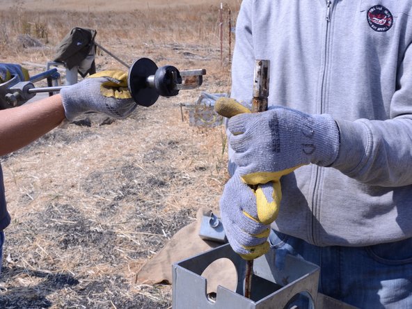

    • Unhook the first connection by pushing it out and down, then pulling it away from the rest of the rod.
  14. Afridev Casing Pipe Disassembly: crwdns2935265:014crwdnd2935265:01crwdnd2935265:03crwdne2935265:0 Afridev Casing Pipe Disassembly: crwdns2935265:014crwdnd2935265:02crwdnd2935265:03crwdne2935265:0 Afridev Casing Pipe Disassembly: crwdns2935265:014crwdnd2935265:03crwdnd2935265:03crwdne2935265:0
    • Repeat steps 11-13 for the remaining sections of pump rod.
    • Be sure to set the pump rod segments above the ground to avoid contamination.

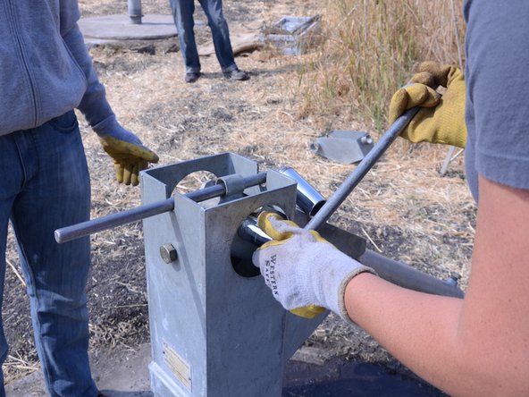

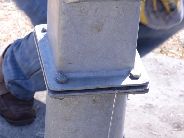

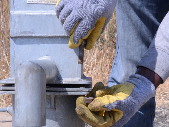

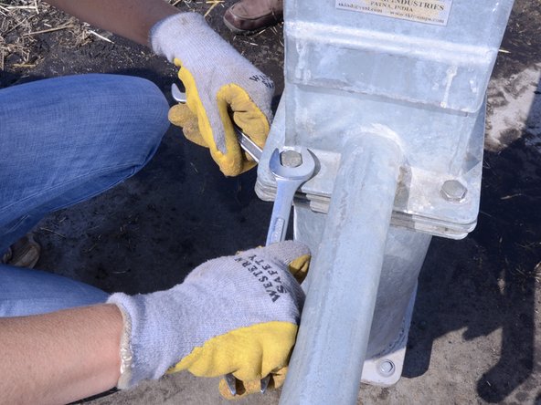

  15. Afridev Casing Pipe Disassembly, Tank: crwdns2935265:015crwdnd2935265:01crwdnd2935265:02crwdne2935265:0 Afridev Casing Pipe Disassembly, Tank: crwdns2935265:015crwdnd2935265:02crwdnd2935265:02crwdne2935265:0
    • Place one wrench on the top side of the top base of the tank spout.
    • Place another wrench on the underside of the bolt in order to get more leverage.
    • Pull the top wrench to the right, and the bottom wrench to the left.
  16. Afridev Casing Pipe Disassembly: crwdns2935265:016crwdnd2935265:01crwdnd2935265:03crwdne2935265:0 Afridev Casing Pipe Disassembly: crwdns2935265:016crwdnd2935265:02crwdnd2935265:03crwdne2935265:0 Afridev Casing Pipe Disassembly: crwdns2935265:016crwdnd2935265:03crwdnd2935265:03crwdne2935265:0
    • Remove the loosened bolt from the pump.
    • Repeat this procedure for the 3 remaining bolts.
  17. Afridev Casing Pipe Disassembly: crwdns2935265:017crwdnd2935265:01crwdnd2935265:02crwdne2935265:0 Afridev Casing Pipe Disassembly: crwdns2935265:017crwdnd2935265:02crwdnd2935265:02crwdne2935265:0
    • Lift the tank straight up to remove it from the pump.
    • Be sure to place the tank in a sanitary place to prevent contamination.

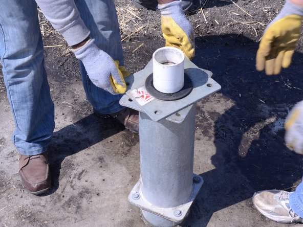

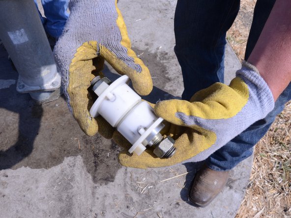

  18. Afridev Casing Pipe Disassembly, Afridev Casing Pipe Disassembly: crwdns2935265:018crwdnd2935265:01crwdnd2935265:02crwdne2935265:0 Afridev Casing Pipe Disassembly, Afridev Casing Pipe Disassembly: crwdns2935265:018crwdnd2935265:02crwdnd2935265:02crwdne2935265:0

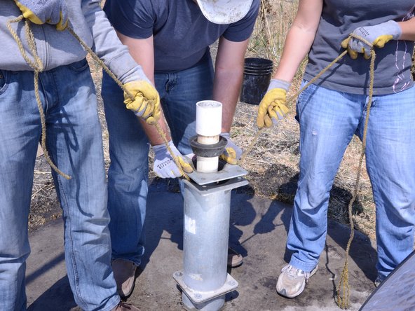

    • Slightly twist the head flange until the corners overhang the top of the tank, far enough so that you can grab them.

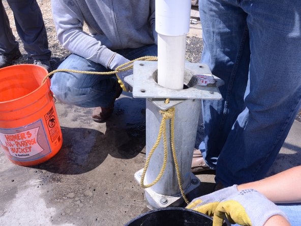

  19. Afridev Casing Pipe Disassembly: crwdns2935265:019crwdnd2935265:01crwdnd2935265:03crwdne2935265:0 Afridev Casing Pipe Disassembly: crwdns2935265:019crwdnd2935265:02crwdnd2935265:03crwdne2935265:0 Afridev Casing Pipe Disassembly: crwdns2935265:019crwdnd2935265:03crwdnd2935265:03crwdne2935265:0

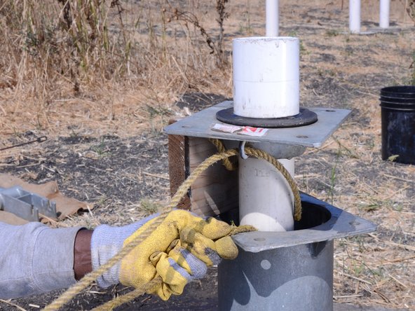

    • Lift the top plate to expose the casing pipe.
    • Place a piece of wood or brick underneath the top plate to hold it in place.

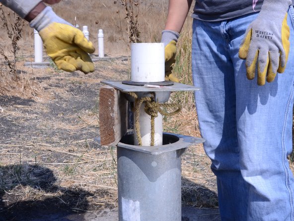

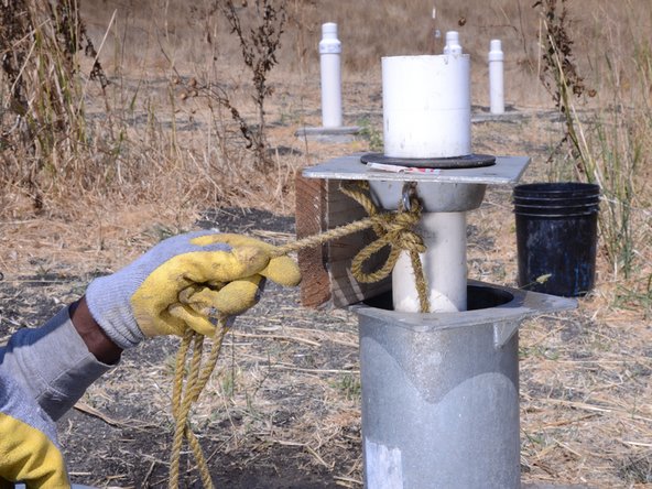

  20. Afridev Casing Pipe Disassembly: crwdns2935265:020crwdnd2935265:01crwdnd2935265:03crwdne2935265:0 Afridev Casing Pipe Disassembly: crwdns2935265:020crwdnd2935265:02crwdnd2935265:03crwdne2935265:0 Afridev Casing Pipe Disassembly: crwdns2935265:020crwdnd2935265:03crwdnd2935265:03crwdne2935265:0

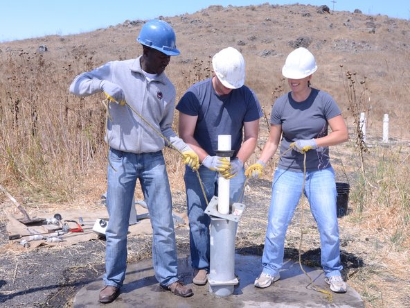

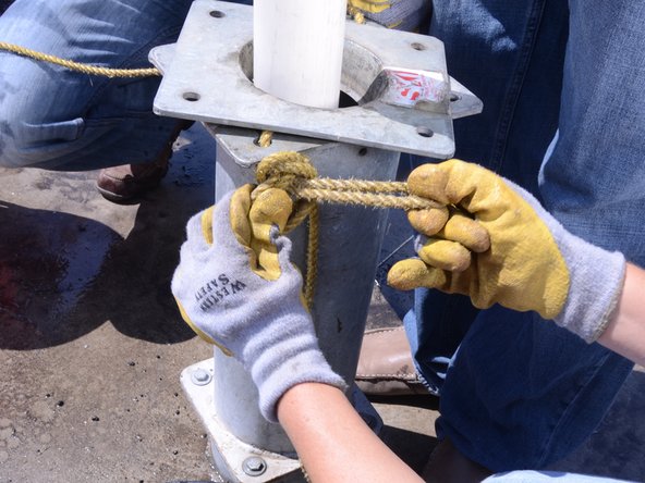

    • Untie knots from the flange, holding on to the loose ends of the rope.

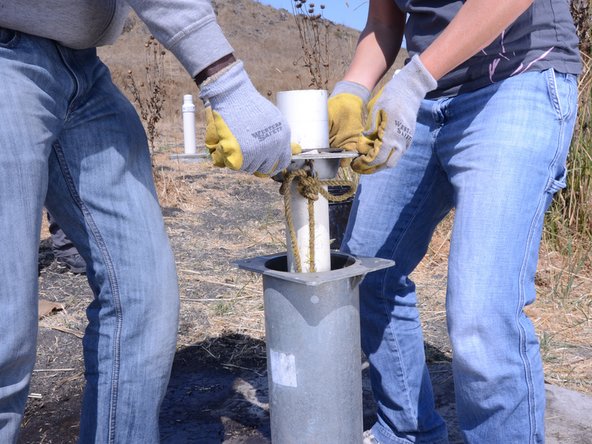

  21. Afridev Casing Pipe Disassembly: crwdns2935265:021crwdnd2935265:01crwdnd2935265:02crwdne2935265:0 Afridev Casing Pipe Disassembly: crwdns2935265:021crwdnd2935265:02crwdnd2935265:02crwdne2935265:0

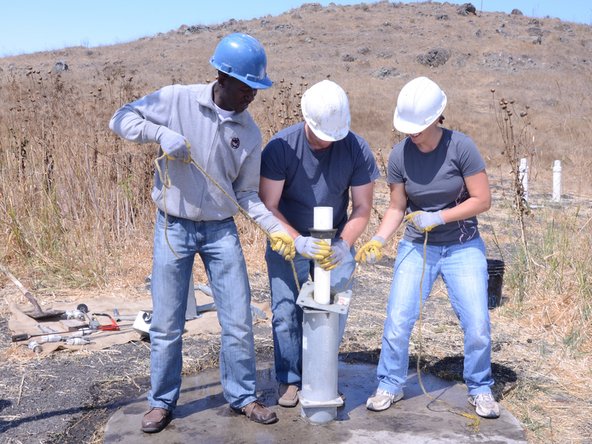

    • With two people holding each end of the rope, remove the support underneath the top plate and lower the plate.
    • This may require a bit of force, since the plate may be attached tightly.

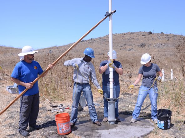

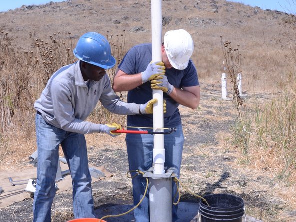

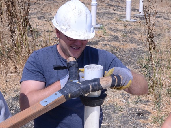

  22. Afridev Casing Pipe Disassembly: crwdns2935265:022crwdnd2935265:01crwdnd2935265:03crwdne2935265:0 Afridev Casing Pipe Disassembly: crwdns2935265:022crwdnd2935265:02crwdnd2935265:03crwdne2935265:0 Afridev Casing Pipe Disassembly: crwdns2935265:022crwdnd2935265:03crwdnd2935265:03crwdne2935265:0

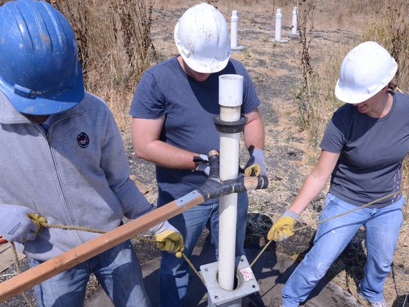

    • Lift the casing from the borehole, simultaneously pulling up on the ropes to support the casing.
  23. Afridev Casing Pipe Disassembly: crwdns2935265:023crwdnd2935265:01crwdnd2935265:03crwdne2935265:0 Afridev Casing Pipe Disassembly: crwdns2935265:023crwdnd2935265:02crwdnd2935265:03crwdne2935265:0 Afridev Casing Pipe Disassembly: crwdns2935265:023crwdnd2935265:03crwdnd2935265:03crwdne2935265:0
    • Slip a casing support over the casing.
  24. Afridev Casing Pipe Disassembly: crwdns2935265:024crwdnd2935265:01crwdnd2935265:03crwdne2935265:0 Afridev Casing Pipe Disassembly: crwdns2935265:024crwdnd2935265:02crwdnd2935265:03crwdne2935265:0 Afridev Casing Pipe Disassembly: crwdns2935265:024crwdnd2935265:03crwdnd2935265:03crwdne2935265:0
    • Continue lifting the casing, supporting the top portion with the casing support, as needed.
  25. Afridev Casing Pipe Disassembly: crwdns2935265:025crwdnd2935265:01crwdnd2935265:03crwdne2935265:0 Afridev Casing Pipe Disassembly: crwdns2935265:025crwdnd2935265:02crwdnd2935265:03crwdne2935265:0 Afridev Casing Pipe Disassembly: crwdns2935265:025crwdnd2935265:03crwdnd2935265:03crwdne2935265:0
    • When you reach the portion of the casing that needs to be repaired, tie the casing support ropes onto the frame.
  26. Afridev Casing Pipe Disassembly: crwdns2935265:026crwdnd2935265:01crwdnd2935265:02crwdne2935265:0 Afridev Casing Pipe Disassembly: crwdns2935265:026crwdnd2935265:02crwdnd2935265:02crwdne2935265:0
    • While supporting the casing, make the necessary repairs to the casing pipe.
