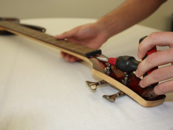

    • Loosen all of the strings completely by turning each tuning peg counter clockwise. Continue until there is no tension in the strings

    • Remove each string by pulling it out of the string tree at the top and through the bridge at the bottom.

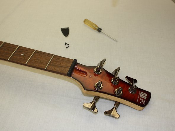

    • Locate the screws covering the truss rod.
  15. Adjusting Ibanez SR405QM Truss Rod: crwdns2935265:016crwdnd2935265:01crwdnd2935265:02crwdne2935265:0 Adjusting Ibanez SR405QM Truss Rod: crwdns2935265:016crwdnd2935265:02crwdnd2935265:02crwdne2935265:0
    • Remove each of the screws with the Philips #1 screwdriver.
    • Remove the plate covering the truss rod by sliding it off.
  16. Adjusting Ibanez SR405QM Truss Rod: crwdns2935265:017crwdnd2935265:01crwdnd2935265:02crwdne2935265:0 Adjusting Ibanez SR405QM Truss Rod: crwdns2935265:017crwdnd2935265:02crwdnd2935265:02crwdne2935265:0
    • Locate the truss rod hex nut.
    • If your fret board is bowing upward towards the strings, loosen the truss rod by turn by turning the hex wrench a quarter to half turn counter-clockwise.
    • If your fret board is bowing down away from the strings, tighten the truss rod by turning the hex wrench a quarter to half a turn clockwise.
