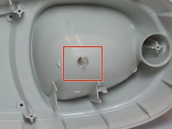

  6. AcuRite 02032 Wind Cup Assembly Replacement, Wind Cup Assembly: crwdns2935265:06crwdnd2935265:01crwdnd2935265:01crwdne2935265:0
    • Remove the four 0.8cm screws inside the case located near the fan using the J1 screw bit.
  7. AcuRite 02032 Wind Cup Assembly Replacement: crwdns2935265:07crwdnd2935265:01crwdnd2935265:02crwdne2935265:0 AcuRite 02032 Wind Cup Assembly Replacement: crwdns2935265:07crwdnd2935265:02crwdnd2935265:02crwdne2935265:0
    • With all four screws removed, the wind cup assembly should lift straight up off the middle section.
    • Set down the bottom half of the weather center careful. There are two small pegs that will break with the slightest amount of pressure.

Do you have to replace the whole top, wind cups,top plate with solar panel, just for the wind cups?
Tom Halverson - crwdns2934203:0crwdne2934203:0
For a broken wind cups do you have to replace the top section with the solar panel?
No. After you take it apart hold the shaft turn broken cup assy off. Install new cups in reverse order.
