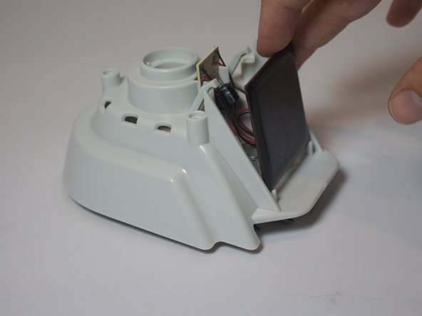

  9. AcuRite 02032 Solar Panel Replacement: crwdns2935265:09crwdnd2935265:01crwdnd2935265:01crwdne2935265:0
    • Carefully slide apart the two parts of the solar panel housing.
  10. AcuRite 02032 Solar Panel Replacement, Solar Panel: crwdns2935265:010crwdnd2935265:01crwdnd2935265:03crwdne2935265:0 AcuRite 02032 Solar Panel Replacement, Solar Panel: crwdns2935265:010crwdnd2935265:02crwdnd2935265:03crwdne2935265:0 AcuRite 02032 Solar Panel Replacement, Solar Panel: crwdns2935265:010crwdnd2935265:03crwdnd2935265:03crwdne2935265:0
    • Gently pull up on the two hooks holding down the solar panel.
    • Gently pull down on the solar panel.
  11. AcuRite 02032 Solar Panel Replacement: crwdns2935265:011crwdnd2935265:01crwdnd2935265:02crwdne2935265:0 AcuRite 02032 Solar Panel Replacement: crwdns2935265:011crwdnd2935265:02crwdnd2935265:02crwdne2935265:0
    • Carefully pull the solar panel out.
    • Pulling on the panel too hard may damage to the electronic components inside.

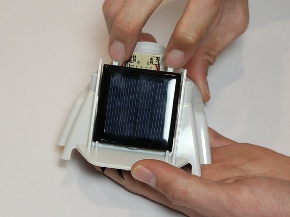

  12. AcuRite 02032 Solar Panel Replacement: crwdns2935265:012crwdnd2935265:01crwdnd2935265:02crwdne2935265:0 AcuRite 02032 Solar Panel Replacement: crwdns2935265:012crwdnd2935265:02crwdnd2935265:02crwdne2935265:0
    • Carefully lift the circuit board that the solar panel is attached to out of its apparatus.
    • Stretch out the panel and the board so you have more room to work.

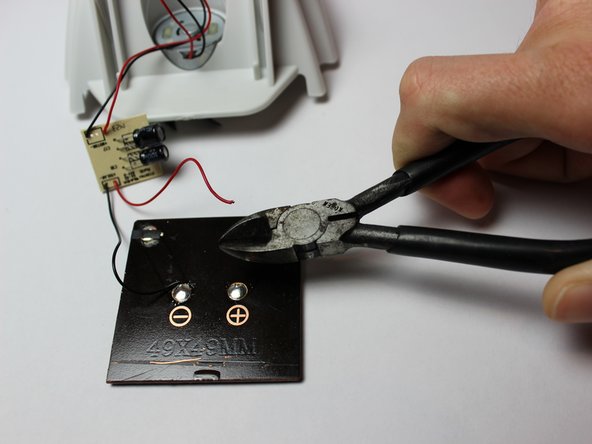

  13. AcuRite 02032 Solar Panel Replacement: crwdns2935265:013crwdnd2935265:01crwdnd2935265:03crwdne2935265:0 AcuRite 02032 Solar Panel Replacement: crwdns2935265:013crwdnd2935265:02crwdnd2935265:03crwdne2935265:0 AcuRite 02032 Solar Panel Replacement: crwdns2935265:013crwdnd2935265:03crwdnd2935265:03crwdne2935265:0
    • Clip the first wire connecting the old solar panel.
    • Cut as close to the solar panel as possible to make attaching the new solar panel easier.

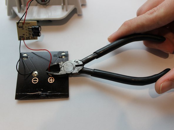

  14. AcuRite 02032 Solar Panel Replacement: crwdns2935265:014crwdnd2935265:01crwdnd2935265:02crwdne2935265:0 AcuRite 02032 Solar Panel Replacement: crwdns2935265:014crwdnd2935265:02crwdnd2935265:02crwdne2935265:0
    • Clip the second wire the same way.

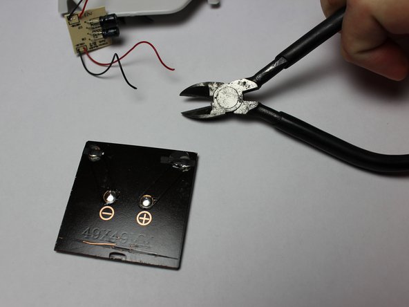

  15. AcuRite 02032 Solar Panel Replacement: crwdns2935265:015crwdnd2935265:01crwdnd2935265:03crwdne2935265:0 AcuRite 02032 Solar Panel Replacement: crwdns2935265:015crwdnd2935265:02crwdnd2935265:03crwdne2935265:0 AcuRite 02032 Solar Panel Replacement: crwdns2935265:015crwdnd2935265:03crwdnd2935265:03crwdne2935265:0

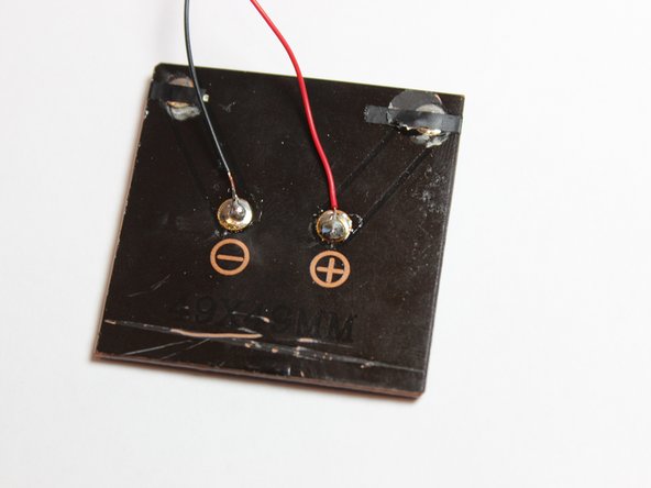

    • Strip the insulation off the wires to reveal the copper beneath.
    • The wires are very thin, so take care not to cut through them.

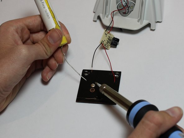

  16. AcuRite 02032 Solar Panel Replacement: crwdns2935265:016crwdnd2935265:01crwdnd2935265:03crwdne2935265:0 AcuRite 02032 Solar Panel Replacement: crwdns2935265:016crwdnd2935265:02crwdnd2935265:03crwdne2935265:0 AcuRite 02032 Solar Panel Replacement: crwdns2935265:016crwdnd2935265:03crwdnd2935265:03crwdne2935265:0
    • Do not reverse the + and the - wires
    • Red wire is positive (+), Black wire is negative (-)
    • Using a soldering iron, melt the solder to attach the wires to the panel.
    • You may need a third hand for this step.
    • Be sure to completely cover the ends of the wire with the solder.
    • Soldering is dangerous as the iron must get very hot to melt the metal solder.
    • Solder dripping off the iron can cause sever burns and start fires on clothing and tables.
