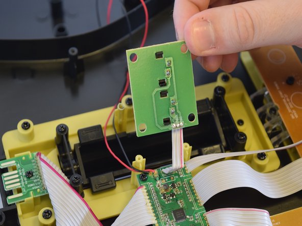

    • First, identify the Motherboard, it will be the green panel which all five separate white wire wraps connect to.
    • Once the Motherboard has been identified, begin unscrewing the Motherboard by using a Phillips Head 0 Screwdriver. There will be two 9 mm Phillips Head screws with, they are located on opposite corners.
    • To completely remove the motherboard, you must also remove the panel located right next to the Motherboard. There are four additional 12 mm Phillips Head screws with flared edges which connect the separate panel to the Guitar Controller, here we will use the same Phillips Head 0 Screwdriver.
  7. Activision Guitar Hero Live Guitar Controller Motherboard Replacement: crwdns2935265:07crwdnd2935265:01crwdnd2935265:03crwdne2935265:0 Activision Guitar Hero Live Guitar Controller Motherboard Replacement: crwdns2935265:07crwdnd2935265:02crwdnd2935265:03crwdne2935265:0 Activision Guitar Hero Live Guitar Controller Motherboard Replacement: crwdns2935265:07crwdnd2935265:03crwdnd2935265:03crwdne2935265:0
    • The last component you must remove to replace the Motherboard, is the Body-Neck adapter. This connector controls communication between the Guitar Keys and the body of the Guitar (Strum Bar, Whammy Bar, etc).
    • To remove the Body-Neck adapter, simply unscrew the one 12 mm screw which holds it in place, using a Phillips Head 0 Screwdriver.
    • Lastly, carefully lift all three components you have just unscrewed by the corners. The Motherboard will come off with little force.
