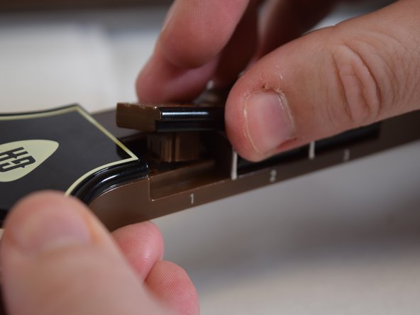

    • The first thing we want to do is remove the neck from the body. This is necessary to access either the inside of the neck or the body.
    • The round tab with a triangle can be turned by inserting a .25" tip Flathead screwdriver and turning. Simultaneously, as the tab turns about a quarter circle, pull the neck and it should slide out with minimal force.
    • Once the neck has been separated from the body remove the eight screws from the back of the neck with a Phillips Head 0 screwdriver. All screws are 12 mm.
    • Next remove the four screws that were covered by the neck.
    • Finally, remove the eight screws from the back of the body.
    • This screw at the bottom of the body is a bit longer than the others.
    • With all the screws out, both the neck and the body shells should open with minimal force.
    • When separating the front and back half of the body do so carefully as the wiring from the battery pack to the components is fixed to each half with adhesive and can detach from any of the points if pulled to roughly.
