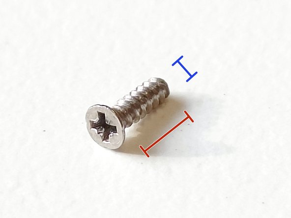

    • The body is made of two injection-molded red translucent polycarbonate parts: a casing and a cap. The cap is closed with 4 Philips flathead, countersunk, flat tip stainless steel screws. Use the #1 Philips head screwdriver to open the screws.
    • Screw diameter: 1.5mm
    • Thread length: 5mm

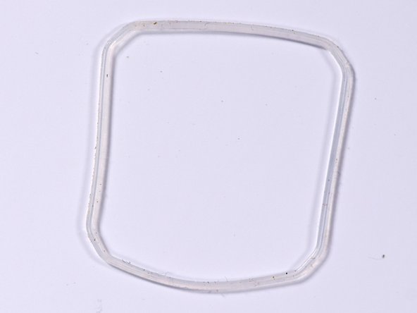

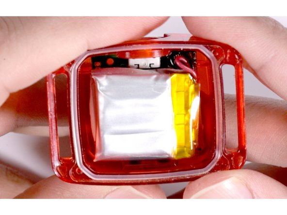

    • The casing was lined with a 1mm thick white translucent nylon rubber gasket.
    • Within the red translucent polycarbonate shell, there were two colourless transparent holes. These may be for the light sensors on the PCB to detect ambient light, a feature used to assist with sleep tracking.
    • The rubber gasket can be pulled out with tweezers. This gasket would help with water resistance.
    • Inside the device was a single unit that included a battery and the PCB. This could be pried out using a spudger.

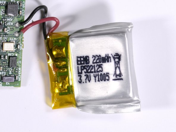

  5. ActiGraph GT3X-plus Teardown, The PCB and the Battery: crwdns2935265:05crwdnd2935265:01crwdnd2935265:02crwdne2935265:0 ActiGraph GT3X-plus Teardown, The PCB and the Battery: crwdns2935265:05crwdnd2935265:02crwdnd2935265:02crwdne2935265:0

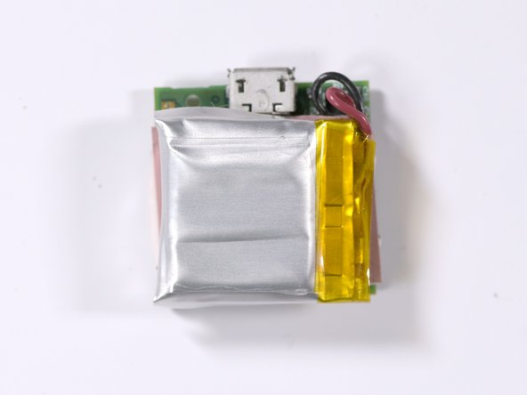

    • The battery is soldered on the PCB and the two are stuck together using 1mm thick foam double-sided tape (DST). The DST may also help with reducing water damage on the PCB by protecting the sensors and ICs.
    • There were no fasteners holding the PCB and the battery to the body.
    • The device uses an EEMB 3.7V 220mAh Lithium Polymer Rechargeable battery. This does not seem to be available anymore on their website.

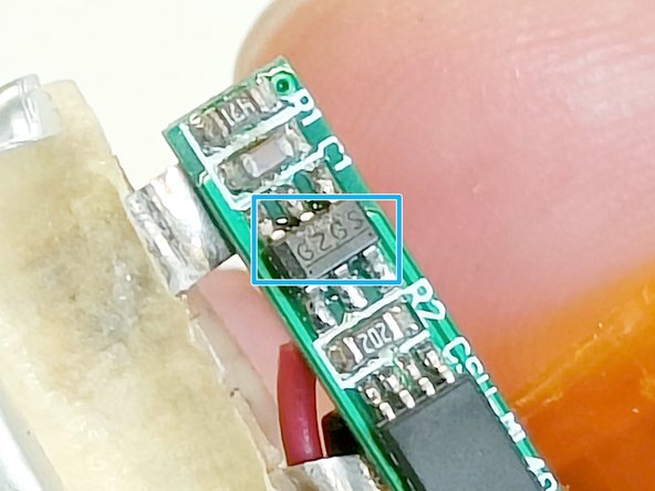

  6. ActiGraph GT3X-plus Teardown, There is a PCB on the battery!: crwdns2935265:06crwdnd2935265:01crwdnd2935265:03crwdne2935265:0 ActiGraph GT3X-plus Teardown, There is a PCB on the battery!: crwdns2935265:06crwdnd2935265:02crwdnd2935265:03crwdne2935265:0 ActiGraph GT3X-plus Teardown, There is a PCB on the battery!: crwdns2935265:06crwdnd2935265:03crwdnd2935265:03crwdne2935265:0

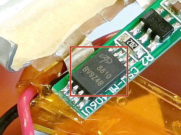

    • There is a protection circuit soldered on the battery, covered with a yellow translucent plastic wrapper. It has two components:
    • Marking code: 8810 BV9Z4B (?)
    • Marking code: G2GS (?)

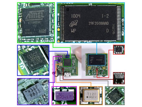

  7. ActiGraph GT3X-plus Teardown, Studying the PCB: crwdns2935265:07crwdnd2935265:01crwdnd2935265:03crwdne2935265:0 ActiGraph GT3X-plus Teardown, Studying the PCB: crwdns2935265:07crwdnd2935265:02crwdnd2935265:03crwdne2935265:0 ActiGraph GT3X-plus Teardown, Studying the PCB: crwdns2935265:07crwdnd2935265:03crwdnd2935265:03crwdne2935265:0

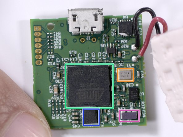

    • The PCB had important components on both sides. In the 3rd image, the purple component (416F 8835), the grey component (9301 FC), the brown component (65P) could not be identified. The following components were labelled, although some are unknown:
    • Micron MT29F2G08AAD (NAND Flash memory)
    • Ambient light sensors
    • Marking code: ".F". Possibly a logic gate
    • ATMEL ATSAM3U4C (Flash microcontroller)
    • Marking code: T120 AQ1V (A crystal oscillator)
    • Marking code: M934K7 (?)
    • KXSC7 1012B 2010 (Kionix (now ROHM)) MEMS Accelerometer (?)
