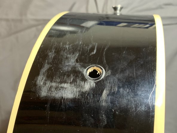

  6. Acoustic Bass Preamp Replacement: crwdns2935265:06crwdnd2935265:01crwdnd2935265:03crwdne2935265:0 Acoustic Bass Preamp Replacement: crwdns2935265:06crwdnd2935265:02crwdnd2935265:03crwdne2935265:0 Acoustic Bass Preamp Replacement: crwdns2935265:06crwdnd2935265:03crwdnd2935265:03crwdne2935265:0
    • Place the tuner over the area you removed the previous one from.
    • Scratch a line around the opening to the area of the bottom portion of the tuner.
    • Refer to the second image for a visual reference.
    • Ensure the scratched guideline is made to the parameter of the parts behind the face of the tuner.

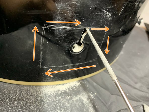

  7. Acoustic Bass Preamp Replacement: crwdns2935265:07crwdnd2935265:01crwdnd2935265:03crwdne2935265:0 Acoustic Bass Preamp Replacement: crwdns2935265:07crwdnd2935265:02crwdnd2935265:03crwdne2935265:0 Acoustic Bass Preamp Replacement: crwdns2935265:07crwdnd2935265:03crwdnd2935265:03crwdne2935265:0
    • Using a metal file, file up and down, following the outline.
    • Continue this, going around the outline until the desired opening is made.
    • This will most likely take quite a bit of time. If you have access to a small jab saw or similar power tool it will speed up the process.
    • Do this step ideally in a well-ventilated area as the wood shaving are small, and inhalation can cause harm or injury. Wear protective gear like a face mask, and goggles/eye protection to prevent injury or pain.

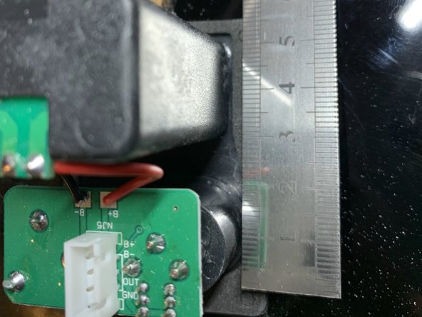

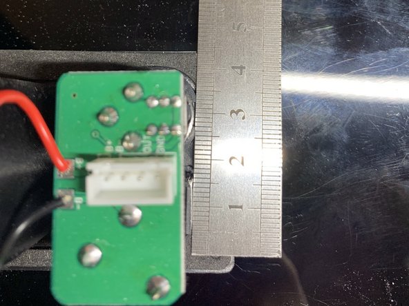

  8. Acoustic Bass Preamp Replacement: crwdns2935265:08crwdnd2935265:01crwdnd2935265:03crwdne2935265:0 Acoustic Bass Preamp Replacement: crwdns2935265:08crwdnd2935265:02crwdnd2935265:03crwdne2935265:0 Acoustic Bass Preamp Replacement: crwdns2935265:08crwdnd2935265:03crwdnd2935265:03crwdne2935265:0
    • Get your output platform and measure, with a ruler, the perimeter of the parts under the face with the screw holes.
    • The second and third images show the underside of the part, measuring around the internals.
    • Once you measure each side, jot them down for Step 9.

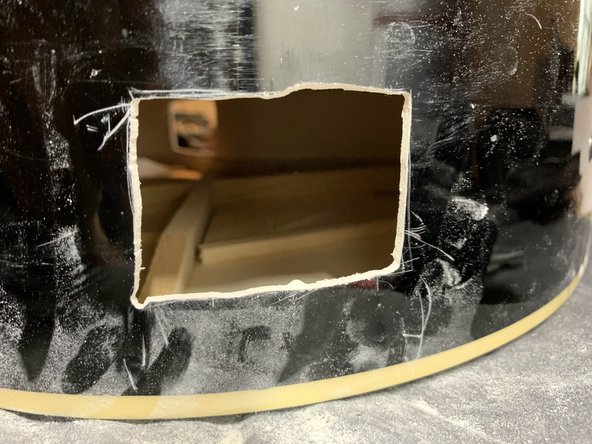

  10. Acoustic Bass Preamp Replacement: crwdns2935265:010crwdnd2935265:01crwdnd2935265:03crwdne2935265:0 Acoustic Bass Preamp Replacement: crwdns2935265:010crwdnd2935265:02crwdnd2935265:03crwdne2935265:0 Acoustic Bass Preamp Replacement: crwdns2935265:010crwdnd2935265:03crwdnd2935265:03crwdne2935265:0
    • Insert the file into the opening and file up until you reach the outline you traced.
    • Then follow the outline until the opening is completely cut out.
    • Do this step ideally in a well-ventilated area as the wood shaving are small, and you may inhale them.

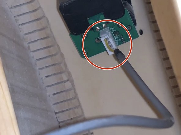

  14. Acoustic Bass Preamp Replacement: crwdns2935265:014crwdnd2935265:01crwdnd2935265:02crwdne2935265:0 Acoustic Bass Preamp Replacement: crwdns2935265:014crwdnd2935265:02crwdnd2935265:02crwdne2935265:0
    • Look for the preamp inside the bass. You will find a wire showed in the first image.
    • Stretch your arm into the bass to reach the output platform and find where you will need to plug the wire into.
    • Ensure the wire plugs in the right way and is firmly plugged in.
