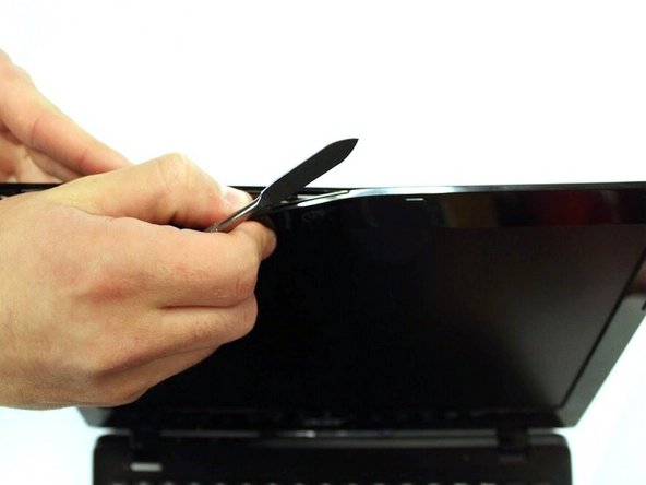

    • Use the metal spudger to pry open the front plastic cover of the screen.

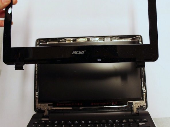

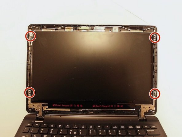

    • Take off the front plastic cover then remove four 6mm Phillips screws using the #0 screwdriver.

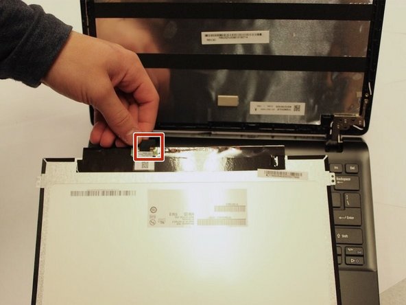

    • Flip the screen and disconnect the port.
  8. Acer TravelMate TMB115-M-C99B Screen Replacement: crwdns2935265:08crwdnd2935265:01crwdnd2935265:01crwdne2935265:0
    • Remove the screen.
