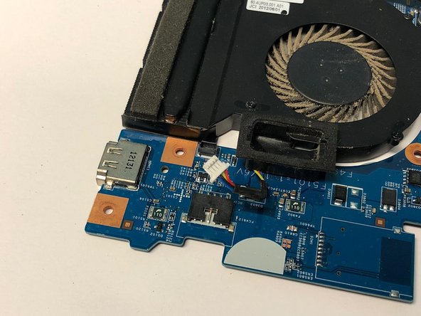

  25. Acer TravelMate P653-V-6882 Thermal Module Replacement, Thermal Module: crwdns2935265:025crwdnd2935265:01crwdnd2935265:02crwdne2935265:0 Acer TravelMate P653-V-6882 Thermal Module Replacement, Thermal Module: crwdns2935265:025crwdnd2935265:02crwdnd2935265:02crwdne2935265:0
    • Disconnect the thermal module fan cable from the mainboard by pulling the cable directly upwards.
    • Be careful not to damage the connector

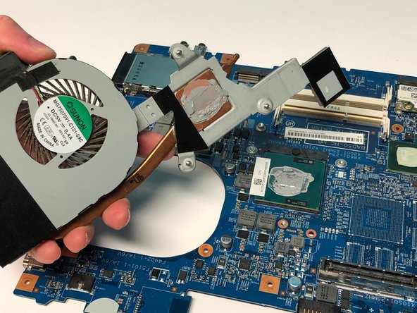

  26. Acer TravelMate P653-V-6882 Thermal Module Replacement: crwdns2935265:026crwdnd2935265:01crwdnd2935265:01crwdne2935265:0
    • Loosen the three spring loaded Phillips #1 screws.
  27. Acer TravelMate P653-V-6882 Thermal Module Replacement: crwdns2935265:027crwdnd2935265:01crwdnd2935265:02crwdne2935265:0 Acer TravelMate P653-V-6882 Thermal Module Replacement: crwdns2935265:027crwdnd2935265:02crwdnd2935265:02crwdne2935265:0
    • Lift the thermal module directly upwards
