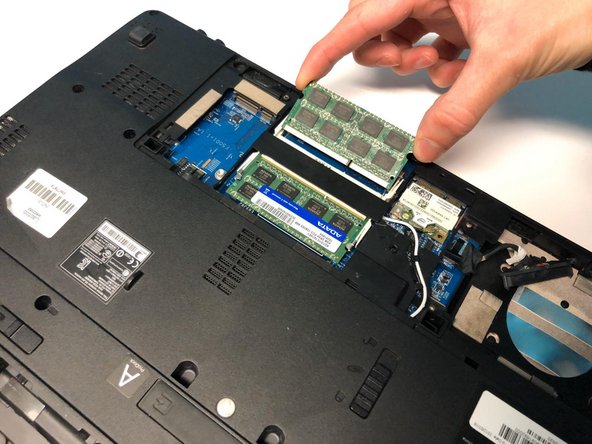

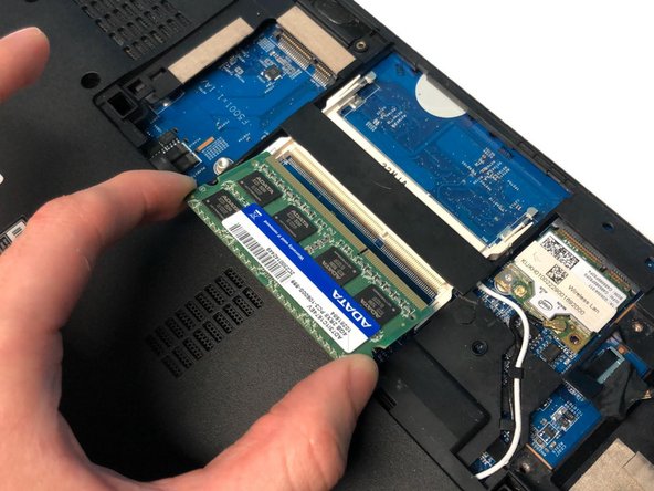

  7. Acer TravelMate P653-V-6882 RAM Replacement, RAM: crwdns2935265:07crwdnd2935265:01crwdnd2935265:01crwdne2935265:0
    • Locate the two RAM sticks on the bottom of the laptop.
  8. Acer TravelMate P653-V-6882 RAM Replacement: crwdns2935265:08crwdnd2935265:01crwdnd2935265:03crwdne2935265:0 Acer TravelMate P653-V-6882 RAM Replacement: crwdns2935265:08crwdnd2935265:02crwdnd2935265:03crwdne2935265:0 Acer TravelMate P653-V-6882 RAM Replacement: crwdns2935265:08crwdnd2935265:03crwdnd2935265:03crwdne2935265:0
    • Pinch the two metal pieces holding the RAM sticks in place outwards.
    • Holding the sides of the RAM, slide the RAM sticks out.
    • Be careful not to touch the gold connection pins on the RAM sticks, as this could damage the RAM
