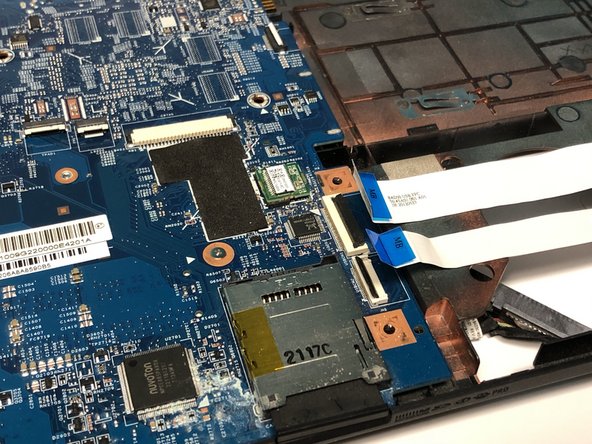

  13. Acer TravelMate P653-V-6882 LCD Module Replacement, Mainboard: crwdns2935265:013crwdnd2935265:01crwdnd2935265:03crwdne2935265:0 Acer TravelMate P653-V-6882 LCD Module Replacement, Mainboard: crwdns2935265:013crwdnd2935265:02crwdnd2935265:03crwdne2935265:0 Acer TravelMate P653-V-6882 LCD Module Replacement, Mainboard: crwdns2935265:013crwdnd2935265:03crwdnd2935265:03crwdne2935265:0
    • Turn the computer over, open the LCD panel, and find the smart card cable connector.
    • Open the smart card cable connector latch.
    • Disconnect the cable.
    • Be careful not to damage the connector.
  14. Acer TravelMate P653-V-6882 LCD Module Replacement: crwdns2935265:014crwdnd2935265:01crwdnd2935265:03crwdne2935265:0 Acer TravelMate P653-V-6882 LCD Module Replacement: crwdns2935265:014crwdnd2935265:02crwdnd2935265:03crwdne2935265:0 Acer TravelMate P653-V-6882 LCD Module Replacement: crwdns2935265:014crwdnd2935265:03crwdnd2935265:03crwdne2935265:0
    • Find the power button launch board cable connector.
    • Open the power button launch board cable connector latch.
  15. Acer TravelMate P653-V-6882 LCD Module Replacement: crwdns2935265:015crwdnd2935265:01crwdnd2935265:03crwdne2935265:0 Acer TravelMate P653-V-6882 LCD Module Replacement: crwdns2935265:015crwdnd2935265:02crwdnd2935265:03crwdne2935265:0 Acer TravelMate P653-V-6882 LCD Module Replacement: crwdns2935265:015crwdnd2935265:03crwdnd2935265:03crwdne2935265:0
    • Find the touchpad and fingerprint board cable connector.
    • Open the touchpad and fingerprint board cable connector’s latches.
    • Disconnect the cables.

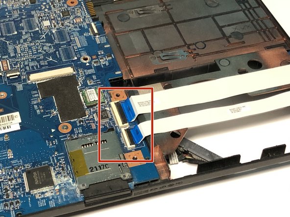

  21. Acer TravelMate P653-V-6882 LCD Module Replacement: crwdns2935265:021crwdnd2935265:01crwdnd2935265:03crwdne2935265:0 Acer TravelMate P653-V-6882 LCD Module Replacement: crwdns2935265:021crwdnd2935265:02crwdnd2935265:03crwdne2935265:0 Acer TravelMate P653-V-6882 LCD Module Replacement: crwdns2935265:021crwdnd2935265:03crwdnd2935265:03crwdne2935265:0
    • Open the USB board cable's connector latches.
    • Be careful not to damage the connectors.

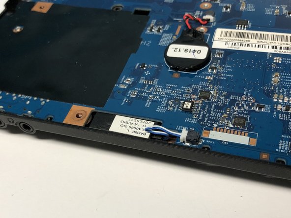

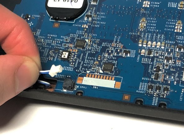

  22. Acer TravelMate P653-V-6882 LCD Module Replacement: crwdns2935265:022crwdnd2935265:01crwdnd2935265:03crwdne2935265:0 Acer TravelMate P653-V-6882 LCD Module Replacement: crwdns2935265:022crwdnd2935265:02crwdnd2935265:03crwdne2935265:0 Acer TravelMate P653-V-6882 LCD Module Replacement: crwdns2935265:022crwdnd2935265:03crwdnd2935265:03crwdne2935265:0
    • Disconnect the left speaker cable from the mainboard.

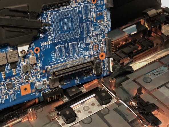

  24. Acer TravelMate P653-V-6882 LCD Module Replacement: crwdns2935265:024crwdnd2935265:01crwdnd2935265:02crwdne2935265:0 Acer TravelMate P653-V-6882 LCD Module Replacement: crwdns2935265:024crwdnd2935265:02crwdnd2935265:02crwdne2935265:0
    • Lift the mainboard at an angle and gently turn it on its side.
    • Disconnect the LAN cable from the mainboard.

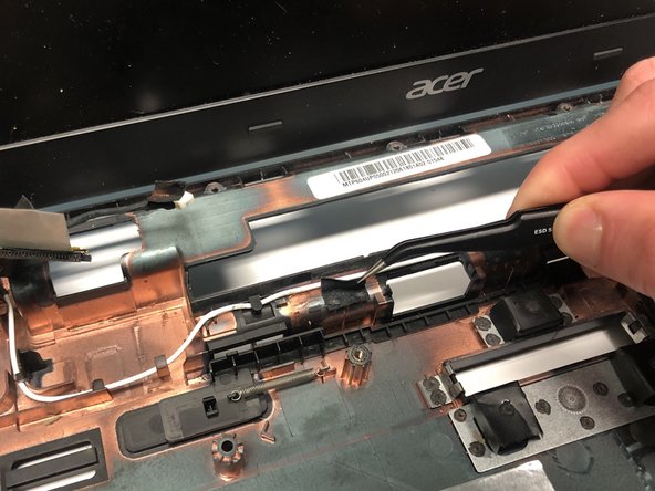

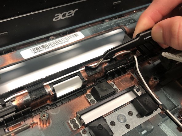

  25. Acer TravelMate P653-V-6882 LCD Module Replacement, LCD Module: crwdns2935265:025crwdnd2935265:01crwdnd2935265:03crwdne2935265:0 Acer TravelMate P653-V-6882 LCD Module Replacement, LCD Module: crwdns2935265:025crwdnd2935265:02crwdnd2935265:03crwdne2935265:0 Acer TravelMate P653-V-6882 LCD Module Replacement, LCD Module: crwdns2935265:025crwdnd2935265:03crwdnd2935265:03crwdne2935265:0
    • Carefully remove the two pieces of black tape securing the antenna cables to the lower case using tweezers.
  26. Acer TravelMate P653-V-6882 LCD Module Replacement: crwdns2935265:026crwdnd2935265:01crwdnd2935265:01crwdne2935265:0
    • Release the white antenna cable from its top side latches.
    • Be careful not to damage the cable.
  27. Acer TravelMate P653-V-6882 LCD Module Replacement: crwdns2935265:027crwdnd2935265:01crwdnd2935265:01crwdne2935265:0
    • Release the black antenna cable from its top side latches.
