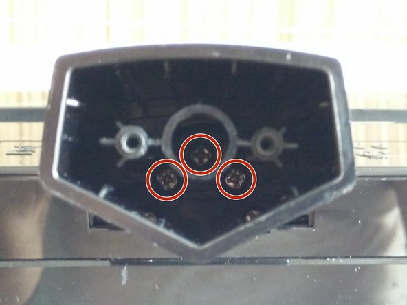

  2. Acer Thin Bezel Monitor Disassembly, Remove screws in IO panel: crwdns2935265:02crwdnd2935265:01crwdnd2935265:03crwdne2935265:0 Acer Thin Bezel Monitor Disassembly, Remove screws in IO panel: crwdns2935265:02crwdnd2935265:02crwdnd2935265:03crwdne2935265:0 Acer Thin Bezel Monitor Disassembly, Remove screws in IO panel: crwdns2935265:02crwdnd2935265:03crwdnd2935265:03crwdne2935265:0
    • There are 3 Phillips screws in IO panel
    • There are no screws behind the product label

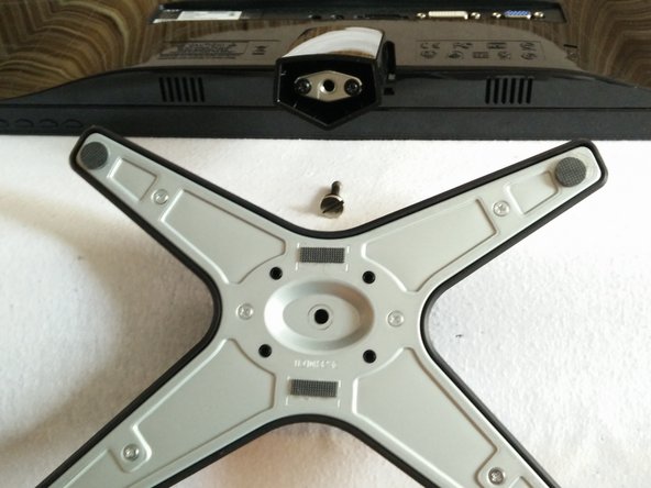

  3. Acer Thin Bezel Monitor Disassembly, Remove stand base: crwdns2935265:03crwdnd2935265:01crwdnd2935265:02crwdne2935265:0 Acer Thin Bezel Monitor Disassembly, Remove stand base: crwdns2935265:03crwdnd2935265:02crwdnd2935265:02crwdne2935265:0
    • The stand base is fixed by big flat head screw
    • No other screw needs to be removed

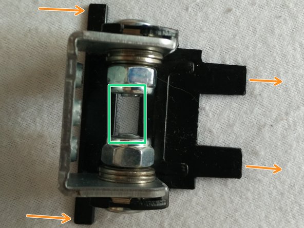

  4. Acer Thin Bezel Monitor Disassembly, Remove stand stem: crwdns2935265:04crwdnd2935265:01crwdnd2935265:03crwdne2935265:0 Acer Thin Bezel Monitor Disassembly, Remove stand stem: crwdns2935265:04crwdnd2935265:02crwdnd2935265:03crwdne2935265:0 Acer Thin Bezel Monitor Disassembly, Remove stand stem: crwdns2935265:04crwdnd2935265:03crwdnd2935265:03crwdne2935265:0
    • Remove the metal plate and be careful because the 2 Phillips screws are fixed to long plastic tubes that may crack when you apply too much torque
    • Behind the metal plate there are 3 Phillips screws
    • I highly recommend magnetic Phillips screwdriver with long thin neck for this step
    • Tilting mechanism will be revealed
  5. Acer Thin Bezel Monitor Disassembly, Remove tilting mechanism: crwdns2935265:05crwdnd2935265:01crwdnd2935265:03crwdne2935265:0 Acer Thin Bezel Monitor Disassembly, Remove tilting mechanism: crwdns2935265:05crwdnd2935265:02crwdnd2935265:03crwdne2935265:0 Acer Thin Bezel Monitor Disassembly, Remove tilting mechanism: crwdns2935265:05crwdnd2935265:03crwdnd2935265:03crwdne2935265:0
    • The tilting mechanism can be easily slide out when you gently push on the plastic lock clamp situated between/below the 2 bolts
    • Also remove the two long Phillips screws that are below the tilting mechanism to loosen the monitor's plastic back

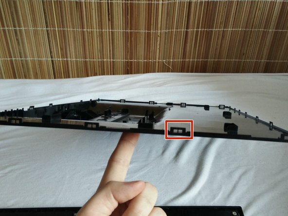

  6. Acer Thin Bezel Monitor Disassembly, Remove the monitor's back: crwdns2935265:06crwdnd2935265:01crwdnd2935265:03crwdne2935265:0 Acer Thin Bezel Monitor Disassembly, Remove the monitor's back: crwdns2935265:06crwdnd2935265:02crwdnd2935265:03crwdne2935265:0 Acer Thin Bezel Monitor Disassembly, Remove the monitor's back: crwdns2935265:06crwdnd2935265:03crwdnd2935265:03crwdne2935265:0
    • At this point the back is hold in place by over 20 plastic locks
    • Use your pry tool and screwdriver to loosen them all
    • Be careful and patient if you don't want to leave marks.
    • I recommend to start at the bottom (on the side without the monitor's control panel/buttons) and continue on the side, over the top to the other side of the bottom edge and carefully work around the control panel.

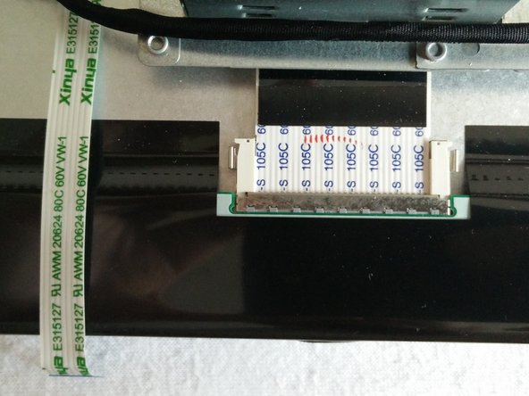

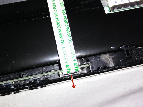

  7. Acer Thin Bezel Monitor Disassembly, Disconnect control panel: crwdns2935265:07crwdnd2935265:01crwdnd2935265:03crwdne2935265:0 Acer Thin Bezel Monitor Disassembly, Disconnect control panel: crwdns2935265:07crwdnd2935265:02crwdnd2935265:03crwdne2935265:0 Acer Thin Bezel Monitor Disassembly, Disconnect control panel: crwdns2935265:07crwdnd2935265:03crwdnd2935265:03crwdne2935265:0
    • Before we can remove the monitor's plastic side frame we have to disconnect the control panel
    • It is connected with single flat ribbon cable that is connected in clamp connector
    • Use a screwdriver to push on the clamp to open it and loosen the ribbon cable
    • Carefully remove the ribbon cable using a little force. You can wiggle the cable a little.
    • WARNING: try not to touch the monitors electronic to prevent any electric discharge.

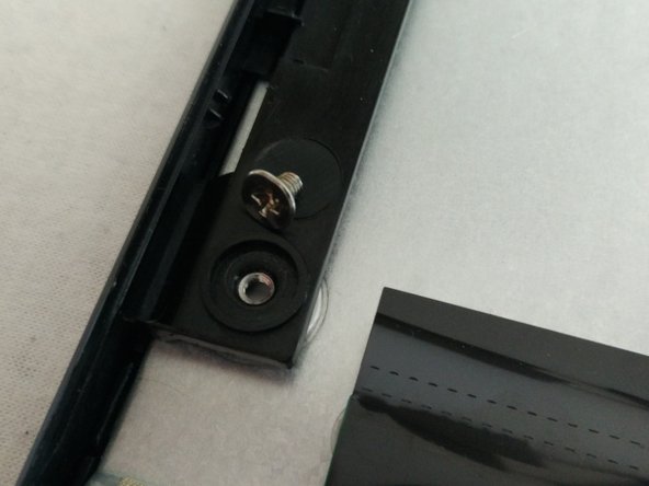

  8. Acer Thin Bezel Monitor Disassembly, Remove monitor's plastic frame: crwdns2935265:08crwdnd2935265:01crwdnd2935265:03crwdne2935265:0 Acer Thin Bezel Monitor Disassembly, Remove monitor's plastic frame: crwdns2935265:08crwdnd2935265:02crwdnd2935265:03crwdne2935265:0 Acer Thin Bezel Monitor Disassembly, Remove monitor's plastic frame: crwdns2935265:08crwdnd2935265:03crwdnd2935265:03crwdne2935265:0
    • Remove the screws in the plastic frame
    • Be careful around the cabling when you are removing the frame
    • Notice that the screws were screwed in with specific torque, try to remember the force you needed to unscrew them and reapply it on reassembly. Or at least don't use too much force on reassembly to prevent damage.
