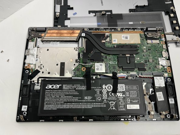

    • Use a T5 Torx screwdriver to remove the eleven screws that secure the lower case.
  2. Acer Swift X N20C12 Fan Replacement: crwdns2935265:02crwdnd2935265:01crwdnd2935265:01crwdne2935265:0
    • Insert an opening pick in the seam between the lower case and chassis.
    • Slide the pick around the perimeter while prying until the lower case releases.
    • Remove the lower case.

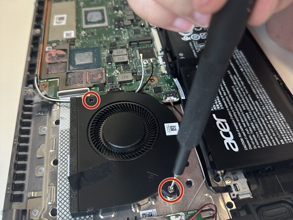

  3. Acer Swift X N20C12 Fan Replacement, Fan: crwdns2935265:03crwdnd2935265:01crwdnd2935265:01crwdne2935265:0
    • Use a Phillips #1 screwdriver to remove the two 5.9 mm screws that secure the fan.

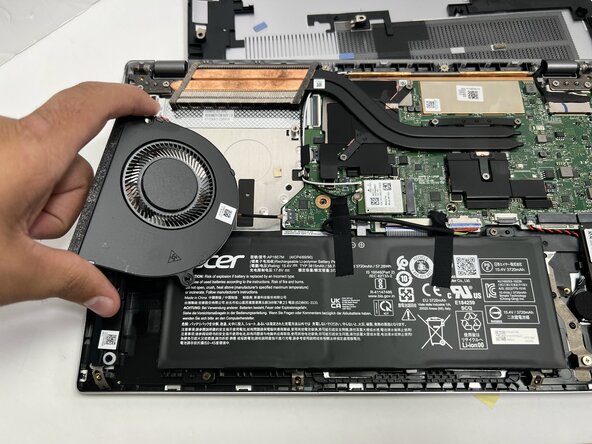

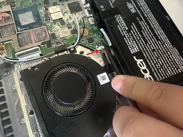

  4. Acer Swift X N20C12 Fan Replacement: crwdns2935265:04crwdnd2935265:01crwdnd2935265:03crwdne2935265:0 Acer Swift X N20C12 Fan Replacement: crwdns2935265:04crwdnd2935265:02crwdnd2935265:03crwdne2935265:0 Acer Swift X N20C12 Fan Replacement: crwdns2935265:04crwdnd2935265:03crwdnd2935265:03crwdne2935265:0
    • Use a spudger to pull the white fan connector directly out of its motherboard socket.
    • Lift the fan out of the chassis.
