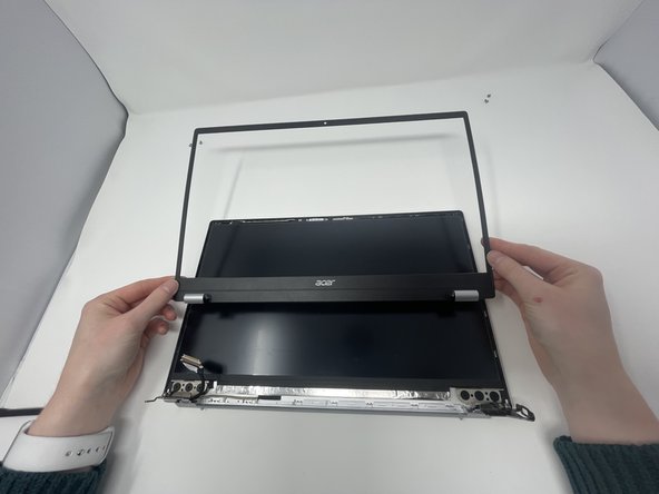

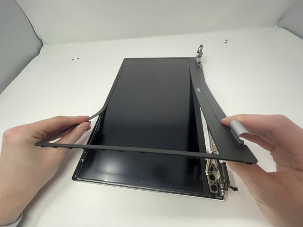

    • Insert the spudger between the computer screen and the black bezel.
    • Slide around the whole perimeter of screen.
    • Peel the bezel off.
  10. Acer Swift 3 2022 Screen Replacement: crwdns2935265:010crwdnd2935265:01crwdnd2935265:03crwdne2935265:0 Acer Swift 3 2022 Screen Replacement: crwdns2935265:010crwdnd2935265:02crwdnd2935265:03crwdne2935265:0 Acer Swift 3 2022 Screen Replacement: crwdns2935265:010crwdnd2935265:03crwdnd2935265:03crwdne2935265:0

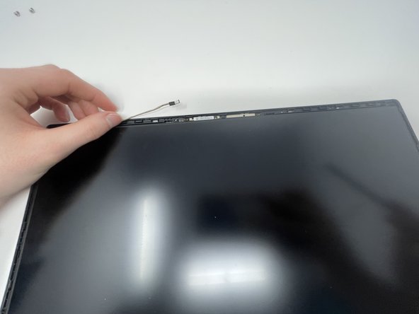

    • Disconnect the other end of the EDP Cable located next to the camera with the spudger.
  11. Acer Swift 3 2022 Screen Replacement: crwdns2935265:011crwdnd2935265:01crwdnd2935265:03crwdne2935265:0 Acer Swift 3 2022 Screen Replacement: crwdns2935265:011crwdnd2935265:02crwdnd2935265:03crwdne2935265:0 Acer Swift 3 2022 Screen Replacement: crwdns2935265:011crwdnd2935265:03crwdnd2935265:03crwdne2935265:0

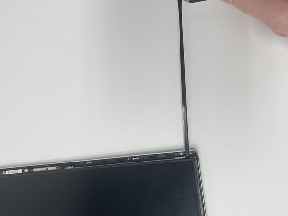

    • Using the curved, fine-tipped tweezers, unstick the tape from the top of the case.
    • Once the tape is unstuck, pinch it with the tweezers and pull in the opposite direction.
    • Repeat on the other side.
    • The tape will stretch. You might have to regrip it.
    • You may only do this once. The tape will no longer be effective.

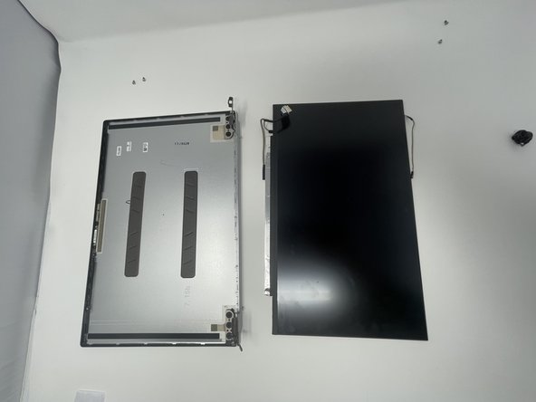

  12. Acer Swift 3 2022 Screen Replacement: crwdns2935265:012crwdnd2935265:01crwdnd2935265:01crwdne2935265:0
    • Remove screen.
    • There will be some wires connected to the bottom of the screen. Pull them out carefully with the screen.
