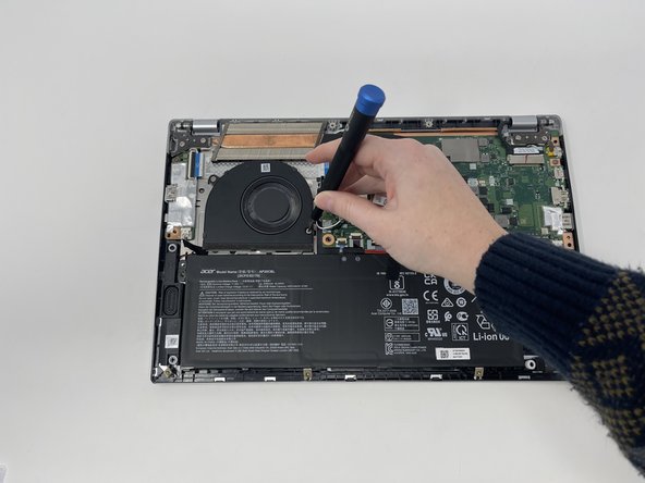

    • Be sure to power off the laptop before starting.
    • Flip the device over so the bottom panel is facing up.
  2. Acer Swift 3 2022 Fan Replacement: crwdns2935265:02crwdnd2935265:01crwdnd2935265:02crwdne2935265:0 Acer Swift 3 2022 Fan Replacement: crwdns2935265:02crwdnd2935265:02crwdnd2935265:02crwdne2935265:0
    • Remove the eleven 5 mm screws from the back of the device using a TR6 Torx screwdriver.
  3. Acer Swift 3 2022 Fan Replacement: crwdns2935265:03crwdnd2935265:01crwdnd2935265:01crwdne2935265:0
    • Use the iFixit opening tool to pry open the back of the device.
    • Remove the bottom cover from the laptop.
  4. Acer Swift 3 2022 Fan Replacement, How to Unplug the Battery: crwdns2935265:04crwdnd2935265:01crwdnd2935265:03crwdne2935265:0 Acer Swift 3 2022 Fan Replacement, How to Unplug the Battery: crwdns2935265:04crwdnd2935265:02crwdnd2935265:03crwdne2935265:0 Acer Swift 3 2022 Fan Replacement, How to Unplug the Battery: crwdns2935265:04crwdnd2935265:03crwdnd2935265:03crwdne2935265:0
    • Peel back the strip of black tape.
  5. Acer Swift 3 2022 Fan Replacement: crwdns2935265:05crwdnd2935265:01crwdnd2935265:02crwdne2935265:0 Acer Swift 3 2022 Fan Replacement: crwdns2935265:05crwdnd2935265:02crwdnd2935265:02crwdne2935265:0
    • Unplug the group of wires by pulling the white plastic piece towards yourself.
    • Be careful, this piece can be easily damaged.
  6. Acer Swift 3 2022 Fan Replacement, Fan: crwdns2935265:06crwdnd2935265:01crwdnd2935265:02crwdne2935265:0 Acer Swift 3 2022 Fan Replacement, Fan: crwdns2935265:06crwdnd2935265:02crwdnd2935265:02crwdne2935265:0
    • Remove the two 4.5 mm screws from the fan using a Phillips #00 screwdriver.
  7. Acer Swift 3 2022 Fan Replacement: crwdns2935265:07crwdnd2935265:01crwdnd2935265:02crwdne2935265:0 Acer Swift 3 2022 Fan Replacement: crwdns2935265:07crwdnd2935265:02crwdnd2935265:02crwdne2935265:0
    • Lift the metal clip using the iFixit opening tool to release the wire.
  8. Acer Swift 3 2022 Fan Replacement: crwdns2935265:08crwdnd2935265:01crwdnd2935265:03crwdne2935265:0 Acer Swift 3 2022 Fan Replacement: crwdns2935265:08crwdnd2935265:02crwdnd2935265:03crwdne2935265:0 Acer Swift 3 2022 Fan Replacement: crwdns2935265:08crwdnd2935265:03crwdnd2935265:03crwdne2935265:0
    • Unplug the wires by pulling gently on the white plastic.
  9. Acer Swift 3 2022 Fan Replacement: crwdns2935265:09crwdnd2935265:01crwdnd2935265:01crwdne2935265:0
    • Remove fan.

Correction. The fan should face the other way around - with the vent into the radiators of the heatsink. If the fan is placed incorrectly, overheating will occur.
Yehor - crwdns2934203:0crwdne2934203:0
Yup, the flat bit of the fan goes to the outside of the laptop....... through the cooling grill, not the battery!
Sarah Cartwright - crwdns2934203:0crwdne2934203:0
