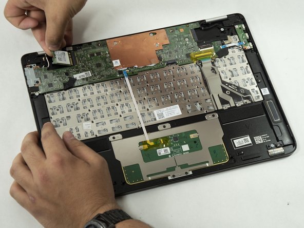

    • Turn the laptop so that the back cover is visible and facing you. Make sure it is on a flat surface, such as a table.
    • Using a standard PH0 Phillips-head screwdriver, work your way around the edge removing the 6mm screws along the way.
    • Once all the screws are removed, you should easily be able to remove the back cover. This can be done by hand or by using a Spudger as seen in the tools list.
    • Once the back cover is removed, make sure you disconnect the battery cable.
  2. Acer Spin 7 SP714-51 Wi-Fi Card Replacement: crwdns2935265:02crwdnd2935265:01crwdnd2935265:01crwdne2935265:0
    • Disconnect the white and black antennae from the Wi-Fi card.
    • The Wi-Fi card is located on the left side of the laptop when it is flipped to see the bottom of the laptop.
    • The antennae should snap off upwards easily with a pry tool so the antennae and Wi-Fi card no longer connect.
  3. Acer Spin 7 SP714-51 Wi-Fi Card Replacement: crwdns2935265:03crwdnd2935265:01crwdnd2935265:02crwdne2935265:0 Acer Spin 7 SP714-51 Wi-Fi Card Replacement: crwdns2935265:03crwdnd2935265:02crwdnd2935265:02crwdne2935265:0
    • Use a Phillips #0 screwdriver to remove the 6 mm retaining screw from the Wi-Fi card, and carefully pull the card free to remove it from the laptop.
