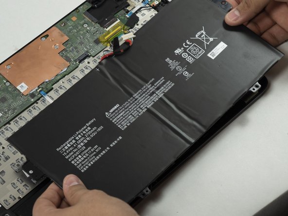

  4. Acer Spin 7 SP714-51 Trackpad Replacement: crwdns2935265:04crwdnd2935265:01crwdnd2935265:02crwdne2935265:0 Acer Spin 7 SP714-51 Trackpad Replacement: crwdns2935265:04crwdnd2935265:02crwdnd2935265:02crwdne2935265:0
    • Use a Phillips #0 screwdriver to remove the last two 3mm long fasteners at the edge of the laptop body, and carefully remove the battery.
    • Place the new battery in the battery slot
    • Do not bend or puncture the battery.

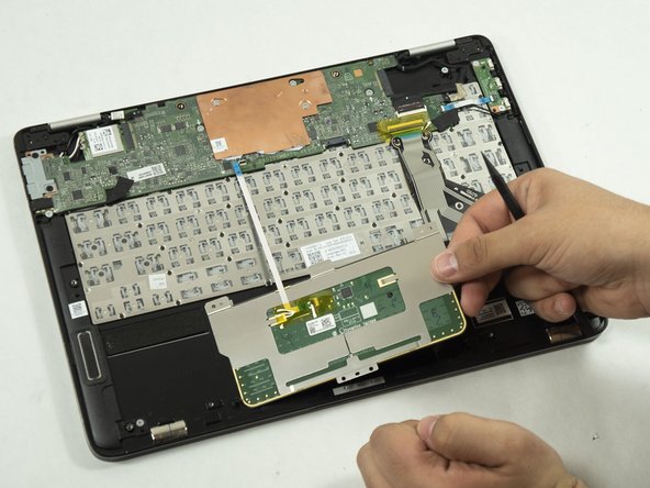

  5. Acer Spin 7 SP714-51 Trackpad Replacement, Trackpad: crwdns2935265:05crwdnd2935265:01crwdnd2935265:01crwdne2935265:0
    • Use your fingernail or another small pry tool to gently pry up the black locking tab on the ribbon cable connector, then slide the ribbon cable out gently holding the blue tab attached to the cable.
    • Take great care not to damage the ribbon cable or the cable connector.
  6. Acer Spin 7 SP714-51 Trackpad Replacement: crwdns2935265:06crwdnd2935265:01crwdnd2935265:02crwdne2935265:0 Acer Spin 7 SP714-51 Trackpad Replacement: crwdns2935265:06crwdnd2935265:02crwdnd2935265:02crwdne2935265:0
    • Use a Phillips #000 screwdriver to remove the five 2mm screws from the back of the trackpad, then carefully remove the trackpad and set it aside.
