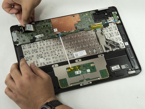

    • Disconnect the white and black antennae from the Wi-Fi card, located on the left side of the laptop. The antennae should snap off upwards easily with a pry tool.
    • Unscrew the retaining screw from the Wi-Fi card and unslot the card to remove it from the laptop.

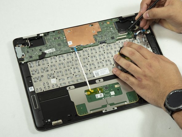

    • Flip up the tab on the keyboard connector and disconnect the ribbon cable from the motherboard.
  8. Acer Spin 7 SP714-51 Keyboard Replacement: crwdns2935265:08crwdnd2935265:01crwdnd2935265:03crwdne2935265:0 Acer Spin 7 SP714-51 Keyboard Replacement: crwdns2935265:08crwdnd2935265:02crwdnd2935265:03crwdne2935265:0 Acer Spin 7 SP714-51 Keyboard Replacement: crwdns2935265:08crwdnd2935265:03crwdnd2935265:03crwdne2935265:0
    • Remove the display connector by lifting the tape and pulling the connector straight back.
    • Remove the trackpad ribbon cable.
    • Remove the speaker connectors, lifting the tape and pulling straight back from the connector.

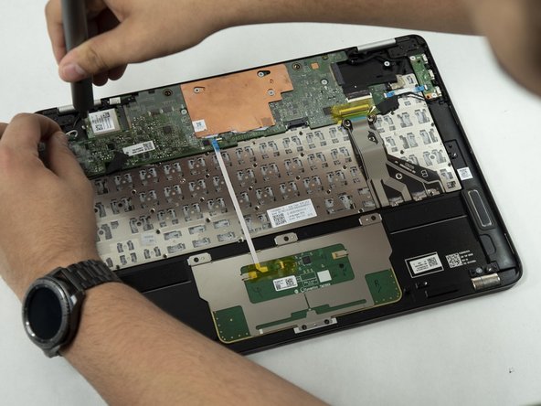

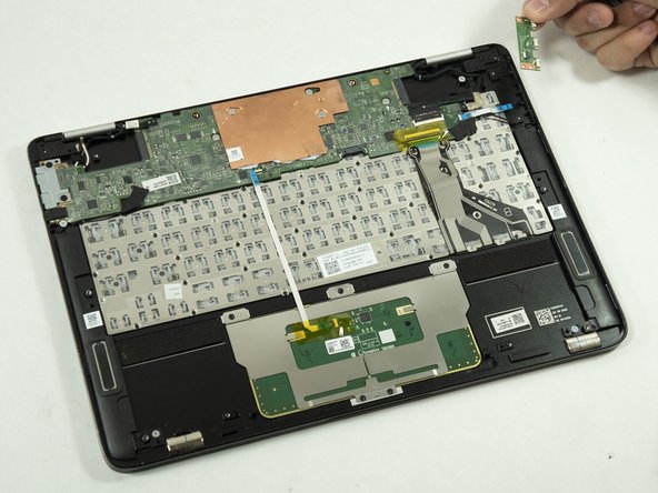

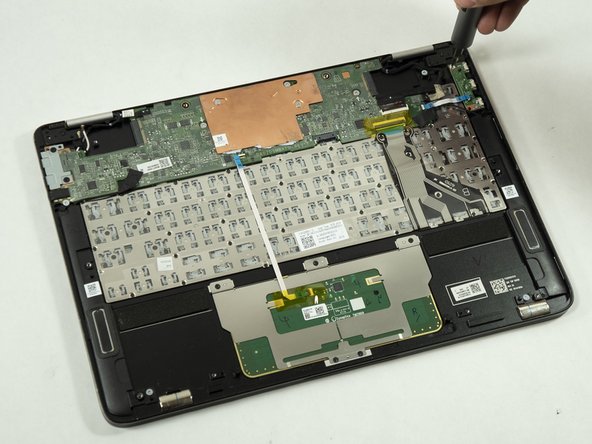

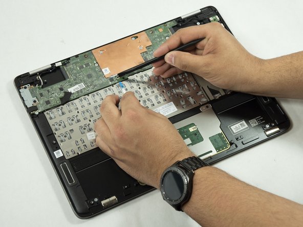

    • On the upper left side of the back panel is a protective shield for the USB-C panel. Remove the two 3mm screws holding the panel in place using the PH0 Phillips head screwdriver.
    • Gently pull the panel away being careful not to damage anything.
  11. Acer Spin 7 SP714-51 Keyboard Replacement: crwdns2935265:011crwdnd2935265:01crwdnd2935265:02crwdne2935265:0 Acer Spin 7 SP714-51 Keyboard Replacement: crwdns2935265:011crwdnd2935265:02crwdnd2935265:02crwdne2935265:0

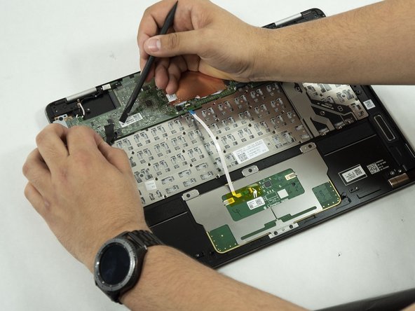

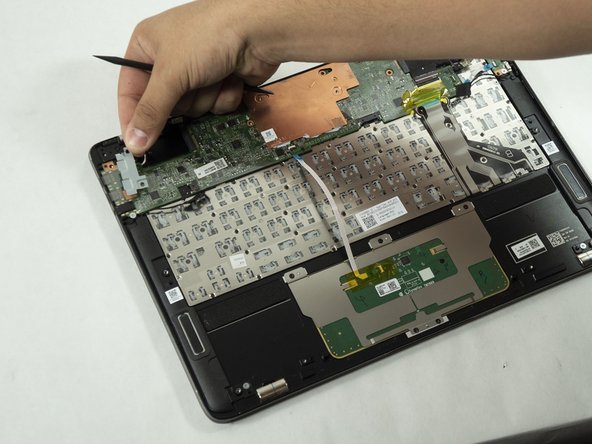

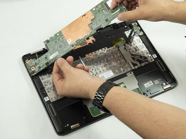

    • Unscrew the silver 3mm long screws holding the motherboard using the PH0 bit and remove them carefully to avoid breaking them.
    • This will allow the user to get to the keyboard without any other parts in the way making it easier to work with.

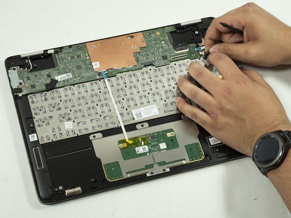

  12. Acer Spin 7 SP714-51 Keyboard Replacement: crwdns2935265:012crwdnd2935265:01crwdnd2935265:01crwdne2935265:0
    • Partially covering the keyboard is a heatsink, grab the two edges as seen in the photo.
    • Carefully pull away the heatsink to gain access to the keyboard.

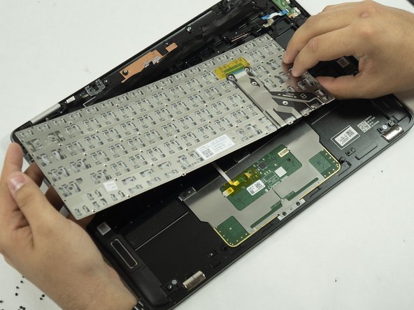

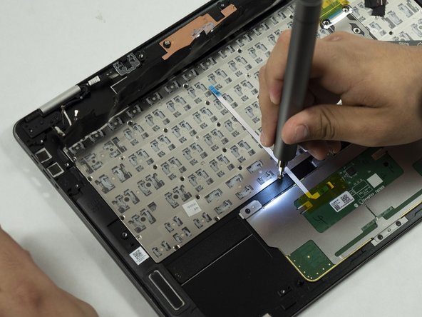

    • Use a Phillips #000 screwdriver to remove the 2 mm screws that secure the keyboard in place, and carefully remove the keyboard to avoid breaking it.
