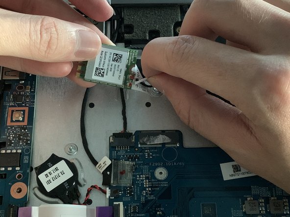

  9. Acer Spin 5 SP515-51GN-807G Wireless (WiFi) Card Replacement: crwdns2935265:09crwdnd2935265:01crwdnd2935265:03crwdne2935265:0 Acer Spin 5 SP515-51GN-807G Wireless (WiFi) Card Replacement: crwdns2935265:09crwdnd2935265:02crwdnd2935265:03crwdne2935265:0 Acer Spin 5 SP515-51GN-807G Wireless (WiFi) Card Replacement: crwdns2935265:09crwdnd2935265:03crwdnd2935265:03crwdne2935265:0
    • Using your fingers, carefully pull the white wire upwards, removing it from the terminal of the wireless card.
  10. Acer Spin 5 SP515-51GN-807G Wireless (WiFi) Card Replacement: crwdns2935265:010crwdnd2935265:01crwdnd2935265:02crwdne2935265:0 Acer Spin 5 SP515-51GN-807G Wireless (WiFi) Card Replacement: crwdns2935265:010crwdnd2935265:02crwdnd2935265:02crwdne2935265:0
    • Repeat the previous step but this time for the black wire.

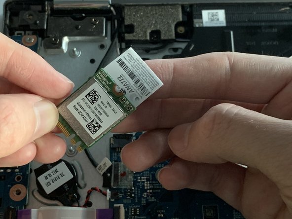

  11. Acer Spin 5 SP515-51GN-807G Wireless (WiFi) Card Replacement: crwdns2935265:011crwdnd2935265:01crwdnd2935265:02crwdne2935265:0 Acer Spin 5 SP515-51GN-807G Wireless (WiFi) Card Replacement: crwdns2935265:011crwdnd2935265:02crwdnd2935265:02crwdne2935265:0
    • Remove the wireless (WiFi) card from the laptop.
