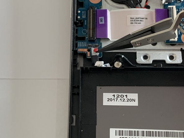

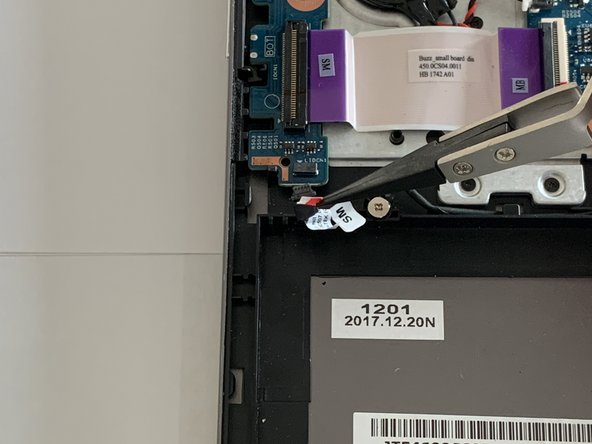

    • Using tweezers, carefully grip the sensor cable by the white and red tab.
    • Using gentle pressure, remove the cable from its connection by pulling outward.

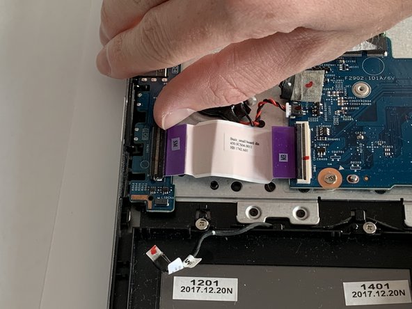

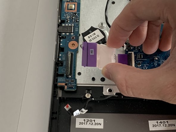

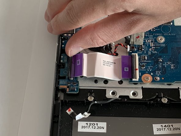

    • Place your fingernail underneath the locking black tab of the ZIF connector on the USB/Side Port Board and pry it upwards to release the cable.
  11. Acer Spin 5 SP515-51GN-807G Side Port and Button Replacement: crwdns2935265:011crwdnd2935265:01crwdnd2935265:02crwdne2935265:0 Acer Spin 5 SP515-51GN-807G Side Port and Button Replacement: crwdns2935265:011crwdnd2935265:02crwdnd2935265:02crwdne2935265:0
    • Remove the ribbon interconnect cable from the connector.
