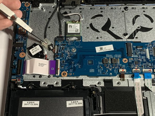

  4. Acer Spin 5 SP515-51GN-807G Motherboard Replacement, Battery: crwdns2935265:04crwdnd2935265:01crwdnd2935265:03crwdne2935265:0 Acer Spin 5 SP515-51GN-807G Motherboard Replacement, Battery: crwdns2935265:04crwdnd2935265:02crwdnd2935265:03crwdne2935265:0 Acer Spin 5 SP515-51GN-807G Motherboard Replacement, Battery: crwdns2935265:04crwdnd2935265:03crwdnd2935265:03crwdne2935265:0
    • Using tweezers, remove the piece of black tape over the battery cable connector.

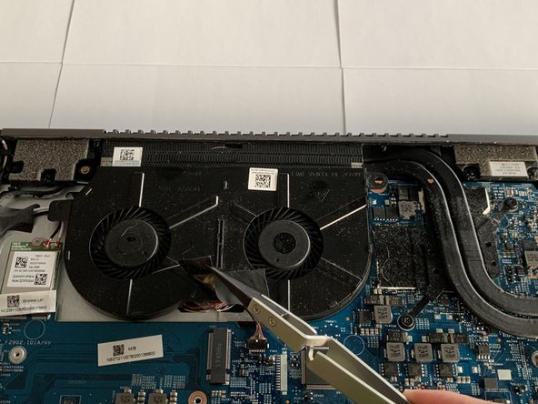

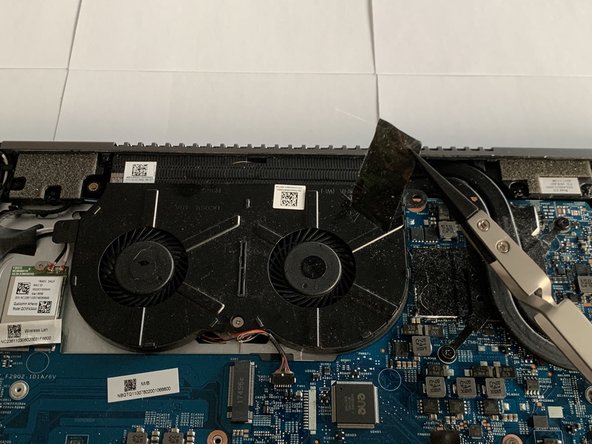

  9. Acer Spin 5 SP515-51GN-807G Motherboard Replacement, Fan: crwdns2935265:09crwdnd2935265:01crwdnd2935265:03crwdne2935265:0 Acer Spin 5 SP515-51GN-807G Motherboard Replacement, Fan: crwdns2935265:09crwdnd2935265:02crwdnd2935265:03crwdne2935265:0 Acer Spin 5 SP515-51GN-807G Motherboard Replacement, Fan: crwdns2935265:09crwdnd2935265:03crwdnd2935265:03crwdne2935265:0
    • Remove the piece of tape covering the fan screw using a pair of tweezers.
    • This can also be done using your fingernail.

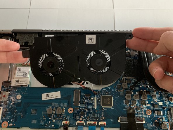

  12. Acer Spin 5 SP515-51GN-807G Motherboard Replacement: crwdns2935265:012crwdnd2935265:01crwdnd2935265:02crwdne2935265:0 Acer Spin 5 SP515-51GN-807G Motherboard Replacement: crwdns2935265:012crwdnd2935265:02crwdnd2935265:02crwdne2935265:0
    • Grip the fan with your fingers by the edges and lift up to remove the fan.

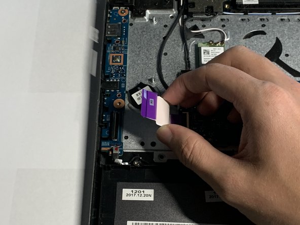

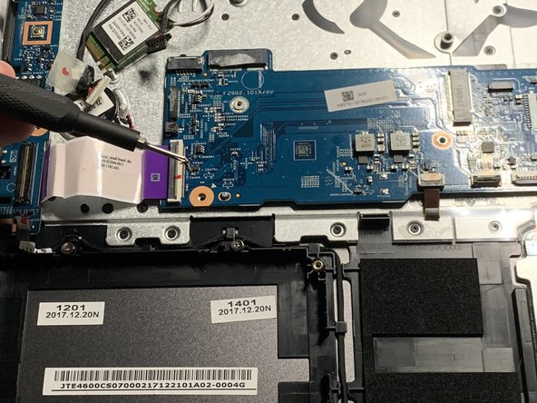

  13. Acer Spin 5 SP515-51GN-807G Motherboard Replacement, Motherboard: crwdns2935265:013crwdnd2935265:01crwdnd2935265:03crwdne2935265:0 Acer Spin 5 SP515-51GN-807G Motherboard Replacement, Motherboard: crwdns2935265:013crwdnd2935265:02crwdnd2935265:03crwdne2935265:0 Acer Spin 5 SP515-51GN-807G Motherboard Replacement, Motherboard: crwdns2935265:013crwdnd2935265:03crwdnd2935265:03crwdne2935265:0

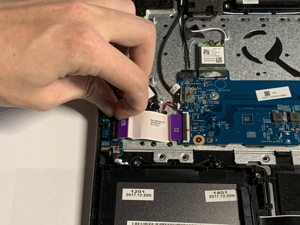

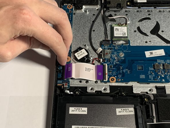

    • Place your fingernail underneath the locking tab of the ZIF connector holding the interconnect cable on the USB/Side Port board.
    • Lift the black clamp upwards to release the cable.
  14. Acer Spin 5 SP515-51GN-807G Motherboard Replacement: crwdns2935265:014crwdnd2935265:01crwdnd2935265:02crwdne2935265:0 Acer Spin 5 SP515-51GN-807G Motherboard Replacement: crwdns2935265:014crwdnd2935265:02crwdnd2935265:02crwdne2935265:0
    • Pull the USB/Side Port Board cable away from the port.

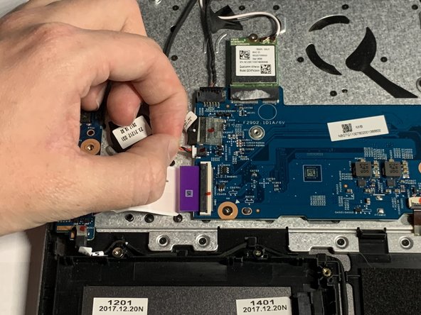

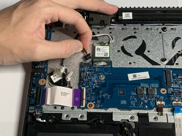

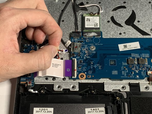

  15. Acer Spin 5 SP515-51GN-807G Motherboard Replacement: crwdns2935265:015crwdnd2935265:01crwdnd2935265:03crwdne2935265:0 Acer Spin 5 SP515-51GN-807G Motherboard Replacement: crwdns2935265:015crwdnd2935265:02crwdnd2935265:03crwdne2935265:0 Acer Spin 5 SP515-51GN-807G Motherboard Replacement: crwdns2935265:015crwdnd2935265:03crwdnd2935265:03crwdne2935265:0

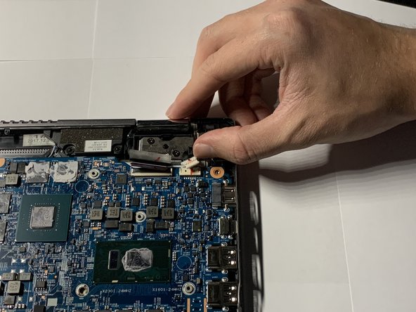

    • Firmly grasp the cable that connects the speakers to the motherboard.
    • Gently pull the cable away from the motherboard.

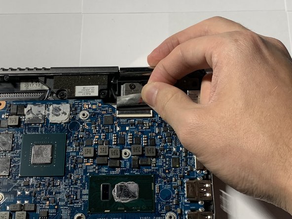

    • Peel back the tape covering the cable port.
    • This step can be completed using either your fingernails or a set of tweezers.

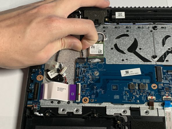

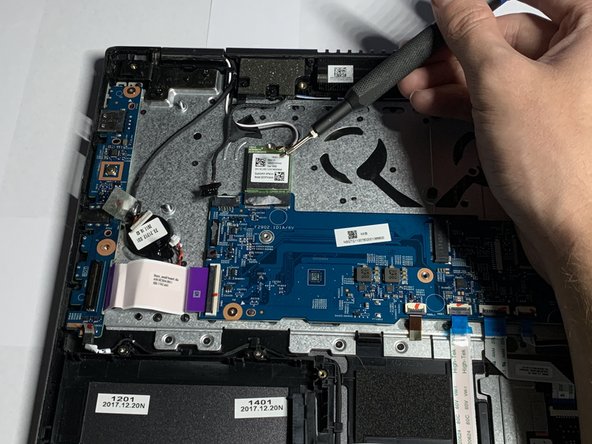

  19. Acer Spin 5 SP515-51GN-807G Motherboard Replacement: crwdns2935265:019crwdnd2935265:01crwdnd2935265:02crwdne2935265:0 Acer Spin 5 SP515-51GN-807G Motherboard Replacement: crwdns2935265:019crwdnd2935265:02crwdnd2935265:02crwdne2935265:0
    • Remove the one 3.5mm screw that secures the wireless card using a Phillips #00 screwdriver (PH00 bit).
  20. Acer Spin 5 SP515-51GN-807G Motherboard Replacement: crwdns2935265:020crwdnd2935265:01crwdnd2935265:02crwdne2935265:0 Acer Spin 5 SP515-51GN-807G Motherboard Replacement: crwdns2935265:020crwdnd2935265:02crwdnd2935265:02crwdne2935265:0
    • Gently pull the wireless card away from the motherboard.

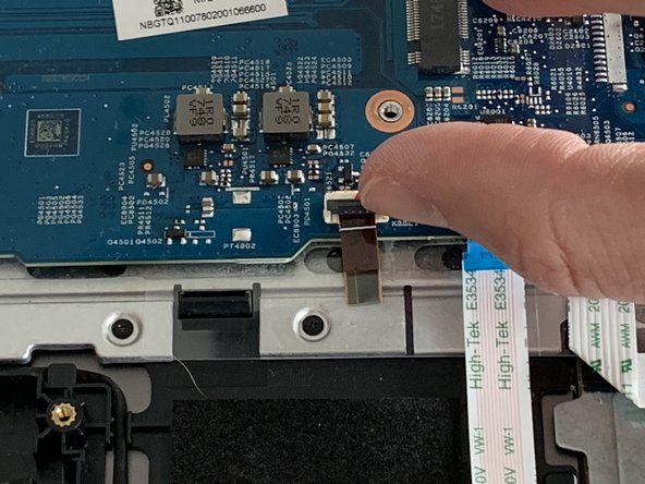

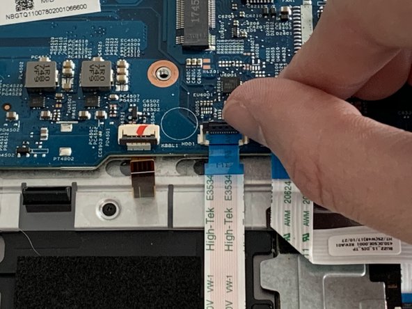

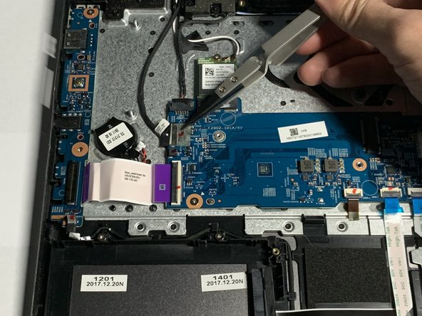

  21. Acer Spin 5 SP515-51GN-807G Motherboard Replacement: crwdns2935265:021crwdnd2935265:01crwdnd2935265:03crwdne2935265:0 Acer Spin 5 SP515-51GN-807G Motherboard Replacement: crwdns2935265:021crwdnd2935265:02crwdnd2935265:03crwdne2935265:0 Acer Spin 5 SP515-51GN-807G Motherboard Replacement: crwdns2935265:021crwdnd2935265:03crwdnd2935265:03crwdne2935265:0
    • Place your fingernail underneath the black tab which secures the cable in the ZIF connector.
    • Lift the black tab upwards to release the cable.

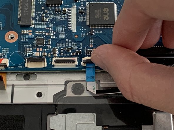

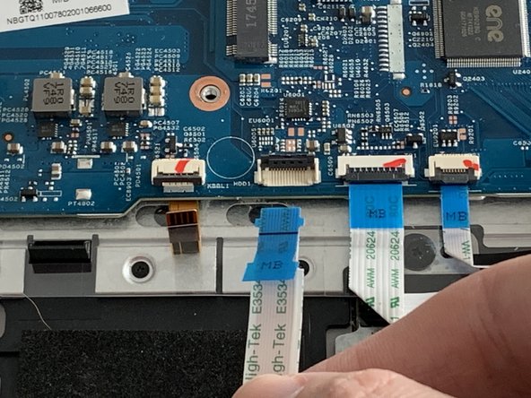

  22. Acer Spin 5 SP515-51GN-807G Motherboard Replacement: crwdns2935265:022crwdnd2935265:01crwdnd2935265:03crwdne2935265:0 Acer Spin 5 SP515-51GN-807G Motherboard Replacement: crwdns2935265:022crwdnd2935265:02crwdnd2935265:03crwdne2935265:0 Acer Spin 5 SP515-51GN-807G Motherboard Replacement: crwdns2935265:022crwdnd2935265:03crwdnd2935265:03crwdne2935265:0

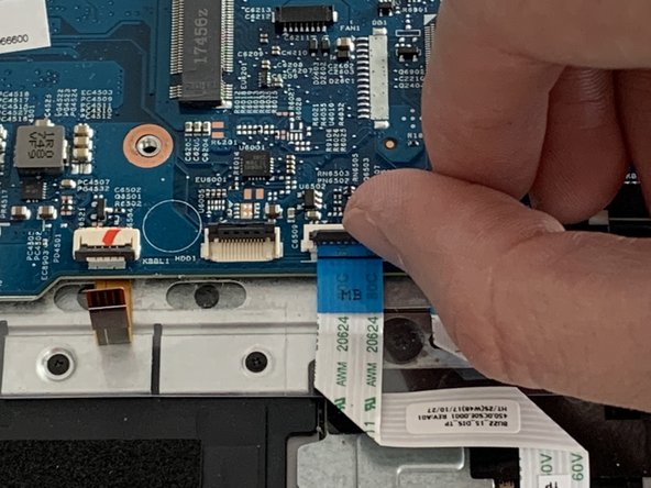

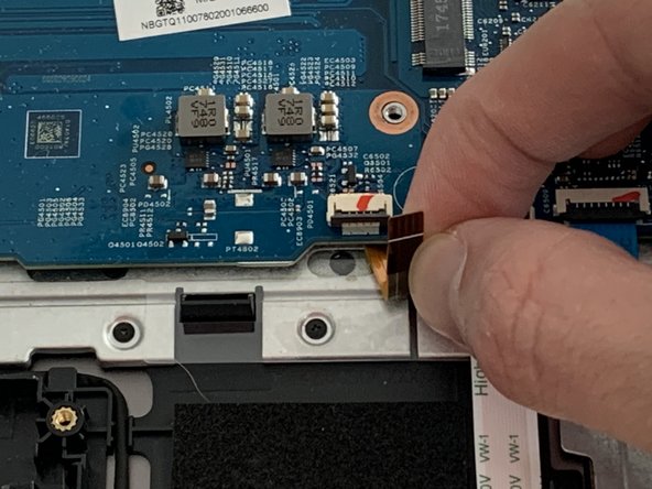

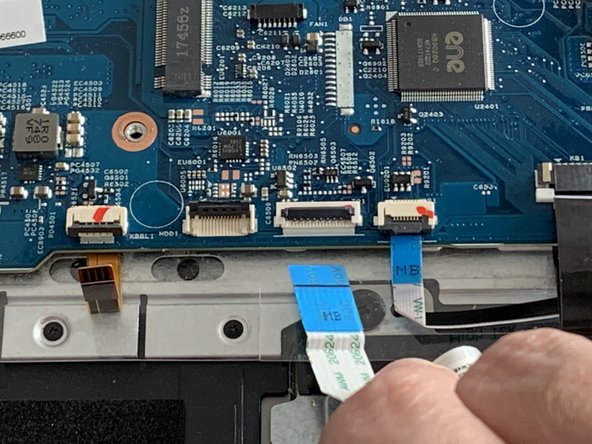

  23. Acer Spin 5 SP515-51GN-807G Motherboard Replacement: crwdns2935265:023crwdnd2935265:01crwdnd2935265:03crwdne2935265:0 Acer Spin 5 SP515-51GN-807G Motherboard Replacement: crwdns2935265:023crwdnd2935265:02crwdnd2935265:03crwdne2935265:0 Acer Spin 5 SP515-51GN-807G Motherboard Replacement: crwdns2935265:023crwdnd2935265:03crwdnd2935265:03crwdne2935265:0
    • Place your fingernail underneath the black clamp which secures the cable.

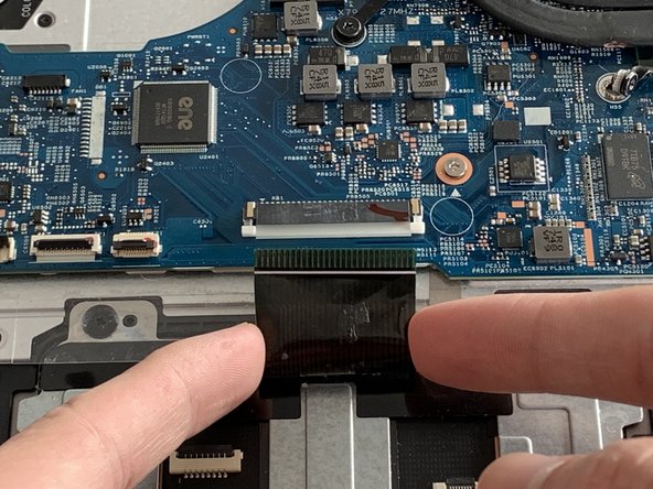

  24. Acer Spin 5 SP515-51GN-807G Motherboard Replacement: crwdns2935265:024crwdnd2935265:01crwdnd2935265:03crwdne2935265:0 Acer Spin 5 SP515-51GN-807G Motherboard Replacement: crwdns2935265:024crwdnd2935265:02crwdnd2935265:03crwdne2935265:0 Acer Spin 5 SP515-51GN-807G Motherboard Replacement: crwdns2935265:024crwdnd2935265:03crwdnd2935265:03crwdne2935265:0

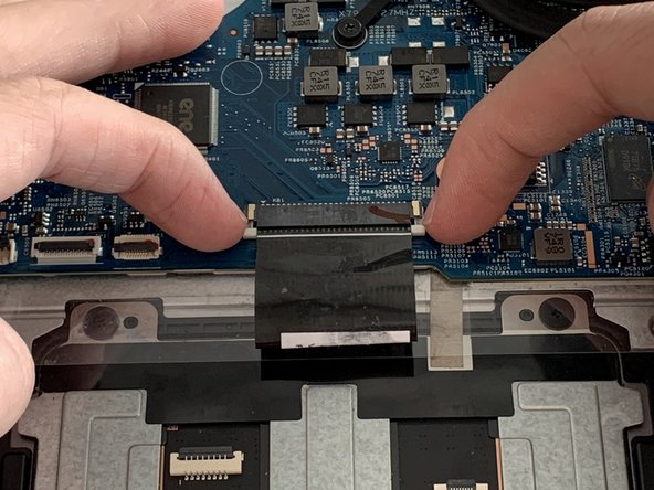

  25. Acer Spin 5 SP515-51GN-807G Motherboard Replacement: crwdns2935265:025crwdnd2935265:01crwdnd2935265:03crwdne2935265:0 Acer Spin 5 SP515-51GN-807G Motherboard Replacement: crwdns2935265:025crwdnd2935265:02crwdnd2935265:03crwdne2935265:0 Acer Spin 5 SP515-51GN-807G Motherboard Replacement: crwdns2935265:025crwdnd2935265:03crwdnd2935265:03crwdne2935265:0
    • Grip the two white clamps on each side of the cable with your fingernails and pull away from the motherboard to release the cable.

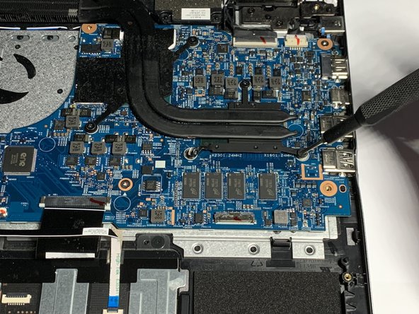

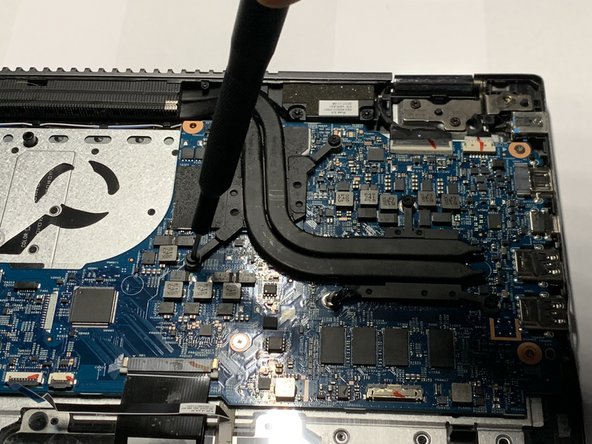

  26. Acer Spin 5 SP515-51GN-807G Motherboard Replacement: crwdns2935265:026crwdnd2935265:01crwdnd2935265:03crwdne2935265:0 Acer Spin 5 SP515-51GN-807G Motherboard Replacement: crwdns2935265:026crwdnd2935265:02crwdnd2935265:03crwdne2935265:0 Acer Spin 5 SP515-51GN-807G Motherboard Replacement: crwdns2935265:026crwdnd2935265:03crwdnd2935265:03crwdne2935265:0

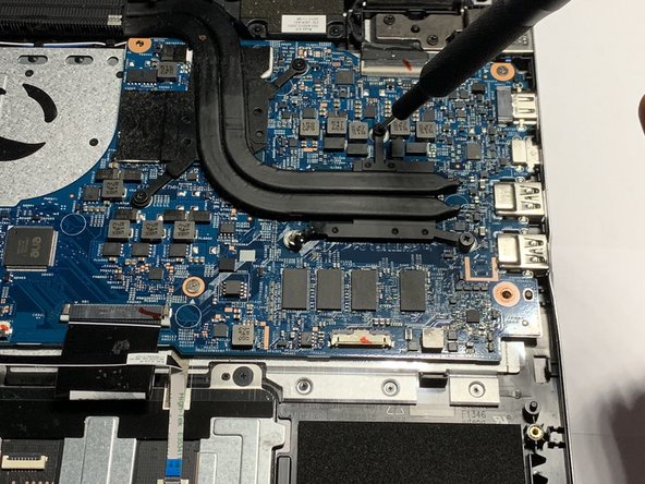

    • Remove the three 3.5mm screws that secure the heatsink using a Phillips #00 screwdriver (PH00 bit).
  27. Acer Spin 5 SP515-51GN-807G Motherboard Replacement: crwdns2935265:027crwdnd2935265:01crwdnd2935265:02crwdne2935265:0 Acer Spin 5 SP515-51GN-807G Motherboard Replacement: crwdns2935265:027crwdnd2935265:02crwdnd2935265:02crwdne2935265:0
    • Remove the two 3.5mm screws that secure the heatsink using a Phillips #00 screwdriver (PH00 bit).

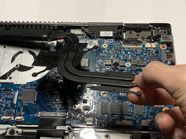

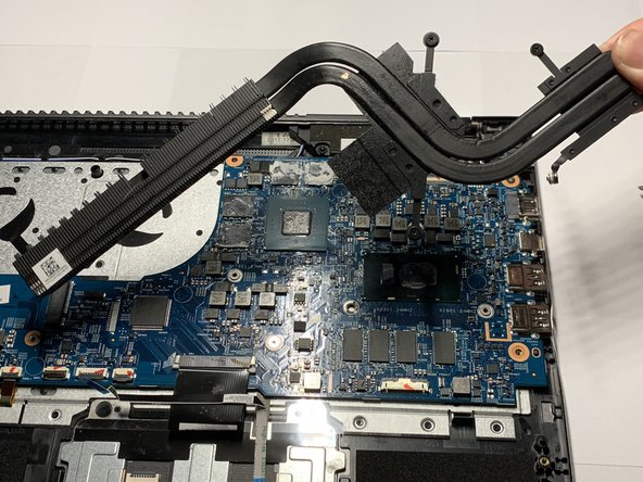

  28. Acer Spin 5 SP515-51GN-807G Motherboard Replacement: crwdns2935265:028crwdnd2935265:01crwdnd2935265:03crwdne2935265:0 Acer Spin 5 SP515-51GN-807G Motherboard Replacement: crwdns2935265:028crwdnd2935265:02crwdnd2935265:03crwdne2935265:0 Acer Spin 5 SP515-51GN-807G Motherboard Replacement: crwdns2935265:028crwdnd2935265:03crwdnd2935265:03crwdne2935265:0
    • Lift the heat-sink unit upwards and remove it from motherboard.
    • Do not power on your laptop with the heat-sink unit removed as this will cause heat damage to your processor.
    • When removing a heat-sink unit from the processor (CPU), follow the steps on Applying Thermal Paste before reinstalling the heat-sink and powering on the device.

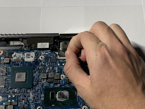

  29. Acer Spin 5 SP515-51GN-807G Motherboard Replacement: crwdns2935265:029crwdnd2935265:01crwdnd2935265:03crwdne2935265:0 Acer Spin 5 SP515-51GN-807G Motherboard Replacement: crwdns2935265:029crwdnd2935265:02crwdnd2935265:03crwdne2935265:0 Acer Spin 5 SP515-51GN-807G Motherboard Replacement: crwdns2935265:029crwdnd2935265:03crwdnd2935265:03crwdne2935265:0

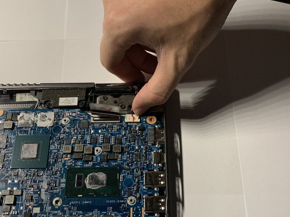

    • Peel back the tape covering the port.

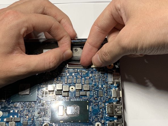

  30. Acer Spin 5 SP515-51GN-807G Motherboard Replacement: crwdns2935265:030crwdnd2935265:01crwdnd2935265:03crwdne2935265:0 Acer Spin 5 SP515-51GN-807G Motherboard Replacement: crwdns2935265:030crwdnd2935265:02crwdnd2935265:03crwdne2935265:0 Acer Spin 5 SP515-51GN-807G Motherboard Replacement: crwdns2935265:030crwdnd2935265:03crwdnd2935265:03crwdne2935265:0
    • Place your fingernail underneath the black clamp that secures the cable to the ZIF connector.
    • Pull the cable away from the motherboard.

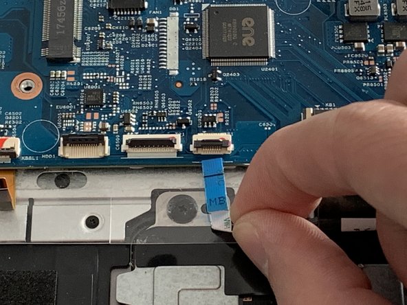

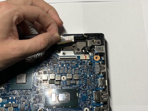

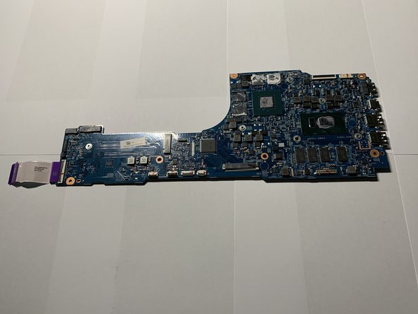

  31. Acer Spin 5 SP515-51GN-807G Motherboard Replacement: crwdns2935265:031crwdnd2935265:01crwdnd2935265:03crwdne2935265:0 Acer Spin 5 SP515-51GN-807G Motherboard Replacement: crwdns2935265:031crwdnd2935265:02crwdnd2935265:03crwdne2935265:0 Acer Spin 5 SP515-51GN-807G Motherboard Replacement: crwdns2935265:031crwdnd2935265:03crwdnd2935265:03crwdne2935265:0
    • Grip the cable on either side with your fingertips and gently pull away from the port.
    • If needed, use the plastic opening tool to remove the cord from its port.

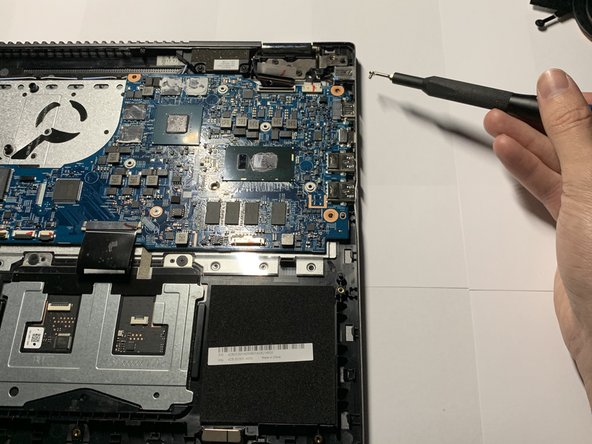

  32. Acer Spin 5 SP515-51GN-807G Motherboard Replacement: crwdns2935265:032crwdnd2935265:01crwdnd2935265:03crwdne2935265:0 Acer Spin 5 SP515-51GN-807G Motherboard Replacement: crwdns2935265:032crwdnd2935265:02crwdnd2935265:03crwdne2935265:0 Acer Spin 5 SP515-51GN-807G Motherboard Replacement: crwdns2935265:032crwdnd2935265:03crwdnd2935265:03crwdne2935265:0
    • Remove the six 3.5mm screws that secure the motherboard to the laptop using a Phillips #00 screwdriver (PH00 bit).
  33. Acer Spin 5 SP515-51GN-807G Motherboard Replacement: crwdns2935265:033crwdnd2935265:01crwdnd2935265:02crwdne2935265:0 Acer Spin 5 SP515-51GN-807G Motherboard Replacement: crwdns2935265:033crwdnd2935265:02crwdnd2935265:02crwdne2935265:0
    • Remove the motherboard from the laptop.
