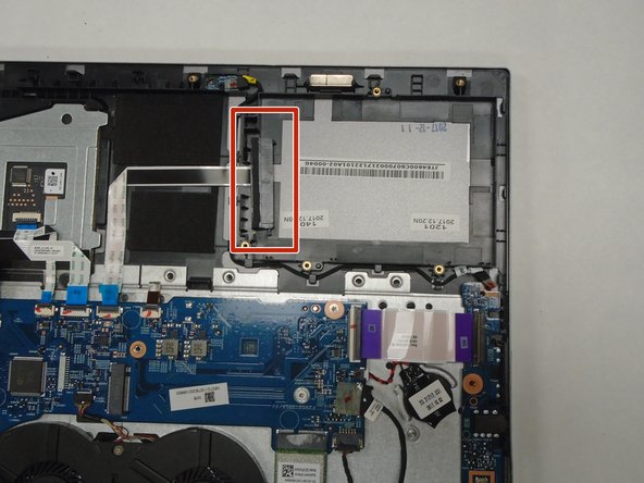

  9. Acer Spin 5 SP515-51GN-807G Hard Drive Replacement, Hard Drive: crwdns2935265:09crwdnd2935265:01crwdnd2935265:02crwdne2935265:0 Acer Spin 5 SP515-51GN-807G Hard Drive Replacement, Hard Drive: crwdns2935265:09crwdnd2935265:02crwdnd2935265:02crwdne2935265:0
    • Use a Phillips #1 screwdriver to remove the three 3.8 mm screws from the hard drive brackets.
    • Unplug the hard drive cable.
    • Lift the hard drive out from the device.
