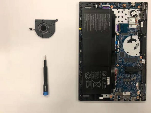

    • Use the Phillips #1 screwdriver to remove six 6 mm screws.
    • Use the same screwdriver to remove six 5mm screws.
  2. Acer Spin 5 N17W2 Motherboard Replacement: crwdns2935265:02crwdnd2935265:01crwdnd2935265:01crwdne2935265:0
    • Use an opening tool to pry the back cover open.
  3. Acer Spin 5 N17W2 Motherboard Replacement: crwdns2935265:03crwdnd2935265:01crwdnd2935265:01crwdne2935265:0
    • Remove two 5 mm screws by using the Phillips #1 screwdriver.
  4. Acer Spin 5 N17W2 Motherboard Replacement: crwdns2935265:04crwdnd2935265:01crwdnd2935265:02crwdne2935265:0 Acer Spin 5 N17W2 Motherboard Replacement: crwdns2935265:04crwdnd2935265:02crwdnd2935265:02crwdne2935265:0
    • Use two opening tools to disconnect the cooling fan from the motherboard.
    • Remove the fan from the device.
  5. Acer Spin 5 N17W2 Motherboard Replacement, Motherboard: crwdns2935265:05crwdnd2935265:01crwdnd2935265:01crwdne2935265:0
    • Remove four 5 mm screws using the Phillips #1 screwdriver.
  6. Acer Spin 5 N17W2 Motherboard Replacement: crwdns2935265:06crwdnd2935265:01crwdnd2935265:01crwdne2935265:0
    • Take off the black heat sink (be careful of the grey thermal grease).
  7. Acer Spin 5 N17W2 Motherboard Replacement: crwdns2935265:07crwdnd2935265:01crwdnd2935265:03crwdne2935265:0 Acer Spin 5 N17W2 Motherboard Replacement: crwdns2935265:07crwdnd2935265:02crwdnd2935265:03crwdne2935265:0 Acer Spin 5 N17W2 Motherboard Replacement: crwdns2935265:07crwdnd2935265:03crwdnd2935265:03crwdne2935265:0
    • Remove all peripherals connecting to the motherboard.
    • Remove the second chip.
    • Remove the wireless LAN chip.
  8. Acer Spin 5 N17W2 Motherboard Replacement: crwdns2935265:08crwdnd2935265:01crwdnd2935265:01crwdne2935265:0
    • Disconnect the three connection wires.
  9. Acer Spin 5 N17W2 Motherboard Replacement: crwdns2935265:09crwdnd2935265:01crwdnd2935265:02crwdne2935265:0 Acer Spin 5 N17W2 Motherboard Replacement: crwdns2935265:09crwdnd2935265:02crwdnd2935265:02crwdne2935265:0
    • Take off the connecting port with black tape.
    • Take off the last port with purple tape.
  10. Acer Spin 5 N17W2 Motherboard Replacement: crwdns2935265:010crwdnd2935265:01crwdnd2935265:01crwdne2935265:0
    • Remove the motherboard from the device.
