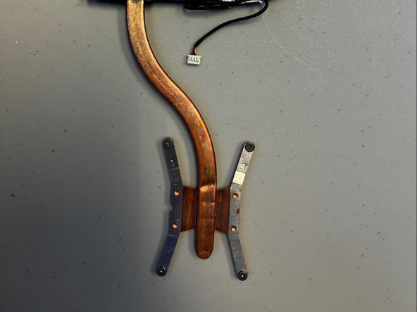

  14. Acer Spin 3 SP315-51-757C Trackpad Replacement, Heat Sink and Fan: crwdns2935265:014crwdnd2935265:01crwdnd2935265:01crwdne2935265:0
    • Using a Phillips #0 screwdriver, remove the three screws that hold the fan on top of the motherboard.
  15. Acer Spin 3 SP315-51-757C Trackpad Replacement: crwdns2935265:015crwdnd2935265:01crwdnd2935265:01crwdne2935265:0
    • Using a Phillips #0 screwdriver, remove the four screws that connect the heat sink to the motherboard.
  16. Acer Spin 3 SP315-51-757C Trackpad Replacement: crwdns2935265:016crwdnd2935265:01crwdnd2935265:02crwdne2935265:0 Acer Spin 3 SP315-51-757C Trackpad Replacement: crwdns2935265:016crwdnd2935265:02crwdnd2935265:02crwdne2935265:0
    • Remove both the fan and the heat sink with your hands.
