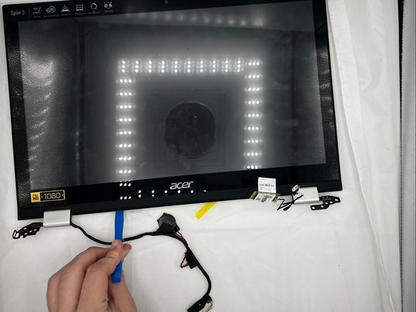

  14. Acer Spin 3 SP315-51-757C Screen Replacement, Screen: crwdns2935265:014crwdnd2935265:01crwdnd2935265:01crwdne2935265:0
    • Remove the screws from the "L" and "R" plastic pieces using a Phillips #0 screwdriver.
  15. Acer Spin 3 SP315-51-757C Screen Replacement: crwdns2935265:015crwdnd2935265:01crwdnd2935265:01crwdne2935265:0
    • Remove four screws from the metal hinges in the corners using a Phillips #0 screwdriver.
  16. Acer Spin 3 SP315-51-757C Screen Replacement: crwdns2935265:016crwdnd2935265:01crwdnd2935265:02crwdne2935265:0 Acer Spin 3 SP315-51-757C Screen Replacement: crwdns2935265:016crwdnd2935265:02crwdnd2935265:02crwdne2935265:0
    • Using an opening tool, separate the bezel from the rest of the device.
  17. Acer Spin 3 SP315-51-757C Screen Replacement: crwdns2935265:017crwdnd2935265:01crwdnd2935265:01crwdne2935265:0
    • Remove the Phillips #0 screws attaching the screen to the display assembly.
  18. Acer Spin 3 SP315-51-757C Screen Replacement: crwdns2935265:018crwdnd2935265:01crwdnd2935265:01crwdne2935265:0
    • Using your hands, remove the screen.
