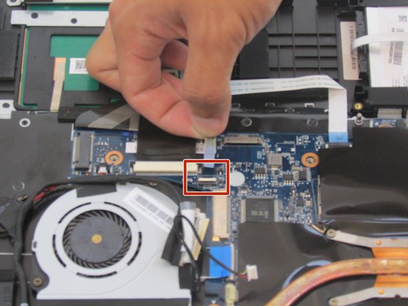

  9. Acer Spin 3 SP315-51-757C Motherboard Replacement, Motherboard: crwdns2935265:09crwdnd2935265:01crwdnd2935265:02crwdne2935265:0 Acer Spin 3 SP315-51-757C Motherboard Replacement, Motherboard: crwdns2935265:09crwdnd2935265:02crwdnd2935265:02crwdne2935265:0
    • Lift the three black tabs to release the cable connectors.
    • After the tabs are lifted, the white cables with blue ends can be pulled out of their slots.

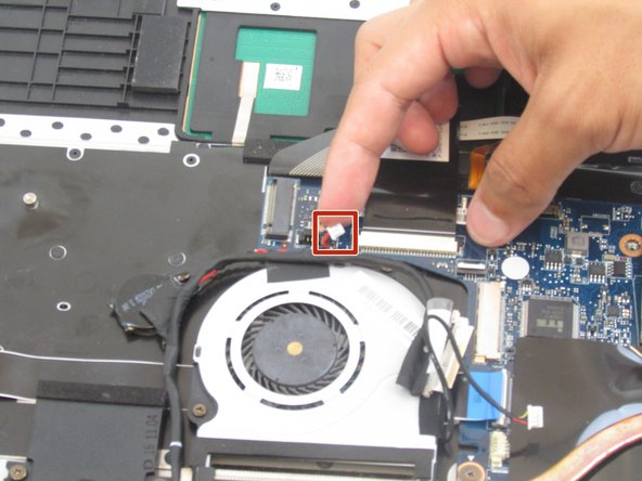

  10. Acer Spin 3 SP315-51-757C Motherboard Replacement: crwdns2935265:010crwdnd2935265:01crwdnd2935265:03crwdne2935265:0 Acer Spin 3 SP315-51-757C Motherboard Replacement: crwdns2935265:010crwdnd2935265:02crwdnd2935265:03crwdne2935265:0 Acer Spin 3 SP315-51-757C Motherboard Replacement: crwdns2935265:010crwdnd2935265:03crwdnd2935265:03crwdne2935265:0
    • Remove the cables near the fan by pulling them carefully out of their slots.

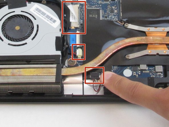

  11. Acer Spin 3 SP315-51-757C Motherboard Replacement: crwdns2935265:011crwdnd2935265:01crwdnd2935265:03crwdne2935265:0 Acer Spin 3 SP315-51-757C Motherboard Replacement: crwdns2935265:011crwdnd2935265:02crwdnd2935265:03crwdne2935265:0 Acer Spin 3 SP315-51-757C Motherboard Replacement: crwdns2935265:011crwdnd2935265:03crwdnd2935265:03crwdne2935265:0
    • Remove the single Phillips #0 screw.
    • Unplug the speaker cable.
    • Unplug the secondary speaker cable.

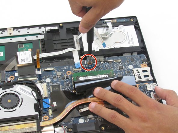

  12. Acer Spin 3 SP315-51-757C Motherboard Replacement: crwdns2935265:012crwdnd2935265:01crwdnd2935265:03crwdne2935265:0 Acer Spin 3 SP315-51-757C Motherboard Replacement: crwdns2935265:012crwdnd2935265:02crwdnd2935265:03crwdne2935265:0 Acer Spin 3 SP315-51-757C Motherboard Replacement: crwdns2935265:012crwdnd2935265:03crwdnd2935265:03crwdne2935265:0

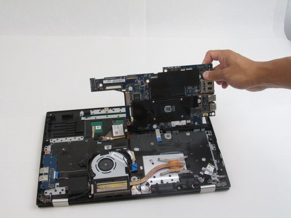

    • Remove the three Phillips #0 screws attached to the motherboard.
  13. Acer Spin 3 SP315-51-757C Motherboard Replacement: crwdns2935265:013crwdnd2935265:01crwdnd2935265:02crwdne2935265:0 Acer Spin 3 SP315-51-757C Motherboard Replacement: crwdns2935265:013crwdnd2935265:02crwdnd2935265:02crwdne2935265:0
    • Use a Phillips #0 screwdriver to remove four screws from the heat sink.
    • Carefully slide the motherboard from under the heat sink (it is easiest to slide the motherboard to the right).
