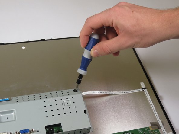

    • Unscrew the four 7.5 mm Phillips #2 screws connecting the motherboard to the metal casing.
    • Be sure to keep track of where you place your screws. A magnetic mat is great for keeping your screws in one spot.

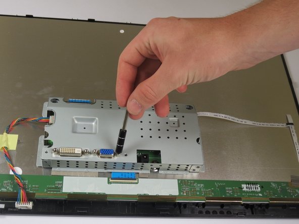

    • Remove the four 10 mm Hex screws.
