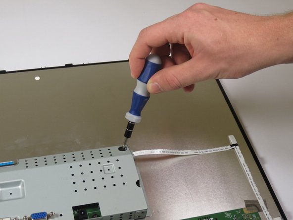

    • Remove the four 10 mm hex screws.

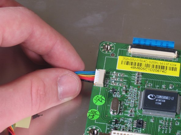

    • Pull the bundled cable connector gently away from motherboard.
  8. Acer S200HL LCD Monitor Bundled Cable Connector Replacement: crwdns2935265:08crwdnd2935265:01crwdnd2935265:01crwdne2935265:0
    • Grasp the other side of the bundled cable connector and gently pull the connector away from the screen.
