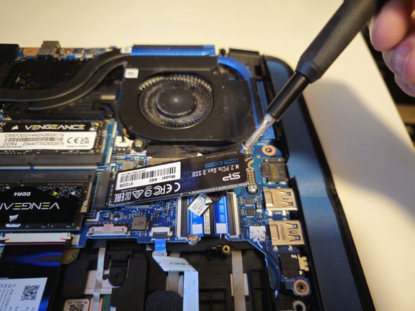

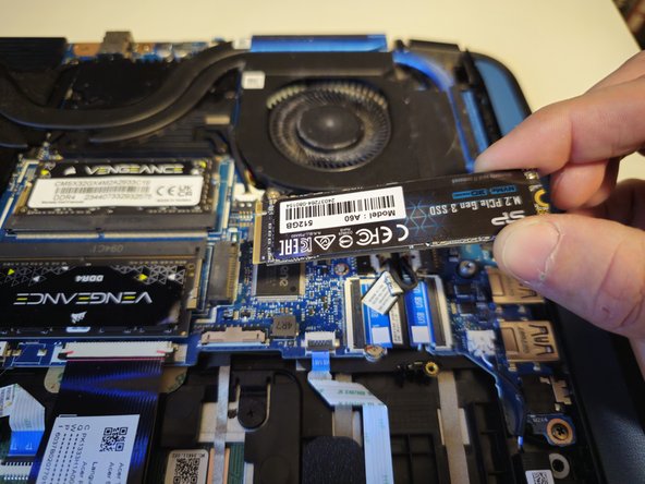

  9. Acer Predator Helios 300 PH315-53 PCIe Solid State Drive (SSD) Replacement, PCIe Solid State Drive (SSD): crwdns2935265:09crwdnd2935265:01crwdnd2935265:03crwdne2935265:0 Acer Predator Helios 300 PH315-53 PCIe Solid State Drive (SSD) Replacement, PCIe Solid State Drive (SSD): crwdns2935265:09crwdnd2935265:02crwdnd2935265:03crwdne2935265:0 Acer Predator Helios 300 PH315-53 PCIe Solid State Drive (SSD) Replacement, PCIe Solid State Drive (SSD): crwdns2935265:09crwdnd2935265:03crwdnd2935265:03crwdne2935265:0
    • Unscrew the retaining screw that secures the SSD to the motherboard with a Phillips #0 screwdriver.
    • Ensure you are wearing a properly grounded ESD wristband before handling your SSD.
    • Gently pull your SSD out of the motherboard's PCIe slot.
    • Store your SSD on your properly grounded ESD mat while it is outside of your laptop.

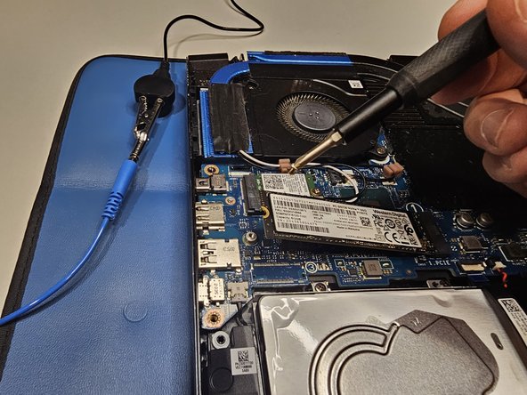

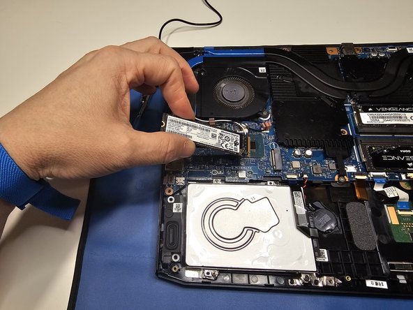

  10. Acer Predator Helios 300 PH315-53 PCIe Solid State Drive (SSD) Replacement: crwdns2935265:010crwdnd2935265:01crwdnd2935265:03crwdne2935265:0 Acer Predator Helios 300 PH315-53 PCIe Solid State Drive (SSD) Replacement: crwdns2935265:010crwdnd2935265:02crwdnd2935265:03crwdne2935265:0 Acer Predator Helios 300 PH315-53 PCIe Solid State Drive (SSD) Replacement: crwdns2935265:010crwdnd2935265:03crwdnd2935265:03crwdne2935265:0
    • Repeat the actions you performed in the previous step to remove the SSD that is on the other side of your motherboard.
    • This slot will be empty if you have not previously upgraded your storage with an additional SSD.
