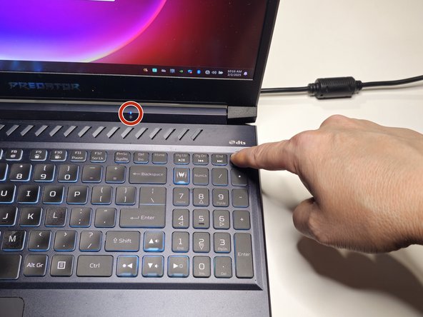

  1. Acer Predator Helios 300 PH315-53 Bottom Case Replacement, Bottom Case: crwdns2935265:01crwdnd2935265:01crwdnd2935265:03crwdne2935265:0 Acer Predator Helios 300 PH315-53 Bottom Case Replacement, Bottom Case: crwdns2935265:01crwdnd2935265:02crwdnd2935265:03crwdne2935265:0 Acer Predator Helios 300 PH315-53 Bottom Case Replacement, Bottom Case: crwdns2935265:01crwdnd2935265:03crwdnd2935265:03crwdne2935265:0
    • Turn off the laptop by holding down the power button for 7 seconds.
    • Verify that the blue power indicator light is turned off.

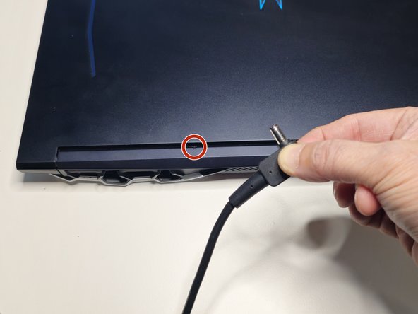

  2. Acer Predator Helios 300 PH315-53 Bottom Case Replacement: crwdns2935265:02crwdnd2935265:01crwdnd2935265:02crwdne2935265:0 Acer Predator Helios 300 PH315-53 Bottom Case Replacement: crwdns2935265:02crwdnd2935265:02crwdnd2935265:02crwdne2935265:0
    • Remove the plug from the back of your laptop.
    • Verify that the charging light is off after you remove the plug.
    • The battery’s charging light turns “amber” when plugged into the power cord and charging. The indicator light switches to blue once the battery is fully charged.

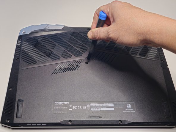

  3. Acer Predator Helios 300 PH315-53 Bottom Case Replacement: crwdns2935265:03crwdnd2935265:01crwdnd2935265:03crwdne2935265:0 Acer Predator Helios 300 PH315-53 Bottom Case Replacement: crwdns2935265:03crwdnd2935265:02crwdnd2935265:03crwdne2935265:0 Acer Predator Helios 300 PH315-53 Bottom Case Replacement: crwdns2935265:03crwdnd2935265:03crwdnd2935265:03crwdne2935265:0

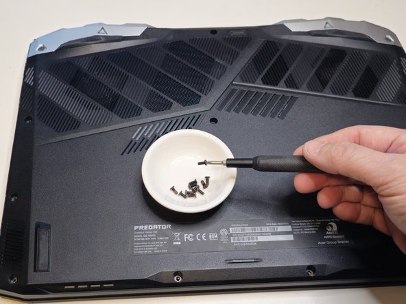

    • Remove the eleven screws from the bottom case with a Phillips #1 Screwdriver.

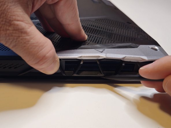

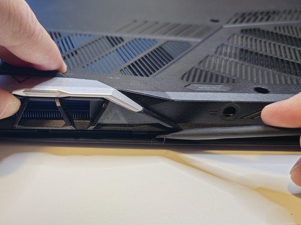

    Spudger
    $3.99
    • A spudger is a tool that can help separate electronic panels without scratching or damaging your device.
    • Use your thumb to apply gentle upward pressure on the laptop vent while using a spudger to separate the bottom case from the top case.
    • Work the spudger along the seam where the bottom case meets the top case.
    • Apply gentle upward pressure on the opposite laptop vent as you work the spudger across the back of the laptop.

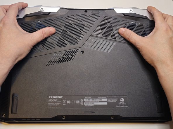

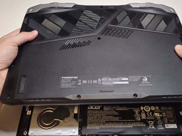

    • Turn the laptop so the laptop vents are facing away from you and the bottom case remains face up.
    • Use your fingertips to pull gently upward on the vents while using your palms to apply gentle downward pressure on the bottom case.
    • Move your hands outward from the center of the laptop to each side, continuing to pull the bottom case gently upward with your fingertips.
    • Lift the bottom case away from the laptop.
