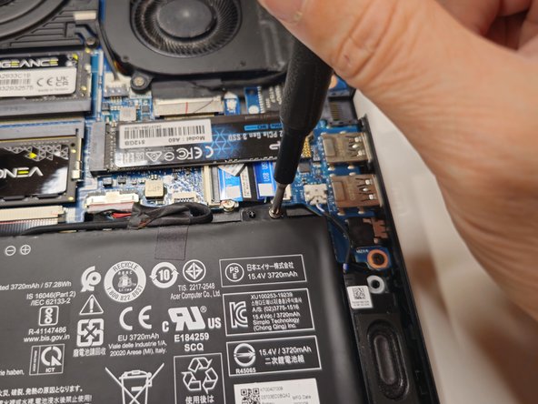

    • Always consider protecting against electrostatic discharge (ESD) when working on the components inside your laptop.
    • A properly grounded ESD mat and wristband can protect your laptop from ESD damage.

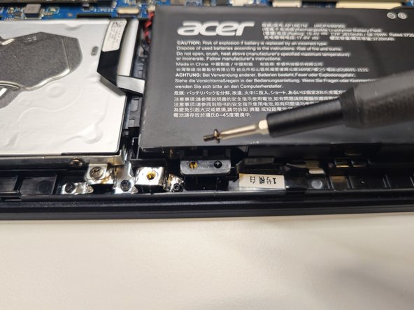

    • Remove the two screws securing the battery to the top case with a Phillips #0 Screwdriver.

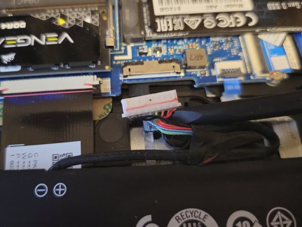

    • Lift the battery up and away from the motherboard to expose its connection wire.
  8. Acer Predator Helios 300 PH315-53 Battery Replacement: crwdns2935265:08crwdnd2935265:01crwdnd2935265:03crwdne2935265:0 Acer Predator Helios 300 PH315-53 Battery Replacement: crwdns2935265:08crwdnd2935265:02crwdnd2935265:03crwdne2935265:0 Acer Predator Helios 300 PH315-53 Battery Replacement: crwdns2935265:08crwdnd2935265:03crwdnd2935265:03crwdne2935265:0

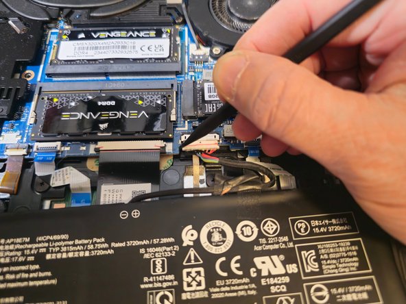

    • Gently remove the connection wire from the motherboard using a spudger.
    • Remove the cable only a little at a time from each side, as shown in the photos. This avoids damaging the connections.
    • Lift the disconnected battery out of the laptop.
