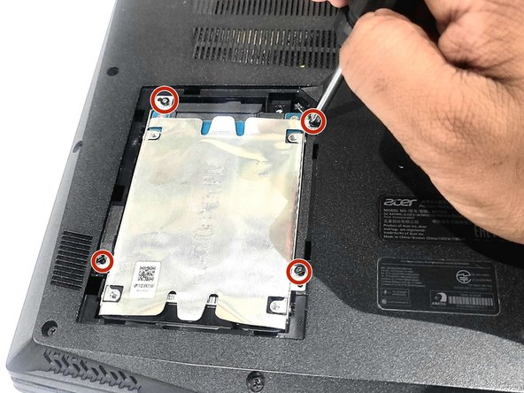

    • Remove all the screws from the back panel with a Phillips #0 screwdriver.
    • Remove the hard drive screw using a Phillips #0 screwdriver.
    • Use the panel tool to pop the storage hard disk open.

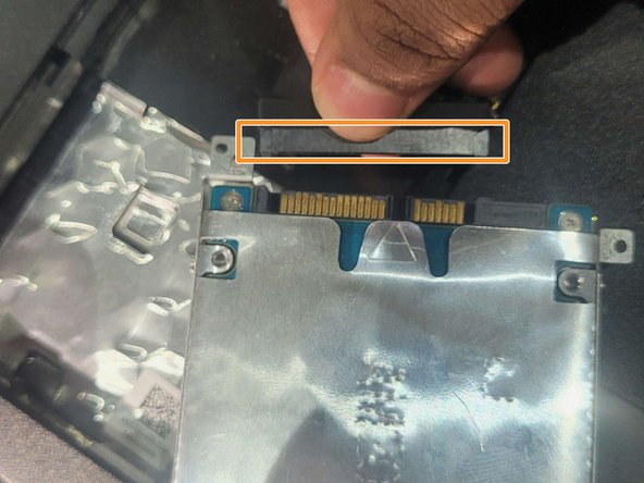

    • Remove the four screws mounted near the storage hard disk using a Phillips #0 screwdriver.
    • Disconnect the cable connected to the storage hard disk.

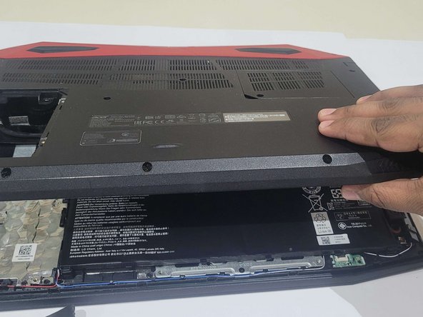

    • Use the panel tool to remove the back cover.
    • Slowly open the clips attached to the back cover, and store the cover safely.

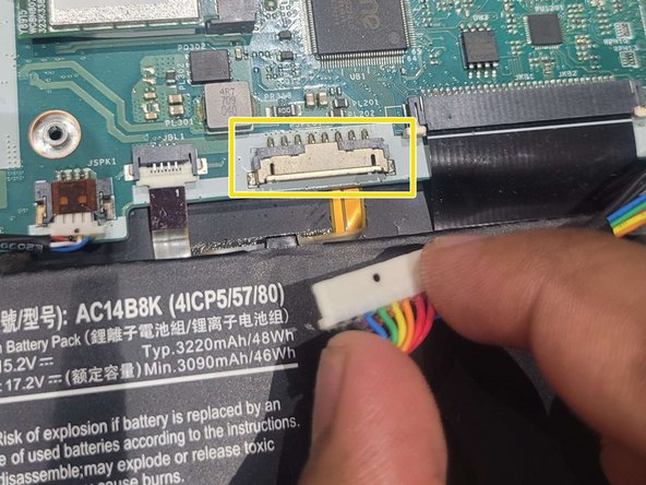

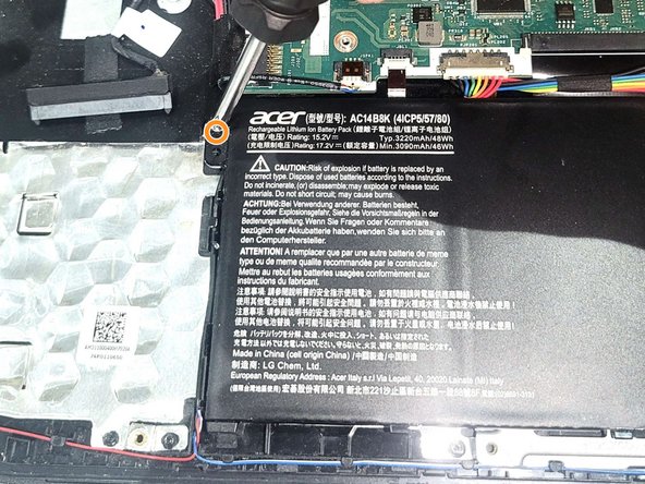

    • Remove the tape holding the battery wires in.
    • Remove the two screws mounted next to the battery using a Phillips #0 screwdriver.
    • Disconnect the battery cable from the motherboard slowly.
    • Remove the old battery.

    • Connect the new battery connector to the motherboard and screw it back with the screwdriver.

    • Align the back cover with the laptop properly and click it with all the clips.

    • Insert the storage disk back in.
    • Connect it with the cable first and then fit it inside the missing space.
