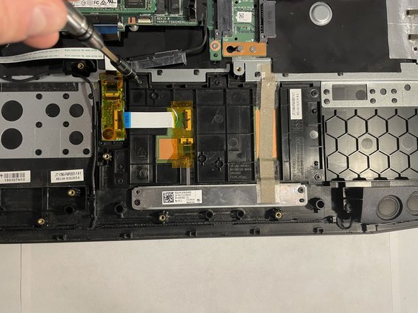

    • Remove the seven 4 mm Phillips #0 screws.
  12. Acer Predator 17 G9-791 Trackpad Replacement: crwdns2935265:012crwdnd2935265:01crwdnd2935265:02crwdne2935265:0 Acer Predator 17 G9-791 Trackpad Replacement: crwdns2935265:012crwdnd2935265:02crwdnd2935265:02crwdne2935265:0

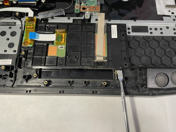

    • Remove the connector by flipping the black lock bar up and removing the pulling it out.
    • Peel back the tape from the metal button assembly on the bottom and the tape connecting the trackpad to the device at the top.

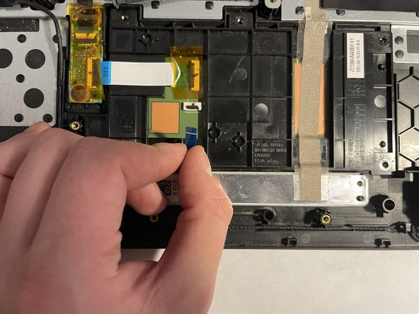

  14. Acer Predator 17 G9-791 Trackpad Replacement: crwdns2935265:014crwdnd2935265:01crwdnd2935265:01crwdne2935265:0
    • Flip the black lock bar up and remove the connector on the left.

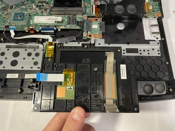

  15. Acer Predator 17 G9-791 Trackpad Replacement: crwdns2935265:015crwdnd2935265:01crwdnd2935265:03crwdne2935265:0 Acer Predator 17 G9-791 Trackpad Replacement: crwdns2935265:015crwdnd2935265:02crwdnd2935265:03crwdne2935265:0 Acer Predator 17 G9-791 Trackpad Replacement: crwdns2935265:015crwdnd2935265:03crwdnd2935265:03crwdne2935265:0
    • Using a spudger, pry the trackpad up and remove it from the device.
    • There is an adhesive holding the trackpad down that must be pulled against.
