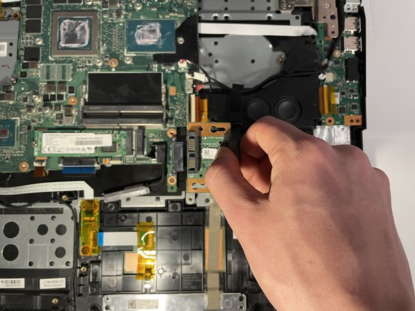

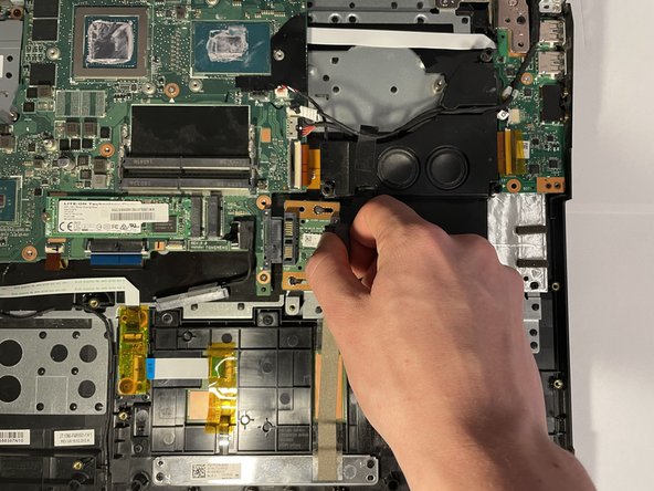

  16. Acer Predator 17 G9-791 Motherboard Replacement, Motherboard: crwdns2935265:016crwdnd2935265:01crwdnd2935265:01crwdne2935265:0
    • Remove the two 5 mm Phillips #0 screws from the small PCB.
  17. Acer Predator 17 G9-791 Motherboard Replacement: crwdns2935265:017crwdnd2935265:01crwdnd2935265:03crwdne2935265:0 Acer Predator 17 G9-791 Motherboard Replacement: crwdns2935265:017crwdnd2935265:02crwdnd2935265:03crwdne2935265:0 Acer Predator 17 G9-791 Motherboard Replacement: crwdns2935265:017crwdnd2935265:03crwdnd2935265:03crwdne2935265:0
    • Pull the small PCB to the right and then up to remove it from the device.

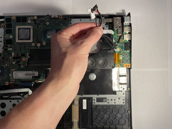

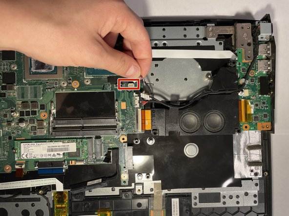

    • Pull up on the “woofer” wire to remove it from its connector.
  19. Acer Predator 17 G9-791 Motherboard Replacement: crwdns2935265:019crwdnd2935265:01crwdnd2935265:02crwdne2935265:0 Acer Predator 17 G9-791 Motherboard Replacement: crwdns2935265:019crwdnd2935265:02crwdnd2935265:02crwdne2935265:0
    • Remove the two connectors.
  20. Acer Predator 17 G9-791 Motherboard Replacement: crwdns2935265:020crwdnd2935265:01crwdnd2935265:02crwdne2935265:0 Acer Predator 17 G9-791 Motherboard Replacement: crwdns2935265:020crwdnd2935265:02crwdnd2935265:02crwdne2935265:0

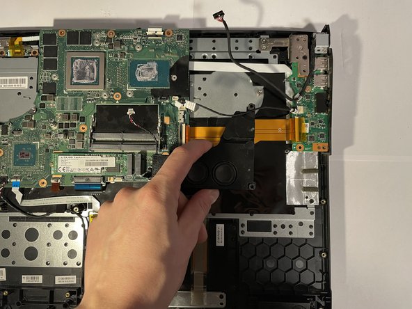

    • Separate the same two wires from the subwoofer.
  21. Acer Predator 17 G9-791 Motherboard Replacement: crwdns2935265:021crwdnd2935265:01crwdnd2935265:02crwdne2935265:0 Acer Predator 17 G9-791 Motherboard Replacement: crwdns2935265:021crwdnd2935265:02crwdnd2935265:02crwdne2935265:0
    • Pull the subwoofer up and out of the device.

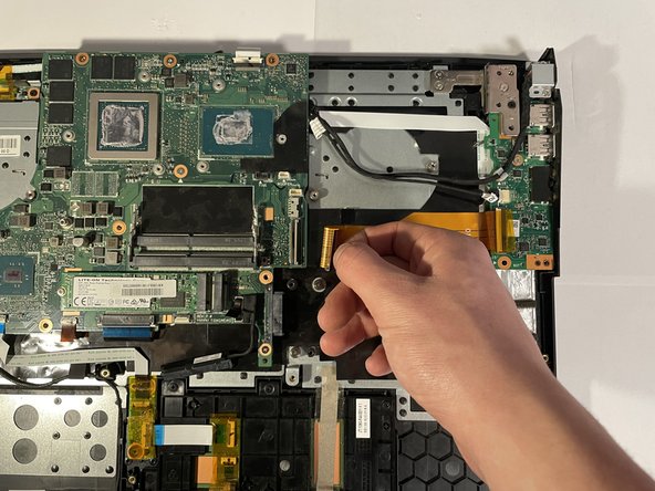

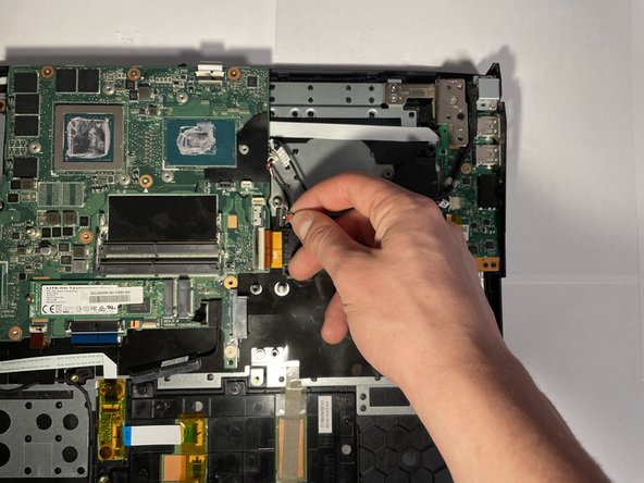

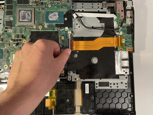

    • Remove the six connectors.
    • Some require you to flip the white part of the connector up first to remove them.

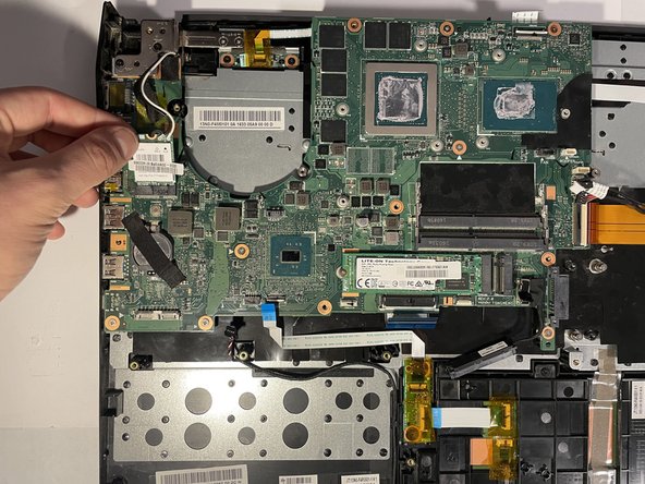

  23. Acer Predator 17 G9-791 Motherboard Replacement: crwdns2935265:023crwdnd2935265:01crwdnd2935265:03crwdne2935265:0 Acer Predator 17 G9-791 Motherboard Replacement: crwdns2935265:023crwdnd2935265:02crwdnd2935265:03crwdne2935265:0 Acer Predator 17 G9-791 Motherboard Replacement: crwdns2935265:023crwdnd2935265:03crwdnd2935265:03crwdne2935265:0

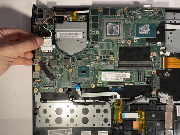

    • Remove one 4.5 mm Phillips #0 screw from the WLAN card and pull the card out.

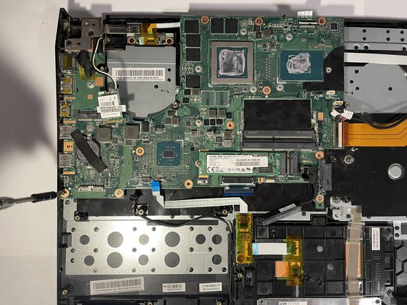

    • Remove six 5 mm Phillips #0 screws from the motherboard.

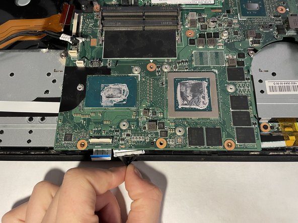

    • Turn the device around.
    • Use the black tab to disconnect the one connector on the bottom of the motherboard.
    • When reinstalling you should plug this connector back in as you set the motherboard down.

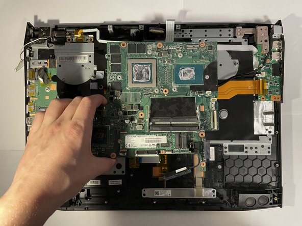

  28. Acer Predator 17 G9-791 Motherboard Replacement: crwdns2935265:028crwdnd2935265:01crwdnd2935265:02crwdne2935265:0 Acer Predator 17 G9-791 Motherboard Replacement: crwdns2935265:028crwdnd2935265:02crwdnd2935265:02crwdne2935265:0
    • Pull the motherboard up and out of the device. You may need to open the lid slightly for the removal process.
    • When reinstalling the motherboard, ensure that wires do not get stuck under the motherboard as you set it back down.
