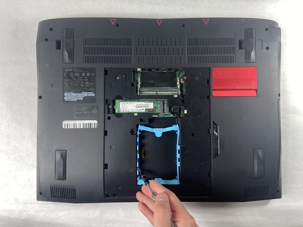

    • The service panel can be located on the bottom of the device. It is shown here as the panel located in the middle of the device, going from the upper vents to the bottom of the device.
  2. Acer Predator 17 G9-791 Display Replacement: crwdns2935265:02crwdnd2935265:01crwdnd2935265:02crwdne2935265:0 Acer Predator 17 G9-791 Display Replacement: crwdns2935265:02crwdnd2935265:02crwdnd2935265:02crwdne2935265:0
    • Loosen the two Phillips #0 screws.
    • Pull up slightly on the top of the panel to help fully separate the screws from the rest of the device.
  3. Acer Predator 17 G9-791 Display Replacement: crwdns2935265:03crwdnd2935265:01crwdnd2935265:01crwdne2935265:0
    • Continue pulling up on the panel to separate it from the laptop and remove it.

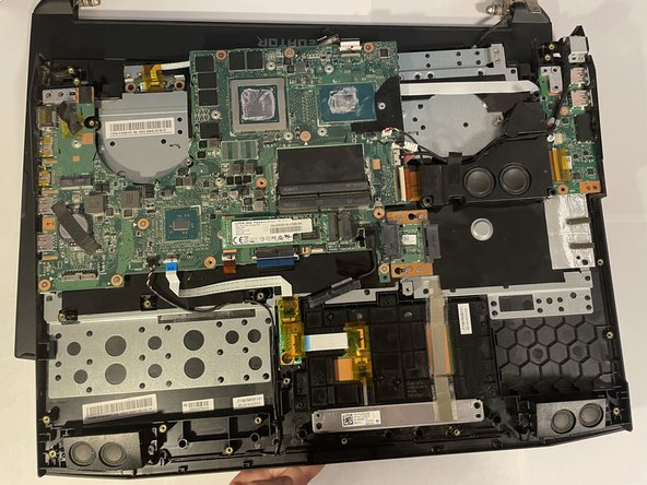

  8. Acer Predator 17 G9-791 Display Replacement, Battery: crwdns2935265:08crwdnd2935265:01crwdnd2935265:01crwdne2935265:0
    • Remove the six 4 mm Phillips #0 screws from the battery.
  9. Acer Predator 17 G9-791 Display Replacement: crwdns2935265:09crwdnd2935265:01crwdnd2935265:02crwdne2935265:0 Acer Predator 17 G9-791 Display Replacement: crwdns2935265:09crwdnd2935265:02crwdnd2935265:02crwdne2935265:0
    • Disconnect the battery connector from the motherboard.
  10. Acer Predator 17 G9-791 Display Replacement: crwdns2935265:010crwdnd2935265:01crwdnd2935265:01crwdne2935265:0
    • Gently lift the battery and remove it from the device.

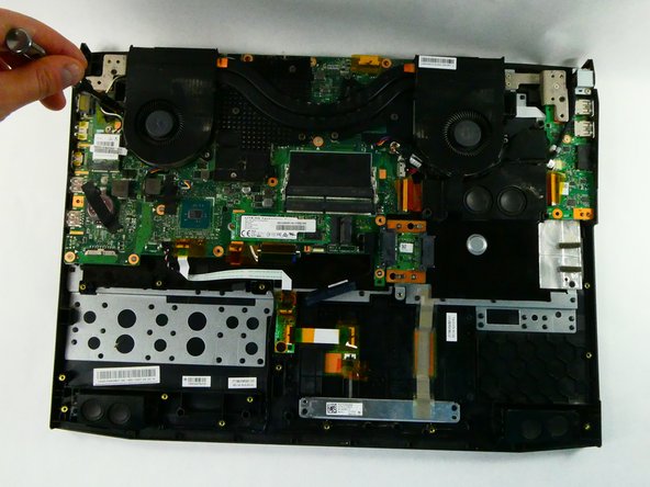

  11. Acer Predator 17 G9-791 Display Replacement, Fan Assembly: crwdns2935265:011crwdnd2935265:01crwdnd2935265:02crwdne2935265:0 Acer Predator 17 G9-791 Display Replacement, Fan Assembly: crwdns2935265:011crwdnd2935265:02crwdnd2935265:02crwdne2935265:0
    • Remove the five 4.5 mm Phillips #0 screws located on the perimeter of the fans.
  12. Acer Predator 17 G9-791 Display Replacement: crwdns2935265:012crwdnd2935265:01crwdnd2935265:02crwdne2935265:0 Acer Predator 17 G9-791 Display Replacement: crwdns2935265:012crwdnd2935265:02crwdnd2935265:02crwdne2935265:0

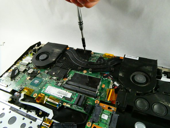

    • Unscrew the six Phillips #0 screws enough to loosen the assembly from the motherboard.
  13. Acer Predator 17 G9-791 Display Replacement: crwdns2935265:013crwdnd2935265:01crwdnd2935265:03crwdne2935265:0 Acer Predator 17 G9-791 Display Replacement: crwdns2935265:013crwdnd2935265:02crwdnd2935265:03crwdne2935265:0 Acer Predator 17 G9-791 Display Replacement: crwdns2935265:013crwdnd2935265:03crwdnd2935265:03crwdne2935265:0
    • Detach the left fan's cord from the motherboard.
  14. Acer Predator 17 G9-791 Display Replacement: crwdns2935265:014crwdnd2935265:01crwdnd2935265:03crwdne2935265:0 Acer Predator 17 G9-791 Display Replacement: crwdns2935265:014crwdnd2935265:02crwdnd2935265:03crwdne2935265:0 Acer Predator 17 G9-791 Display Replacement: crwdns2935265:014crwdnd2935265:03crwdnd2935265:03crwdne2935265:0
    • Detach the right fan's cord from the motherboard.
  15. Acer Predator 17 G9-791 Display Replacement: crwdns2935265:015crwdnd2935265:01crwdnd2935265:03crwdne2935265:0 Acer Predator 17 G9-791 Display Replacement: crwdns2935265:015crwdnd2935265:02crwdnd2935265:03crwdne2935265:0 Acer Predator 17 G9-791 Display Replacement: crwdns2935265:015crwdnd2935265:03crwdnd2935265:03crwdne2935265:0
    • Lift the fan assembly up and out.

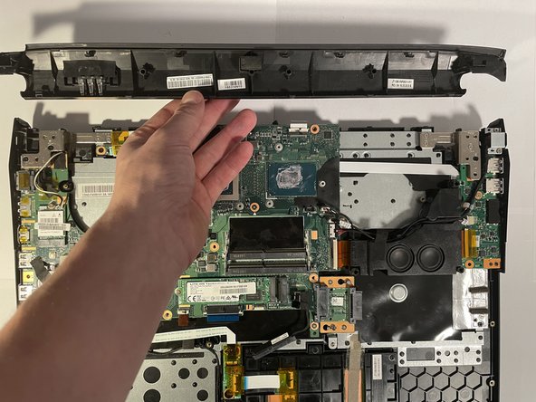

  16. Acer Predator 17 G9-791 Display Replacement, Display: crwdns2935265:016crwdnd2935265:01crwdnd2935265:03crwdne2935265:0 Acer Predator 17 G9-791 Display Replacement, Display: crwdns2935265:016crwdnd2935265:02crwdnd2935265:03crwdne2935265:0 Acer Predator 17 G9-791 Display Replacement, Display: crwdns2935265:016crwdnd2935265:03crwdnd2935265:03crwdne2935265:0
    • Push down on the back of the device to unclip this panel, removing it by pulling it out the back of the device.

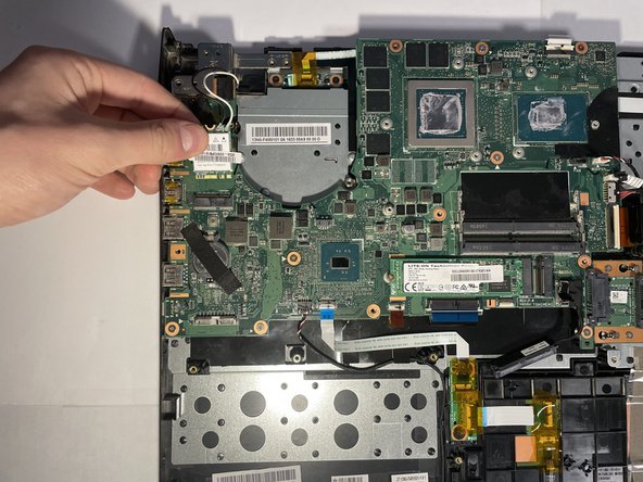

  19. Acer Predator 17 G9-791 Display Replacement: crwdns2935265:019crwdnd2935265:01crwdnd2935265:03crwdne2935265:0 Acer Predator 17 G9-791 Display Replacement: crwdns2935265:019crwdnd2935265:02crwdnd2935265:03crwdne2935265:0 Acer Predator 17 G9-791 Display Replacement: crwdns2935265:019crwdnd2935265:03crwdnd2935265:03crwdne2935265:0

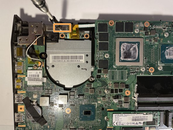

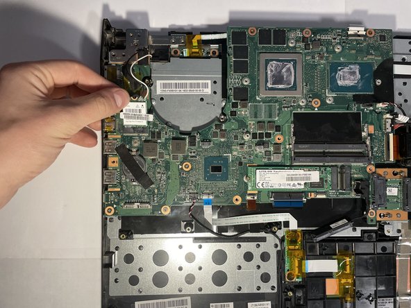

    • Remove one 4.5 mm Phillips #0 screw from the WLAN card.
    • Pull the WLAN card out.
  20. Acer Predator 17 G9-791 Display Replacement: crwdns2935265:020crwdnd2935265:01crwdnd2935265:02crwdne2935265:0 Acer Predator 17 G9-791 Display Replacement: crwdns2935265:020crwdnd2935265:02crwdnd2935265:02crwdne2935265:0

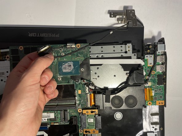

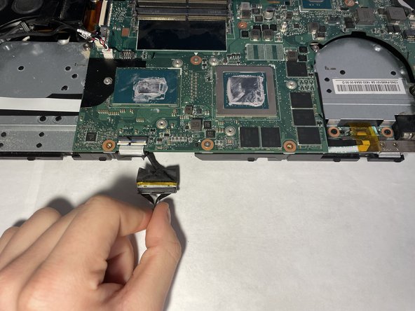

    • Turn the device around.
    • Pull the black tab to disconnect one wire from the bottom of the motherboard.

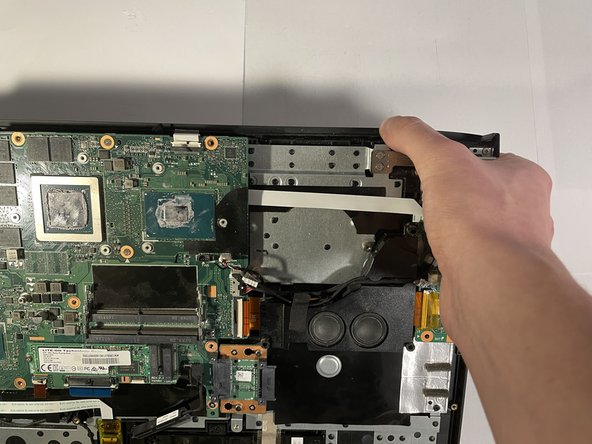

  21. Acer Predator 17 G9-791 Display Replacement: crwdns2935265:021crwdnd2935265:01crwdnd2935265:02crwdne2935265:0 Acer Predator 17 G9-791 Display Replacement: crwdns2935265:021crwdnd2935265:02crwdnd2935265:02crwdne2935265:0
    • Opening the cover slightly, pull the bottom half of the device towards you.
  22. Acer Predator 17 G9-791 Display Replacement: crwdns2935265:022crwdnd2935265:01crwdnd2935265:02crwdne2935265:0 Acer Predator 17 G9-791 Display Replacement: crwdns2935265:022crwdnd2935265:02crwdnd2935265:02crwdne2935265:0
    • Separate the wire that was unplugged two steps ago from the bottom of the device.
    • This wire runs in a track and pulling on it slightly will separate it from the bottom half of the device.
    • When reinstalling, ensure this wire in placed back in its track before attempting to put the new display on the device.
