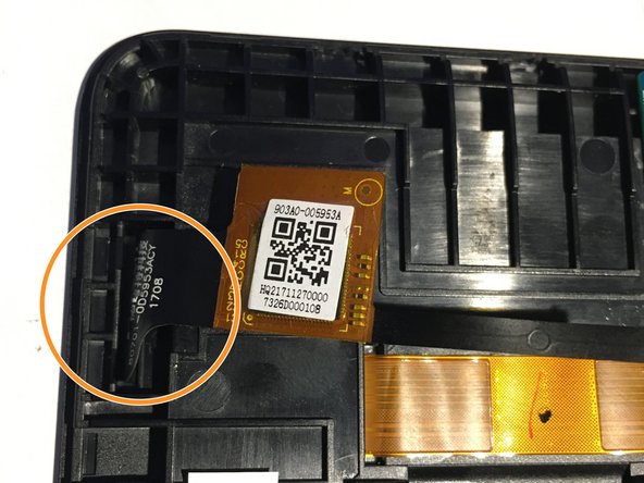

    • Power off the device and make sure it is disconnected from any external devices.
    • Use a plastic opening tool to create a gap between the front and back casing of the device.
    • Slowly maneuver the plastic tool around the entire perimeter of the tablet to separate the front and back.
  2. Acer One 10 S1003-19GY WiFi Antenna Replacement: crwdns2935265:02crwdnd2935265:01crwdnd2935265:01crwdne2935265:0
    • Set the device screen side down and remove the back casing.
  3. Acer One 10 S1003-19GY WiFi Antenna Replacement, WiFi Antenna: crwdns2935265:03crwdnd2935265:01crwdnd2935265:03crwdne2935265:0 Acer One 10 S1003-19GY WiFi Antenna Replacement, WiFi Antenna: crwdns2935265:03crwdnd2935265:02crwdnd2935265:03crwdne2935265:0 Acer One 10 S1003-19GY WiFi Antenna Replacement, WiFi Antenna: crwdns2935265:03crwdnd2935265:03crwdnd2935265:03crwdne2935265:0
    • Disconnect the black ribbon connection attached to the motherboard.
    • Remove the chip fully by pulling the plastic tab on the left out.
